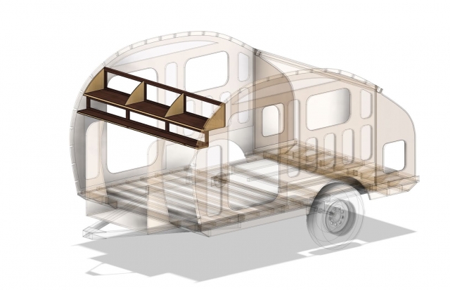

This is what the final design is supposed to look like (I'm also thinking of adding a custom tongue box, but the trailer is ending up a little front heavy, so I may need to give up that idea)

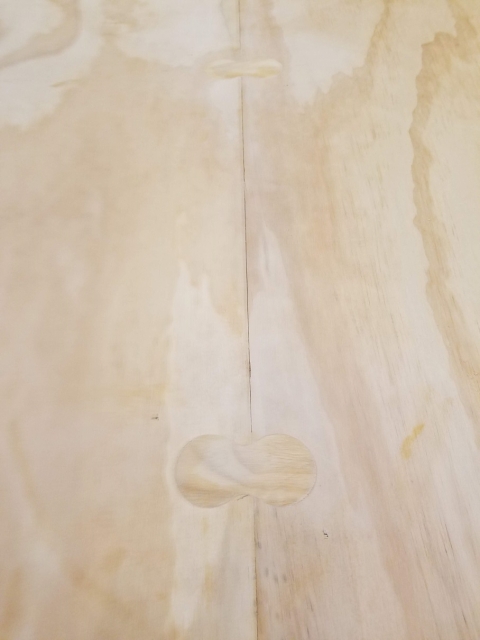

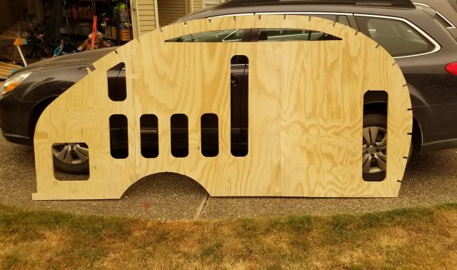

Due to the size, wall profiles ended up needing 3 separate sections of plywood. I started by joining 3 pieces of 3/4 ACX plywood using tongue and groove joint, but wasn't quite happy with how stiff that felt, so I added a few butterfly joints in a couple places

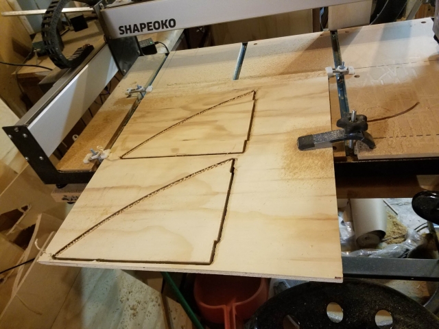

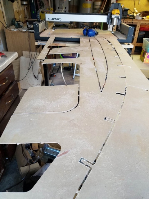

Since I don't trust myself to hold the jigsaw straight, I used a CNC to cut the wall template. This was done from a cheap 1/8 utility plywood I found at Home Depot. Ended up being a little thin for a template so I had to watch it pretty carefully to make sure the guide doesn't slip, but it ended up working fine.
My CNC is small, and can't cut pieces wider than 2ft, so I ended up cutting a few separate segments (front, top and back).
The template was stapled to the plywood and I cut the first wall, which was later used as a template to cut the next wall. I didn't cut the door and window openings right away, since I didn't have them ordered yet and I wanted to double check the exact size.

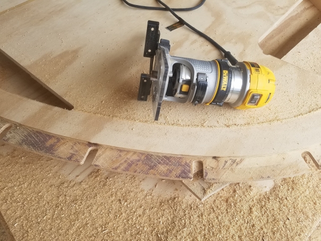

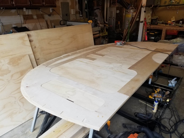

Finally, I created a top space to hold the headliner by running a number of overlapping passes with a flat router bit and an offset guide:
In the hindsight, I ended up removing way too little plywood, since I was worried about the walls not being stiff enough. Definitely an overkill, given the torsion box design of the walls, but I didn't at the time appreciate just how much stiffness will be added by the two outside skin layers of plywood.

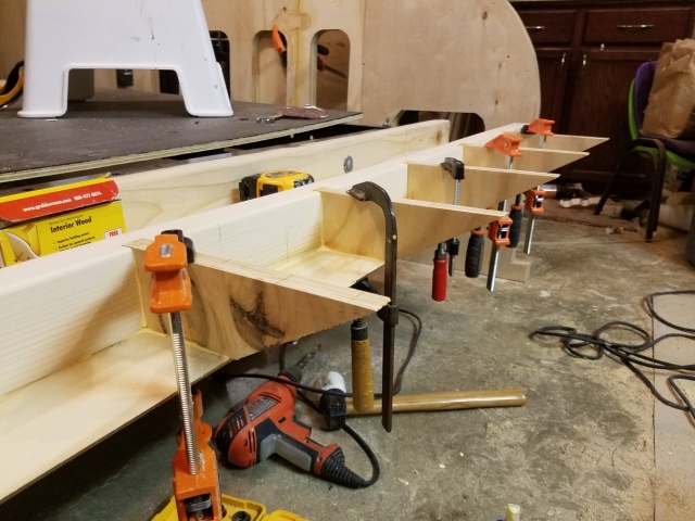

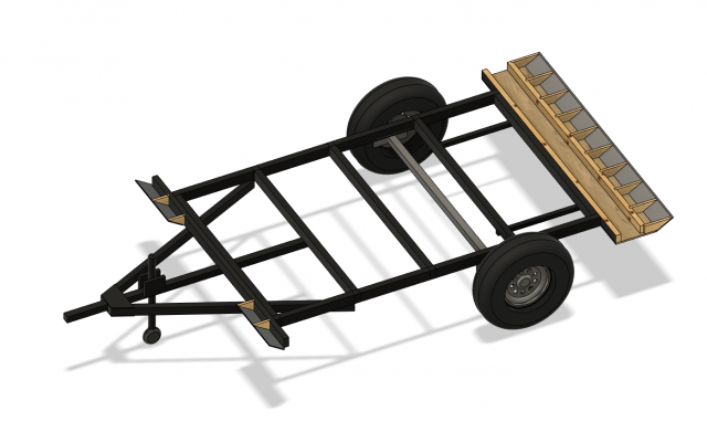

To support the length of the trailer, I added a set of supports in the back and front. I'm not quite sure if it's an overkill, but I figured since the trailer overhangs 18 inches to the back, I wanted it well supported. The whole thing is screwed to the metal frame and supported from the bottom on 3 1x1 metal tubes.
I did something similar on the front side, except it's only 6 inches long and has a cut out for what's supposed to be a tongue box.
Before attaching, the 2x4s facing the metal frame and the bottom plywood was covered with Henrys's roofing patch (what a mess by the way)
This picture from the design probably best explains what I did (it only shows 2 of the 3 tubes, the third one was added in the center):
And the picture of the back support under construction
This also helps with the side profile which I wanted to be built such that it hides the metal frame

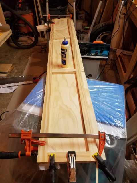

The floor was made from a sandwich of 1/2 ACX plywood, 1x5x1.5 joists and another layer 1/2 ACX plywood. This was so the overhang on the sides (and front and back) was well supported. The bottom layer of plywood was also extended by 3/4 on the sides to act as support for the walls.
I covered the bottom of each plywood section with Henry's roofing tar (again - what a mess, I should have listened) and assembled them using tongue and groove after flipping them over. The joints were then again covered from the bottom with the tar.
I had to drill a number of holes to match the screws on the trailer frame. These were painted with a primer and later I decided to fill the holes with epoxy (both for waterproofing and to hold the screw from the top in case I ever need to tighten them)
Finally, the insulation was cut and fitted in between the joists/frame and another layer of 1/2 plywood was glued on the top.

Next up, a set of front cabinets, which will provide much needed storage space, but also will help holding the walls together.
The top cabinets will have doors which swing up, although I'll likely work on them at a later date.
