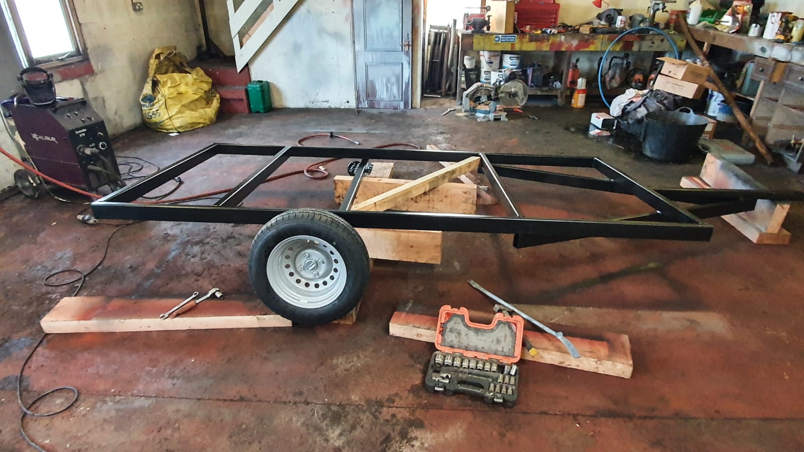

I started my trailer build over a week ago but I've only just got round to starting my build journal now.
I've attached a photo of my current status. Which is a fully built trailer chassis, with wheels, temporary lights, coupler and jocky wheel.

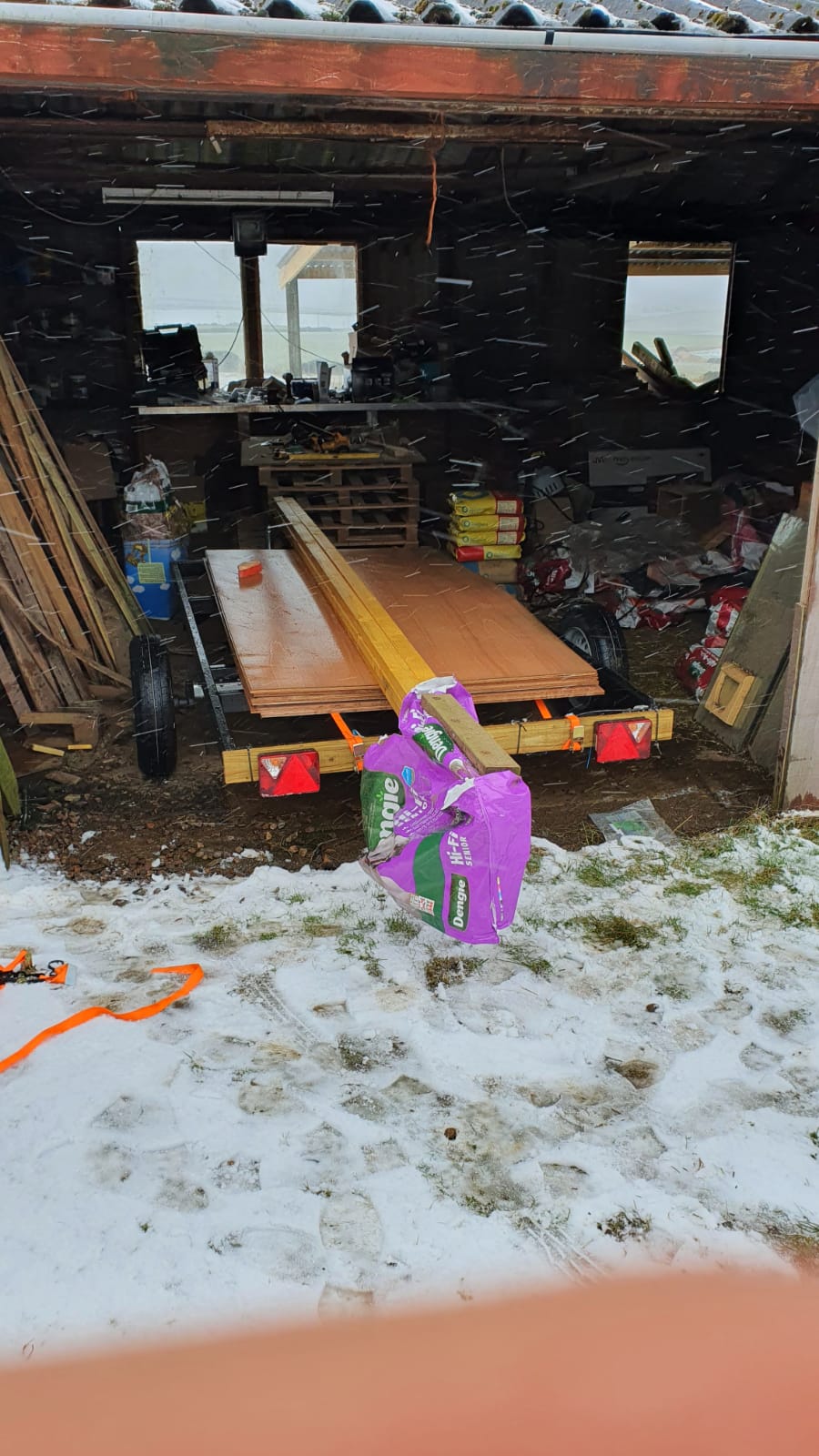

The reason I put temporary lights on was so I could use it to go and pick up the larger sheet materials I need to build it with! I got the idea from someone on this forum (sorry forgot who you are but thank you!).
Annoyingly the timber merchent only had 6 or 10 4.8m lengths of 3 by 2 so I'll have to pick up some shorter 2.4m lengths from the local B&Q (your version of home depot).
And yes I should have cleaned out my workshop before I tried to bung the trailer in it :lol: That's my job for tonight, tidy up the work shop, organise all my tools, create a nice working space ready for tomorrow.
I'll put up a separate post to show how I built the trailer so far (I'm still getting used to how the posting works).
Current status!
WhatsApp Image 2021-02-06 at 17.22.17.jpeg (200.03 KiB) Viewed 2060 times

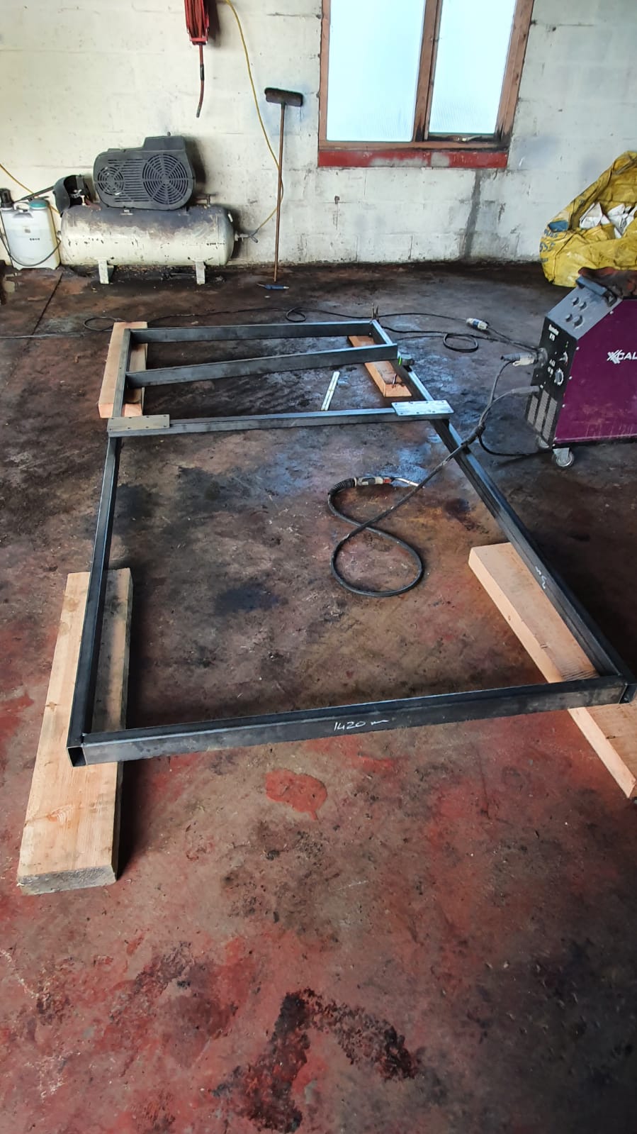

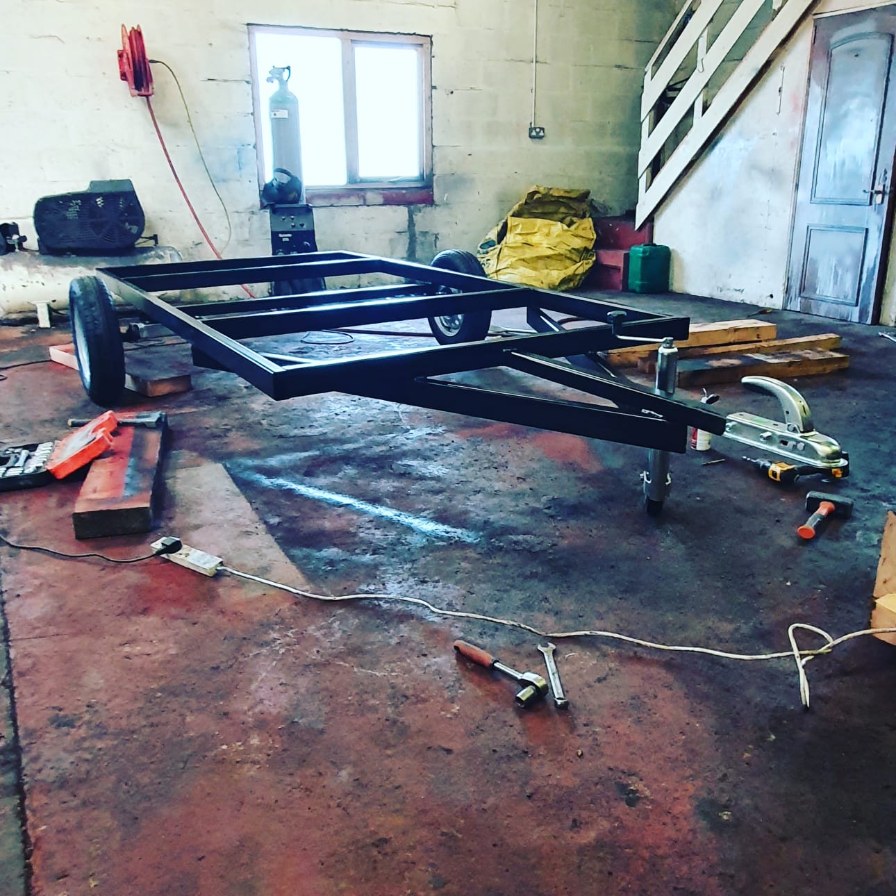

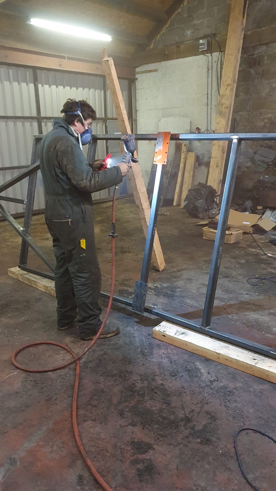

I have attached a load of photos of the build so far.
I MIG welded the chasis with 1mm wire in my friends workshop (his workshop is better than mine and his MIG welder is a dream). The steel place cut the steel to length for me, I only had to grind the angle cuts at the tip of the A frame tounge.
It is mostly made from 80mm x 40mm box section, the axel and tounge straight piece is 50mm x 50mm box section. The thickness is 3mm. It is standard mild steel, nothing fancy.
I did the calculations myself (I am an Engineer) to verify this is strong enough. It is about 5x stonger than it needs to be, but heck, I wanted it to look strong :D
The two long beams have open ends. I have bungs to fit in the open ends to stop water getting in. I'll drill a couple of holes on the under side so any water getting in can get out.
I sprayed it with a red oxide paint then a black enamel paint over that. The enamel paint scracthes, it's a temporary coating. I plan to sand back and spray Raptor Bed Liner onto it when I put the camper section on, I've read good things about raptor and it's quite economical.
The coupler, jocky wheel, suspension and 13" wheels all came as a "750kg unbraked trailer kit" it came with the 8 hole mounting plates for the suspension which I welded onto the axel. After than everything bolted on easy. Had to drill a few holes into my new chasis though :cry:
This is a 3m x 1.5m trailer (from wheel to wheel its actually 2m wide). The tounge is 0.9m (it has to be atleast half the length of the towing vehicle). Total length with the tongue is 3.9m
So far I estimate the weight to be 100kg or less.
It actually tows like a dream and I had to reverse it at the timber merchant and back into my driveway and it handled really well. The towing height is spot on too, the back end is up ever so slightly but once the weight of the camper is on it I'm sure it will be almost perfectly level.
I put temporary lighting on it (the lights came with the kit and will be the final ones I mount to the camper) so I could use it on the road for now. I was easy enough to solder some 12V wiring onto each bulb connector. and trace back to a wiring block (not really waterproof at this point!) then down a 7-core tailer cable to a 7-pin plug. Luckily I had wire, soldering stuff from an old project. I used an old peice of wood to screw the lights onto and I cable tied the wiring on. I used a couple of ratchet straps to attach the light board as I don't want to drill holes into my chassis yet.
That's it so far.
If you have any quesitons about the materials I used or how I designed this trailer just ask!

More photos
useable trailer - no lights yet.jpeg (233.04 KiB) Viewed 2054 times
Wheels on.jpeg (184.32 KiB) Viewed 2054 times
Spraying red oxide first then enamel black paint.jpeg (154.64 KiB) Viewed 2054 times

The suspension came as a kit, so I put my faith into the manufacturer that they will perform as rated (750kg in this case). As you have said, my concern also was the connection of the reciever plate onto the axel. I fillet welded this on, as the 50mm x 50mm box for the axle is only 3mm thick the penetration of the weld is really good, I had to be careful I did not bend the axle due the the heat of welding. The connection between the reciever plate and the supsension unit itself is 8 bolts. As for the twist they impart on the frame, in theory you don't need an axle for these units, but I opted for an axle as I wanted any twising forces to be assisted by a box section in the plane of the torsion rather than just rely on the larger frame. You will find that I like to beef things up a little more than they need. If you have any specific quesitons just let me know. I'm learning as I go but if I figure something out and can save others time I'll do my best to help out.
PS - I was taking the photos so the guy in the boiler suit is a good friend of mine who has a better welder than me and a paint sprayer, but he ended up helping out because he loves DIY stuff (he is also a better welder so I asked him to do the tricky ones :R ). The trailer is back in my own shop now, ready for the next phase!
