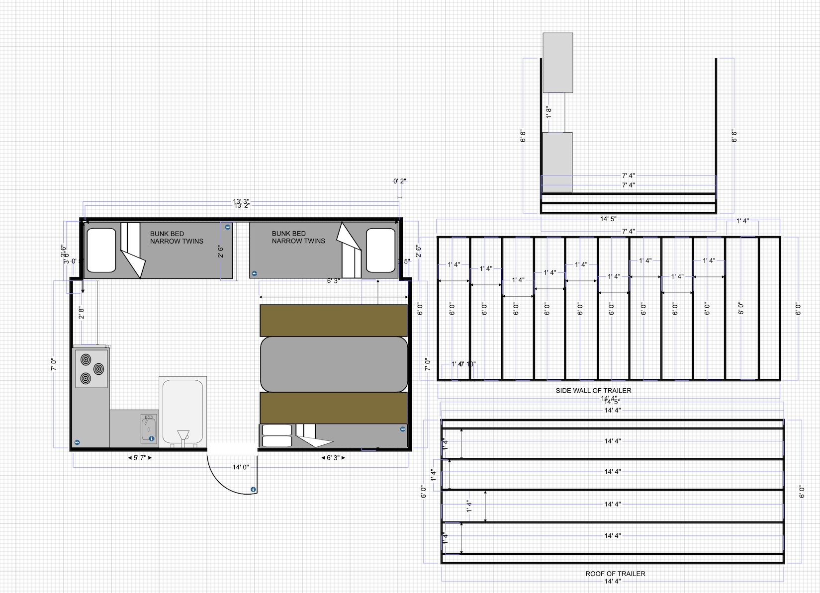

Working on a 15.5x7.5' camper that can both lift (so it can fit under a 7' tall garage door) and has a very large slideout.
Currently my floorplan & wall plan looks a bit like this:
floorplan as of now
Screen Shot 2021-02-08 at 2.42.35 PM.png (402.55 KiB) Viewed 2724 times
I may see about redoing the walls as being *mostly* a foamie though. Estimated weight with the walls, floor, top, & frame is just under 2k lbs for a tow vehicle rated for 3500. I could possibly shave off 400 lbs or more by switching to foamie instead of studded out foam filled w/ plywood. (Seriously, it's the plywood that's a killer with regards to weight.)

Sweet dude! I figured out today that I can hang the queen bed instead of making it a wall-bed and thus gain storage in the dinette. So I'm going to be using Racor lifts. Doing this also allows me to curve the trailer to help with Wind.
