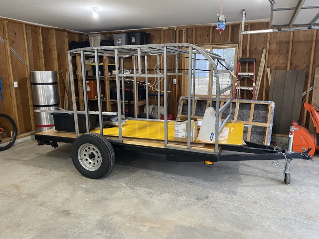

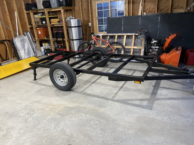

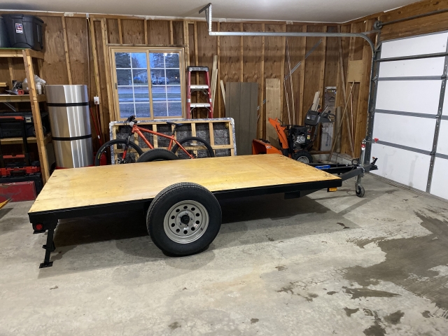

The first thing I did was strip the trailer of the structure that the original owner had built. I wasn't a fan of the design philosophy that he had.
Next, I removed the floor (3/4" birch). The top side was polyurethaned and the underside was covered in roofing tar. I plan to use this, unless anyone has any roofing tar horror stories to share.
With the floor off, this allowed me to inspect the trailer wiring. I have never seen a factory built trailer with a wiring job built to last, and this was no exception. I went through all of the wiring and waterproofed all of the connections with liquid electrical tape.
With a clean slate to build off of, I turned my attention to designing. With my day job being as busy for me as it is right now, engineering both during the day and during the night really didn't sound all that appealing to me. That was around the time I stumbled across this forum. A few, very respectable, names seemed to repeatedly jump out with helpful replies under every thread that I read. I wound up reading Tony's build journal and his build strategy impressed me a lot. I liked the majority of the features that his teardrop had and decided that I would base my build off of his tried and true design, rather than spending precious shop time designing my own. A few tweaks will be made to suit our style and desires, but my wife and I both think that this basis of design will suit our needs well. Thank you Tony! Your book is well written. Our goal is to have this thing ready to camp in by mid July so that we still have a good chunk of Northern Michigan summer to enjoy it.

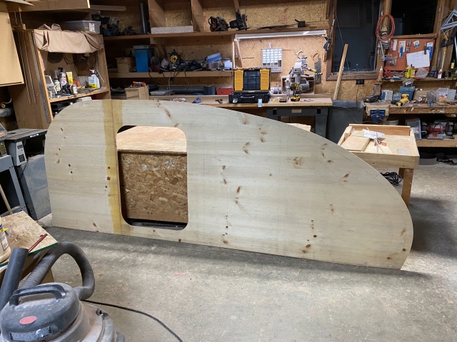

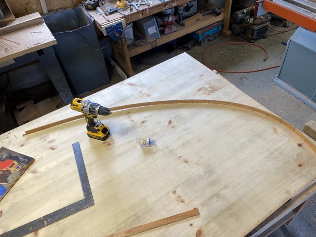

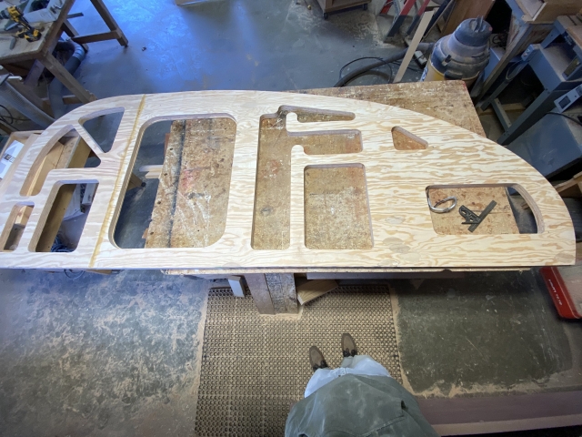

I started by making the template with some leftover 1/4" plywood from a different project:

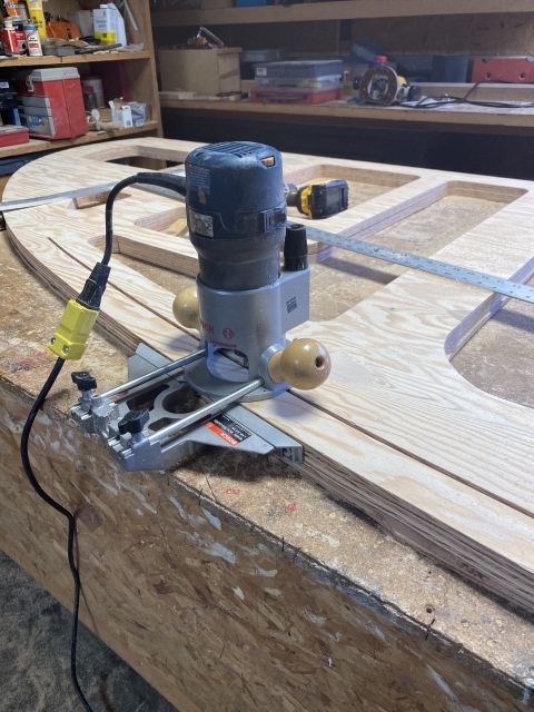

Next came the skeletons. We decided to use 3/4" marine grade ply for these. I used a top bearing, flush cut router bit for the outside edges and the door cutouts. Both skeleton walls were screwed together along with the template on top.
The insulation voids, roof blocking, and floor were cut out while the skeletons were screwed together as well. I used a high quality up-cut jigsaw blade for the voids and a 1/4" spiral upcut bit with an offset router guide for both the roof blocking and the floor.

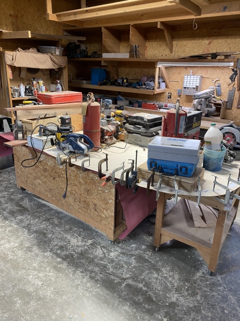

At this point, we are in the process of gluing up the prized 1/8" birch to the interior sides of the skeletons, and as I was writing this post, I realized that I made my first (likely of many) unfortunate mistakes. Since I am using 1/8" birch on the interior sides of the walls and 1/4" birch on the outsides of the walls, I should have remembered to glue the 1/8" so that the two walls were opposites of each other. Instead, I completely forgot and now both walls have 1/8" glued on the same side. Luckily, I purchased 4 more sheets of 1/8" than I actually needed. As a fix, I will glue up one of the walls so that it now will have 1/8" on both sides. Both sides of this wall will be flush cut to the skeleton and have the dados cut. I will then proceed with gluing 1/4" with the overhangs for the floor and roof to the exterior sides of each wall as originally planned. All said and done, one wall will be 1/8" thicker than the other, but thankfully it is a mistake that I can recover from. When I first realized I did this, I thought I was going to need to rebuild the whole wall.
Here's a picture of the glue-up:

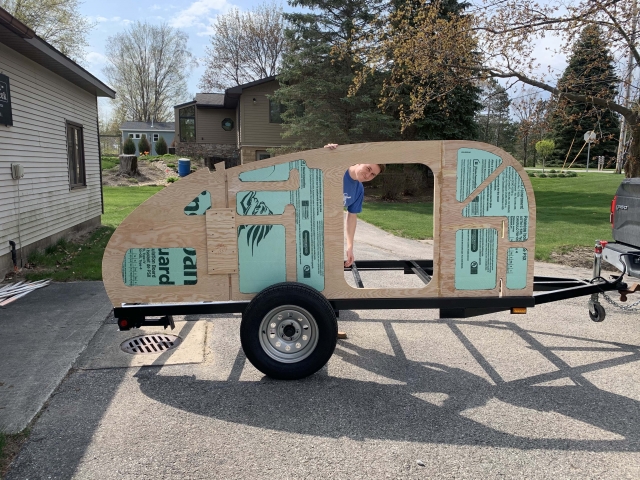

With 1/8" baltic glued to both walls, I flush cut all the edges and dados. While I was doing this, my wife cut 3/4" foam for all of the voids and we got them set. Now, just waiting on the wall with the additional layer of 1/8" to dry before we can move on to the 1/4" exterior skins.

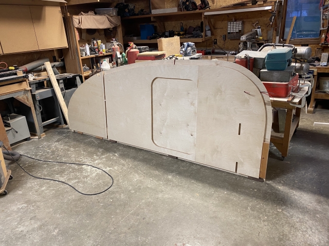

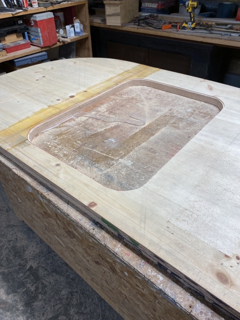

Finally seeing the light at the end of the wall construction tunnel, even though cutting out the hatch is still standing between us and the finish line. I cut 1/4" birch ply using the template for the exterior sides of both walls. Prior to glue up, I used a 1/4" router bit to make channels for the wiring for the porch lights and the interior reading lights. Using blocking on the bottom and leading edges to properly align the exterior skin worked well and made the glue-up easy.
While the glue was drying for the first wall, my wife and I daydreamed for a little while about finally getting to mount them on the trailer.
Before the floor and walls get mounted, I'll need to move the axle back 4" or so to account for the door clearing the fender.
Once the first wall was dry, we repeated the process with the second wall. It felt good to finally have the full-wall glue-ups behind us. Additional layers will still be added in the galley, but at least those won't require a second set of hands to complete. Here is a photo of the first wall completed, prior to cutting out the door:

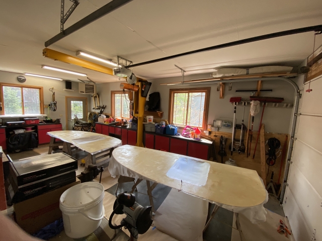

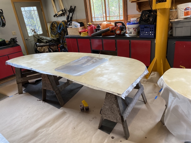

Postby GarthB » Sun May 09, 2021 6:37 am

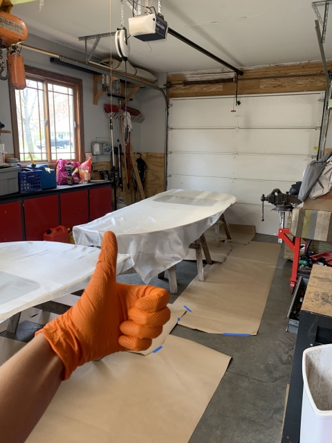

Yesterday was a good day of teardrop building. The temperature was around 50F all day so we ended up taking over my parent's heated garage in order to get the walls fiberglassed. We opted for Raka's medium viscosity resin with the non-blushing hardener and 4oz standard woven fiberglass cloth. Prior to glassing, we cleaned up all of the edges of the walls and sanded any rough spots on the exterior skin. Thankfully, we had room to work on both walls at the same time in their garage, so we were able to work pretty efficiently.
We both really enjoyed this step. I had previously worked on a deep-pour epoxy project, but aside from that, neither of us had any epoxy or fiberglass experience. A couple "how-to" youtube videos steered us in the right direction. We look forward to doing the roof and hatch.
We ended up doing two coats of epoxy on each wall, spaced about 3 hours apart. The first coat went smoothly and we had no issues getting the fiberglass wetted out and any air pockets removed. A significant amount of this coat was absorbed into the plywood and we could feel the bumpiness of the fiberglass weave when we ran a scraper across the surface at the 3 hour mark. It had tacked up well, so that was when we completed our second coat.
The second coat left the walls feeling glossy smooth after 5 or 6 hours of cure time. There were still a couple small areas where we could feel minor bumpiness, but in my mind, not enough to justify a third coat. If it is still noticeable after we prime it, we will use some thickened epoxy to take care of it.

Another issue that I am currently working through is in relation to the trailer. When we set our walls on it the other day, I noticed both ends had about 3/8" of a gap between the bottom of the wall and the top of the trailer frame. Both sides of the trailer have a slight positive camber bow. My best guess is that when the axle was welded on, they dumped a little too much heat on it all at once rather than staggering it out. I've debated trying to straighten the trailer, but I don't like any of the options for doing so. Instead, I think I will shim the undersides of the floor on either end with 2" aluminum flat bar stock. I won't have to worry about the aluminum rotting and I can bolt right through it when I fasten the floor to the frame.
Because of the bow in the frame, I am going to try to avoid moving the axle back. I don't want to make the curve even worse by adding more heat. We'll see how it all works out once we get some fenders and mock them up with the door.

Postby tony.latham » Sun May 09, 2021 8:03 am
Thanks a gazillion for saying that. It was a job to write. :thumbsup:
Re: G&M's 'Drop
Postby swoody126 » Sun May 09, 2021 8:11 am
GB, pox is not compatible when applied over primer
the subsequent issues will knot be fun to deal with
any poxifying kneads to be done all at the same time BEFORE any primer is applied uness you intend to use primer compatable fairing materials then on to painting
if when sanding you begin to get a whitish cloth pattern you need another coat of pox to maintain the sealing effect and end up w/ a smooth surface
