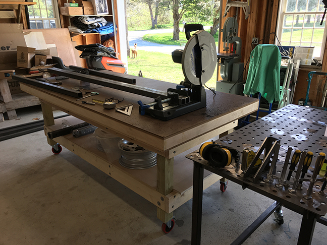

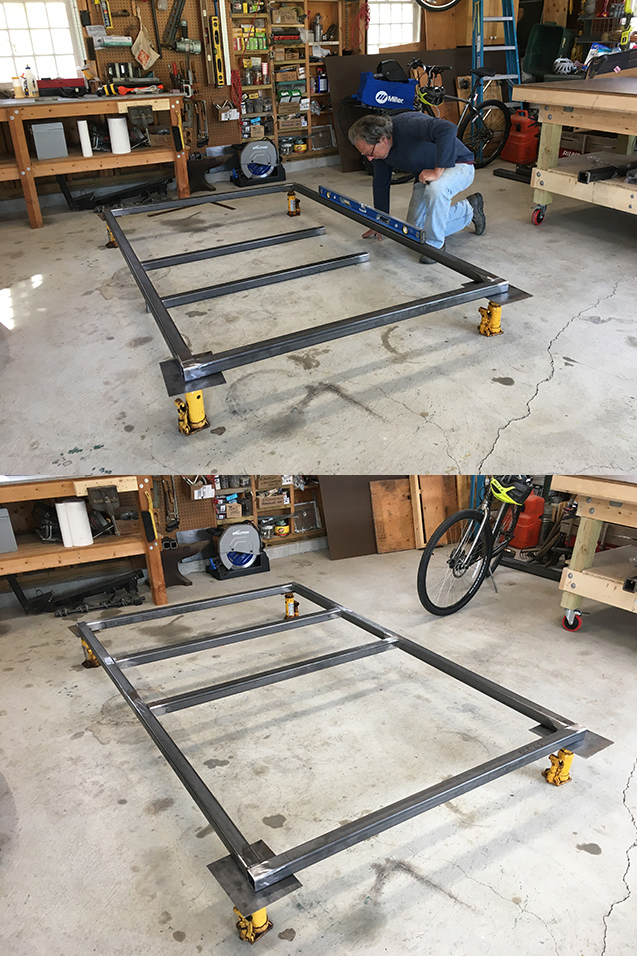

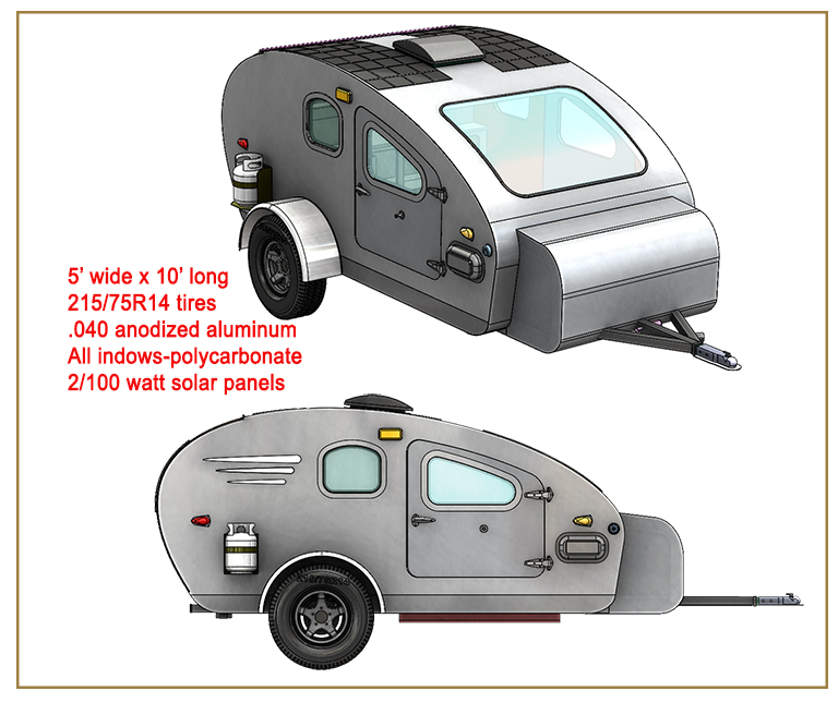

I started by turning my garage into a studio of sorts. I've never welded before so I bought a welder and spent some time teaching
myself to weld. These first images show my CAD design for our trailer and the start of the frame. Today I'll work on the tongue.
Just tack welding the members together first.

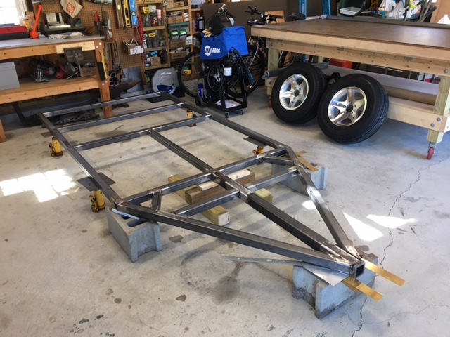

Thought I'd share the last couple of days progress.
Got the frame tack welded together. Still need to add the rear hitch sleeve and the angle plates which will serve as the cabin attachments. Before that I'll weld up all the seams.
Ordered the Dexter axle last week... takes about 6 weeks to get that fulfilled.
