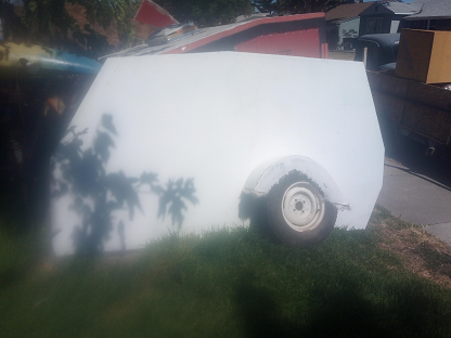

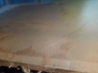

The panel in the picture took less than four hours to make and that includes making a template and drilling out 8 sheets of the foam it is ready to be glued to the pod that's with the exterior fiberglass skin the 1'' foam in interior fiberglass skin

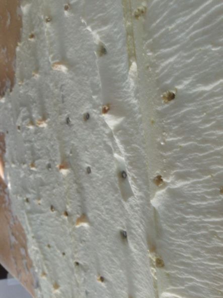

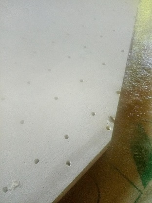

It's the holes that make this work on a angle
structural foam with fiberglass Flame retardant surface Veil on it.
SMALL HOLES.jpg (174.23 KiB) Viewed 5317 times

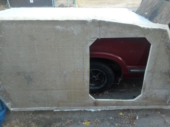

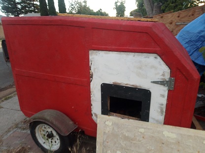

after making the panels . I cut Tony's book trailer cut out in under an hour including the bulkheads using a CNC template made from 1/8 hard board a router with a pilot 3/8 bit and a 3D printed pilot bit.to get that outside shelf to put the roof on. but by building Tony's way you have the classic feel of a wooden trailer on the inside.
That ok Tony all fiberglass trailers look the same . not a trailtop build. It's a stressed skin construction.
Right now we want the square top shape not the traditional shape so I gave it away.
I was to have 5 days all to myself then I got poisoned. food poisoning but I keep seeing all these Porsche brochures in wife's purse . should have had a pod done
The panel in the picture took less than four hours to make and that includes making a template and drilling out 8 sheets of the foam it is ready to be glued to the pod that's with the exterior fiberglass skin the 1'' foam in interior fiberglass skin . So when I get the other 6 done we'll just have to glue up and run a bond ring around the top. Then have to worry about maintenance in 5 or 6 years . and if someone shoots a cannonball through it I may have to worry about fixing it in a few years as there's nothing to rot damn old-time rough neighborhood

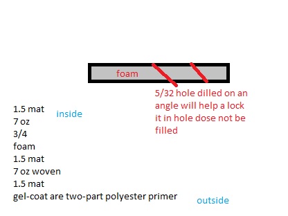

had a few question the wisdom of using 1% Mek Catalyst with polyester resin and the right foam well it's over a hundred degrees here.
what you're trying to have three layers not gel up before you can get the foam pushed in
even if you laid up resin and forgot the Catalyst just go over it with some catalyzed resin and push it in the sun it will cure
You work from the outside in that way you'll have a smooth outside finish
gel coat ARE two-part polyester primer

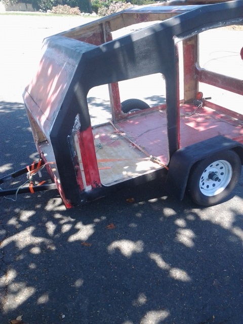

I ended up in the hospital for a few days and it's all jess fault video withdraw. I have built with trailtop components and honestly like the looks of it better because of the recesses. for ease stressed skin panels seem easier and faster .Hope to be back to working on it in a week are so

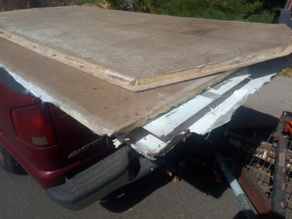

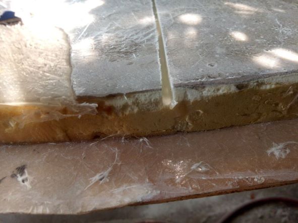

this is what the skins pulled apart look like. you can see the resin drizzle in the holes locking the inner and outer skin together .

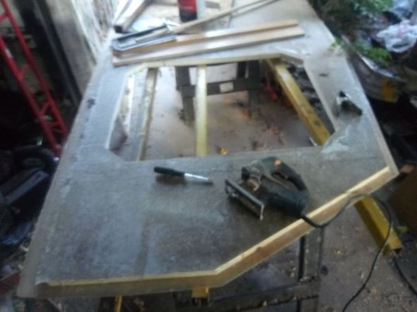

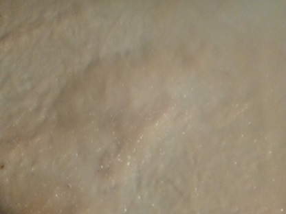

Spent a few hours to day .If you finished up the skins on both sides and cure. You will notice you now have a bow in the panel. polyester shrink you have a real good bond to the foam because of the holes . I levee them in the floor and roof preload. I cut the doors out of the sides. at the door opening closest to the center I will cut slots on top and bottom. Not through outer skin . You won't lose any strength because this is where the door jamb will go and also you will have a interior and exterior Bond beam top and bottom. you will pull panel flat and back fill gap .
