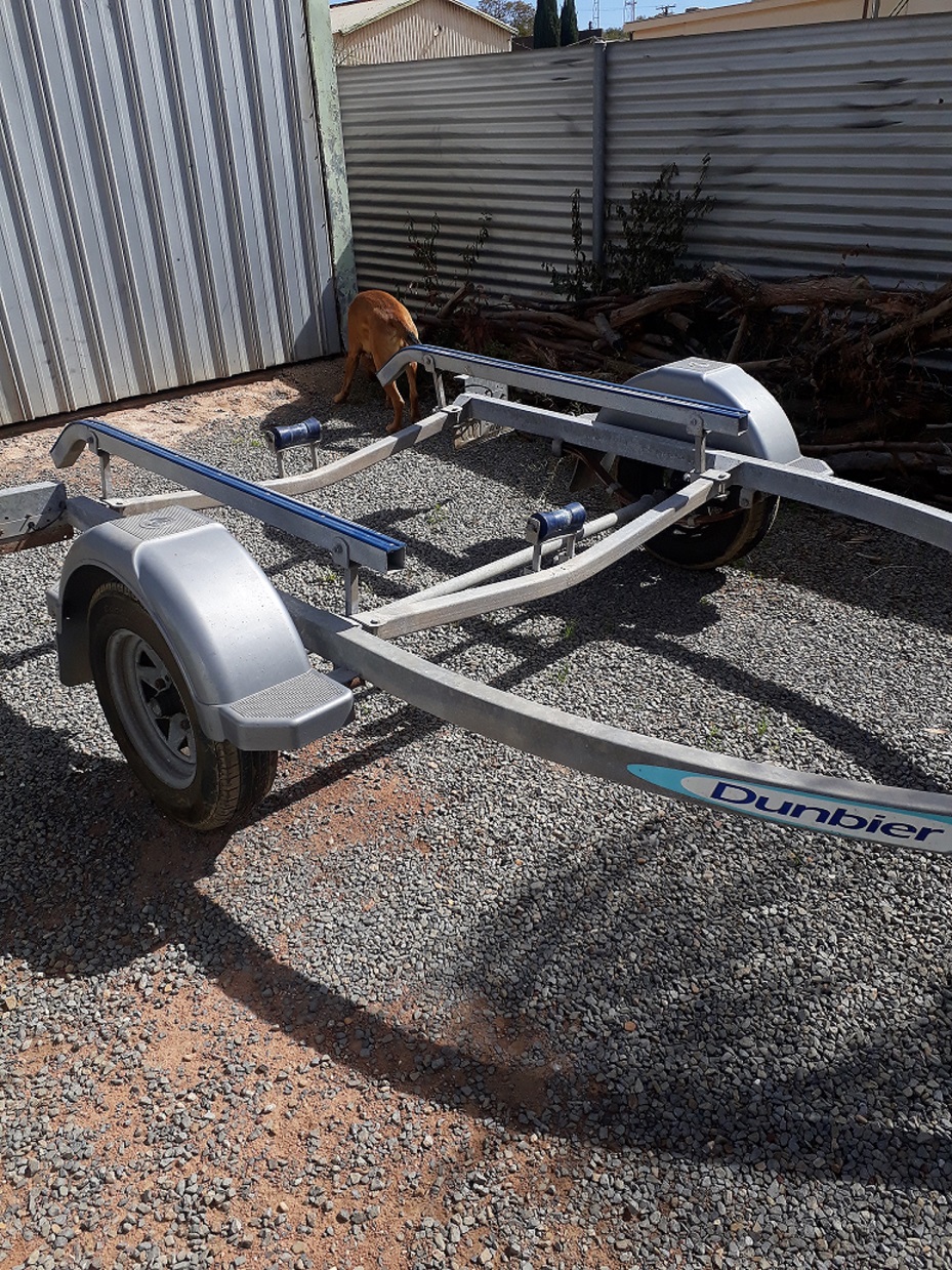

Day 1
Buy trailer and strip.

Heck, I wasn't. :)
It's been on my radar for a while.
I figured I needed a hobby now I've stepped away from work. Hopefully a paying hobby.
Australian Facebook pages are flooded with hopefuls looking for cheap teardrops since overseas travel dried up, and I figured I could do a reasonably quick build and make a small profit. It will be basic. Minimal cabinetry, homemade doors, aimed at people who want to step up from tent camping, and can't afford a commercial unit.
The other day I dropped into the local boat dealership to say g'day to the owner, who I went to school with.
After chatting about the fishing and local industry for a while (he's also the Mayor) he said "I hope you've got something to keep you busy."

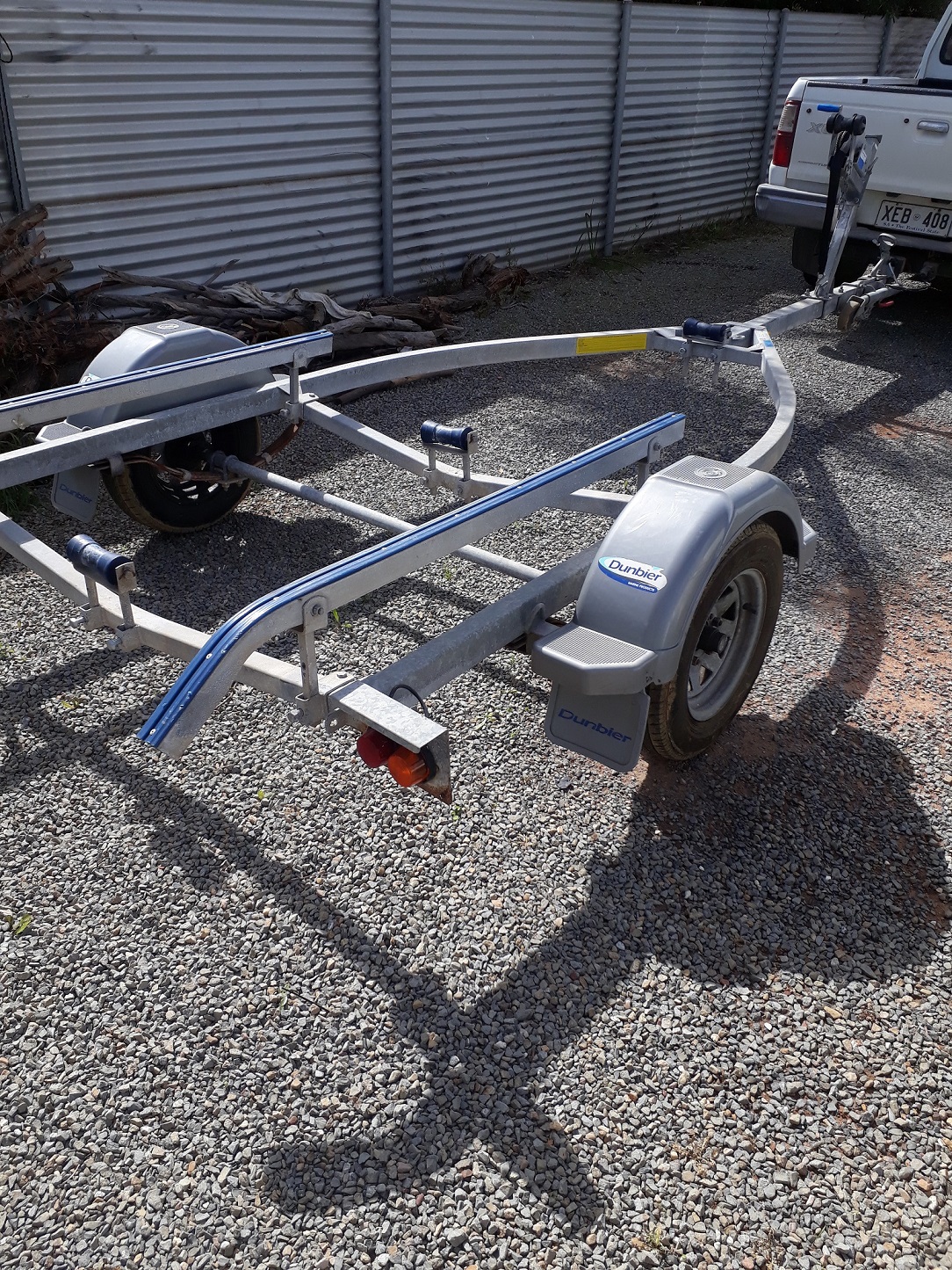

I mentioned teardrops, and left with a boat trailer. :)

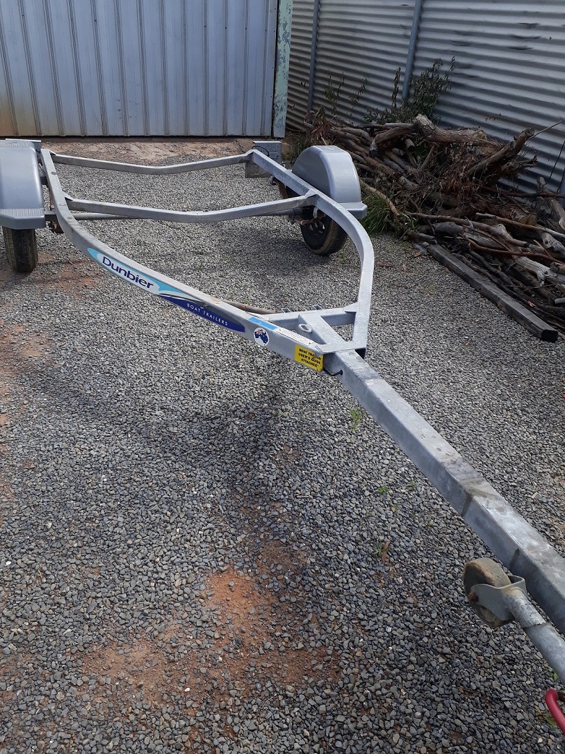

Price was right and its in reasonable nick. Registration is current, although the owner who had it there on consignment is stuck in Western Australia at the moment due to Covid travel restrictions, so I may have to wait a while to get the papers.
Unfortunately, running a spirit level over it, I find it isn't very straight. Boat trailers don't have to be, because the adjustable rollers and bilge boards take care of all that.
It'll need spacers at the right rear corner or the front left corner to bolt the floor down flat without a twist. I'm going to get Ol' #1 out of the shed tomorrow and run this trailer in so I can measure properly from the flat(ish) garage floor.
Getting a trailer even close to suitable is hard, so I will make it work.
I've already decided to use marine ply for the walls this time. The marine ply is genuine 8 x 4, so that gives me 3/4 of an inch more height to play with.
Metric plywood is 1200 mm wide, imported 4 foot marine ply is 1220mm.

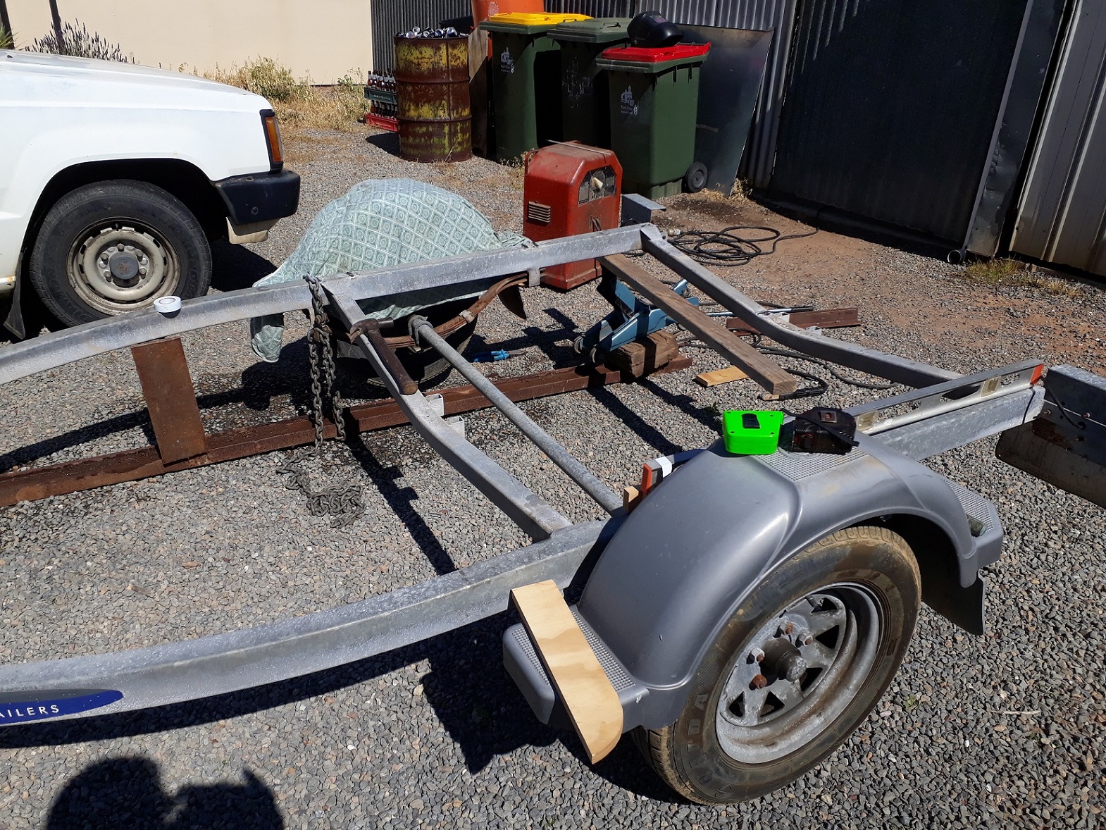

Postby MickinOz » Sat Aug 28, 2021 12:17 am
Believe me, I tried.
Unfortunately, my 20t Hydraulic jack popped a seal and took no more part in the discussion.
I think I'm fighting two or three weld distortions - where they welded on the front spring hanger, the front crossmember and the rear guide for the leaf spring.
I even tried the old trick of running some high amp arc welder beads across the rail to use weld shrinkage to pull it back the other way.
Nope, all that did was burn off some of my galvanising and give me a job grinding off the bead.
Picture is when I resorted to trying my 3t trolley jack.
So I had an I beam, with a piece of train rail at the front, a chain sling at the point I wanted to flex the rail, and a jack at the end.
Not a hope. :)
My mother has now returned home from her vacation to the seaside, so I will kick around her place tomorrow and see what treasures my dad left us.
Maybe there'll be a decent jack, and another dog chain. I only have one, but I'll try pulling it from the top if I can get hold of another chain and a jack that actually works. I may get desperate and pull the jack out of my pipe bender. If 16t won't get it..........

Well, I dragged Ol' #1 out of the shed and pushed the new trailer in.
With a decent flat floor to measure from, I'm looking at the front left and rear right corners being down relative to the front right and rear left corners.
Neither frame rail is perfectly straight. Each has some welding distortion where the middle crossmember and the spring hanger is welded on.
Nett, about 15 - 20mm of twist. Not from damage, just manufacturing tolerances/error.
It seems a lot I know, and some on here would no doubt start again.
That isn't an option for me.
I will make a flat floor, and distribute the spacing required so that about 8mm is place at front left and right rear.
That's about 3/8" on opposite corners.
With the walls carried down below the timber floor frame to just overlap the steel frame, should be able to conceal the mismatch.
So far, I've stripped the frame of all the boat bits, done some measuring and thinking, and painted the wheels.

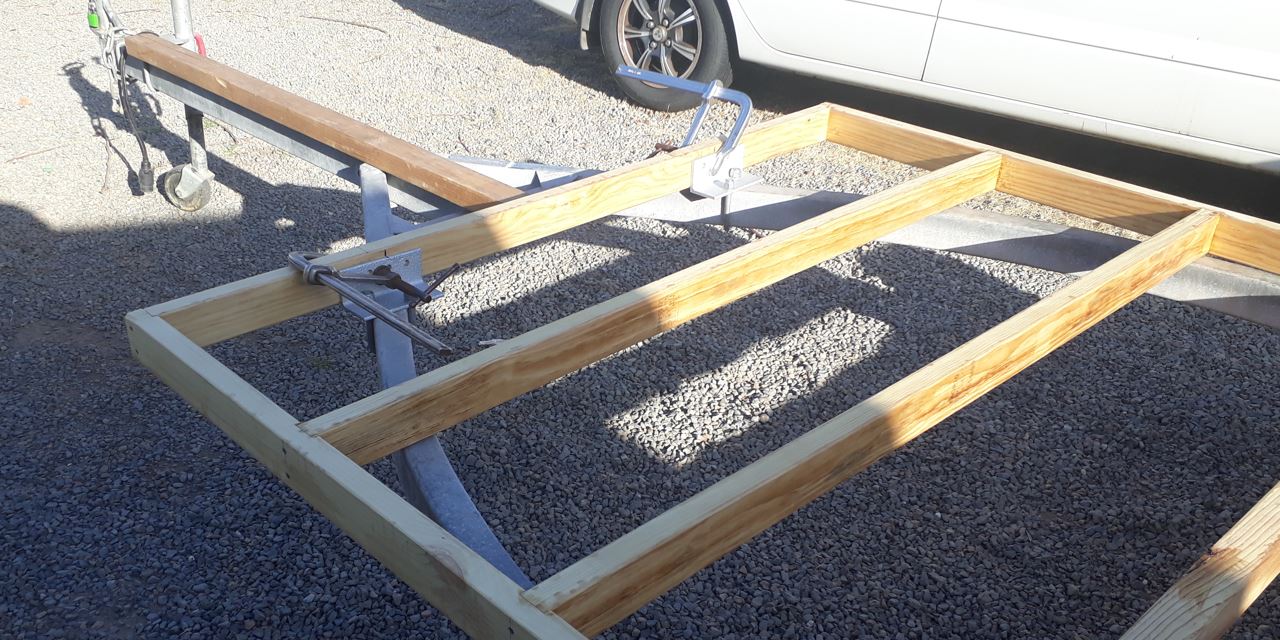

Floor slightly more of a challenge than last time. Last time, the floor had to span rails that were about 1300mm inside to inside.
I framed it with 70 x 35 pine and topped it with 15mm pine plywood. No insulation. No bottom skin to contribute strength.
I never notice any flex at all.
This time the floor has to span about 1420mm inside to inside. I was thinking of still doing the 70 x 35 frame, but using 12mm marine plywood.
The marine ply is hardwood, so I'm expecting it won't have any more potential to flex than 15mm pine.
But still, it has to span a little more.

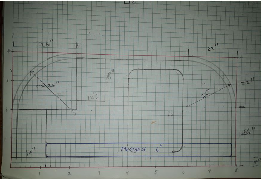

The Benroy profile floats my boat, and I actually think curves are easier than just "chamfered" front and back corners.
But, the Benroy compound rear curve did take a bit more work and thinking.
I find myself interested in the Rimple.
As drawn, It's got a 24 inch radius curve at each end.
I used the 24 inch curve on Ol' #1, and I reckon I could knock a couple inches off that curve and still easily bend the plywood.
So I'd make the front maybe 22".
Then, to get a smidgeon closer to the Benroy shape, maybe make the rear curve a touch more than 24".
Perhaps 26".
Drew it out to see what it looks like:

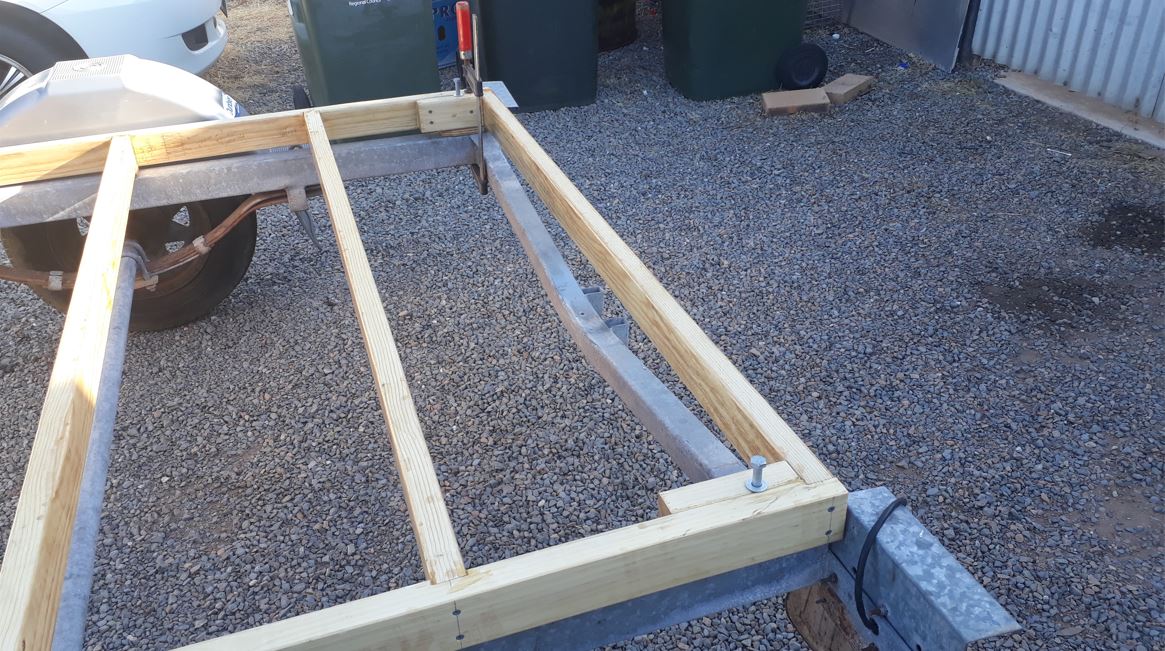

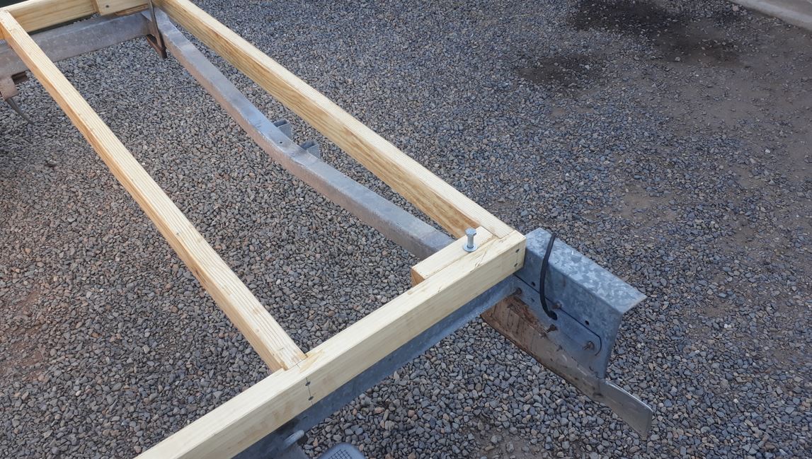

Just wrestling with ways to secure the floor frame to the chassis. Can through bolt it at the rear corners. 10mm (3/8") bolts everywhere.
Have clamped brackets to the front with 1/2" u-bolts.
Just along the sides now.
I know people weld on tabs, but I'm trying to avoid that for various reasons.

Front brackets a 5mm angle bolted on with 1/2" u-bolts with split washers and nyloc nuts.
A couple of 3/8 carriage bolts through the front frame should see me sleeping OK there.
Front Brackets.JPG (202.05 KiB) Viewed 2362 times
Rear will see two 3/8 bolts down through the 12mm ply and 70mm frame timber and the 2.5mm top plate of the frame tube.
Again, I don't think I'll lose sleep there.
Rear Bolts.JPG (237.18 KiB) Viewed 2362 times
What to do along the sides?
I do have some 10mm rivet nuts I discussed in a post elsewhere.
Maybe I wouldn't lose sleep over drilling the frame to take those? :thinking:
What to do along the sides.JPG (206.28 KiB) Viewed 2362 times

Postby DrewsBrews » Fri Sep 24, 2021 6:59 am
Probably past that point by now... but could remove the middle braces and replace them with some steel angle since you have the tools. That would give the chance to re-plumb the whole thing better and give flat cross bars to attach to instead of the bent ones.
