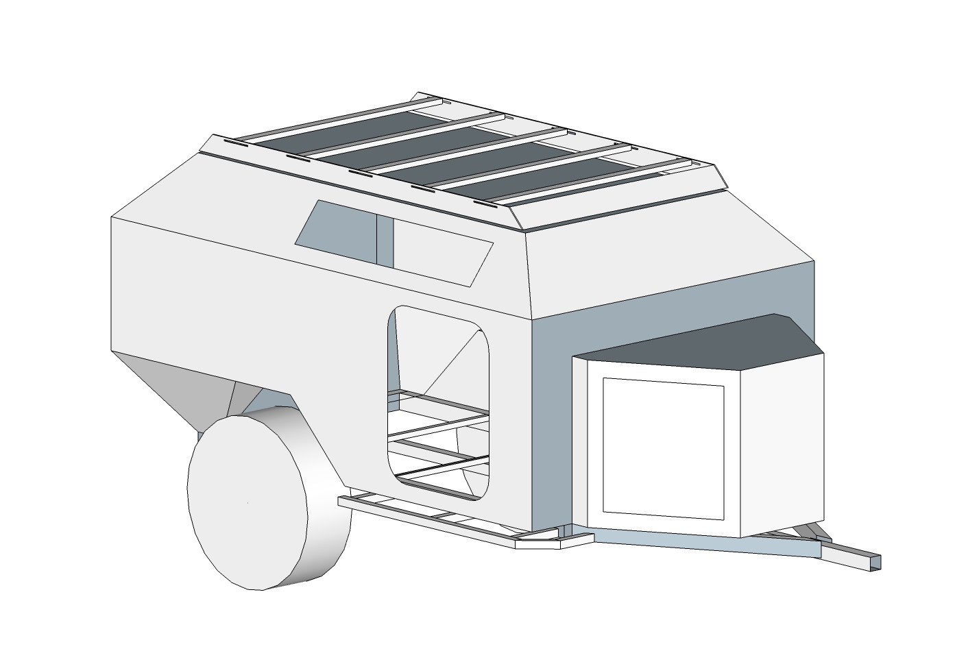

Here are some pics of the design:
thumbnail (1).jpg (95.39 KiB) Viewed 4660 times

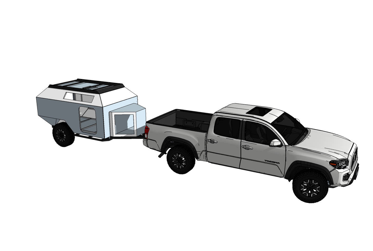

trailer 9-19 truck sgh.jpg (207.6 KiB) Viewed 4613 times
Here is the model scaled to my Taco
https://youtu.be/5kWsmt41YN8

Postby noseoil » Thu Sep 30, 2021 8:09 am
I like it! Should be a good rig for off the road stuff. Nice design with lots of interior volume.

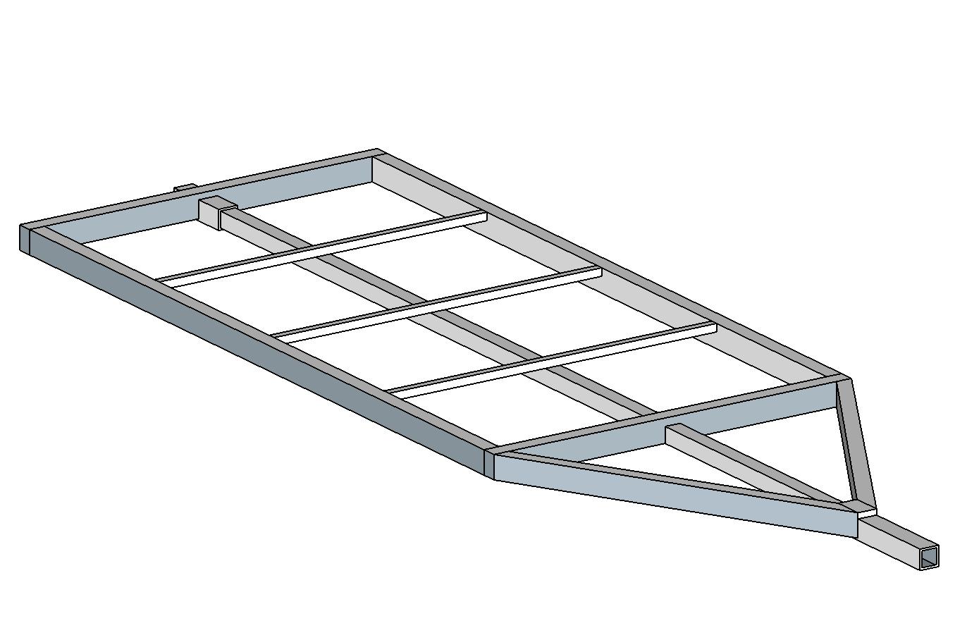

Here is the frame design
https://youtu.be/rYeDztazuYo

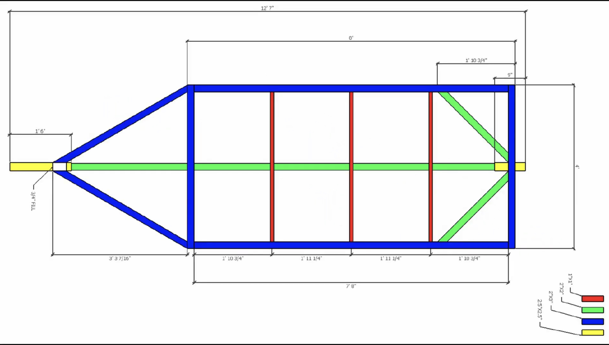

Postby twisted lines » Mon Oct 18, 2021 1:29 pm
This looks like a nice way to adjust; When that 60/40 theory just won't work.
Drill 5 holes and move as needed :thumbsup:
Nice build. TL

twisted lines wrote:This looks like a nice way to adjust; When that 60/40 theory just won't work.
Nice build. TL
Good idea...hope I don't need to though since the wheel well will be built into the cabin ;)
