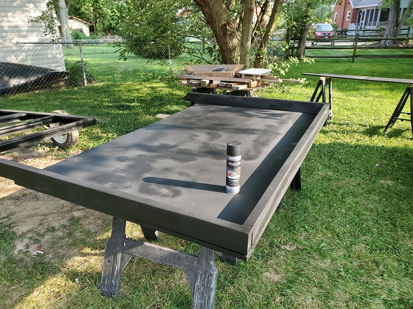

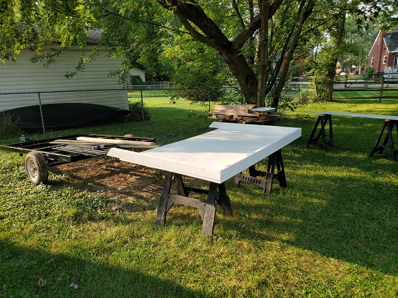

Frame for front of bed, laid out in the basement before assembly:
Front floor section, upside down for priming:
Front floor section, upside down for spraying liner:

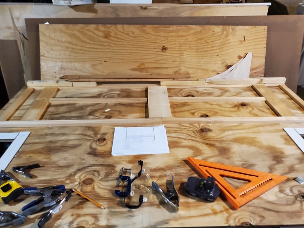

August 22nd through 25th saw a lot of activity. I got the edge 1x glued onto the 1/4" plywood curbside and streetside wall panels, and cut out holes for the windows and door.
167499167500167501167502
