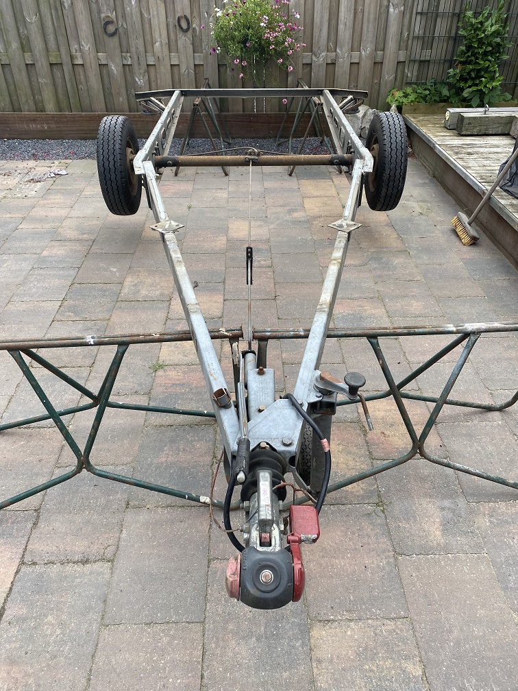

Hello there,
Just introduced me last week to your beautiful forum.
I started my build two months ago, and hope it is interesting enough to share with you all.

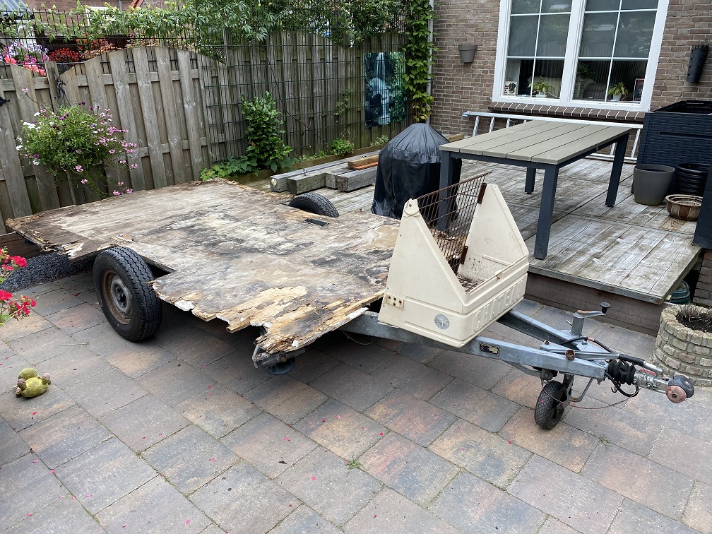

It's gonna be a full build from the ground up.
Started with a old caravan that i striped to a bare chassis.
Next job is the coupler that need to bee refurbished.
Kit is ordered online.
Frame is being split in half. I only need the front section. That's where the registration plate is:-))

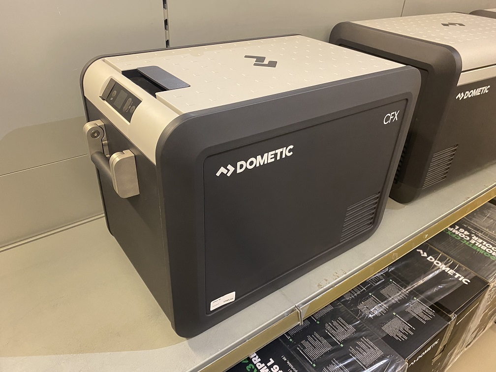

Postby Marcogs » Mon Jan 03, 2022 6:35 am

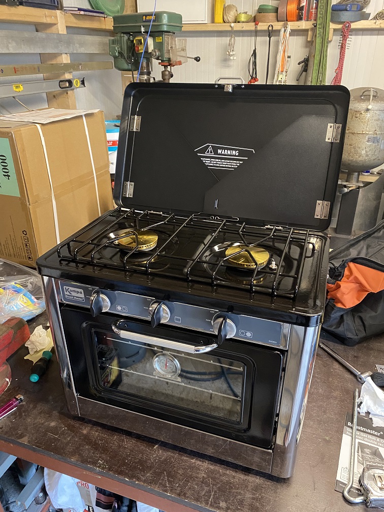

Also bought two main items that I really wanted.
Now I can measure the depth and height of the drawers.
Very happy whit it :thumbsup:

Postby noseoil » Mon Jan 03, 2022 10:22 am
We used the same type of stove, but it gets hot when the oven is lit. Fastened an aluminum angle at the bottom of the stove to attach the drawer guides, then set it up for tracking in the opening. The sliders from a bathroom stall work to keep the stove in the closed position when traveling. It works well enough.

Postby Marcogs » Mon Jan 03, 2022 1:34 pm
Nice set-up, i am planning to place it side ways to make more room for a bit bigger center cabinet. Maybe with a sink over it.
Can be changed in de build process :thinking: , but thats the plan so far.

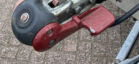

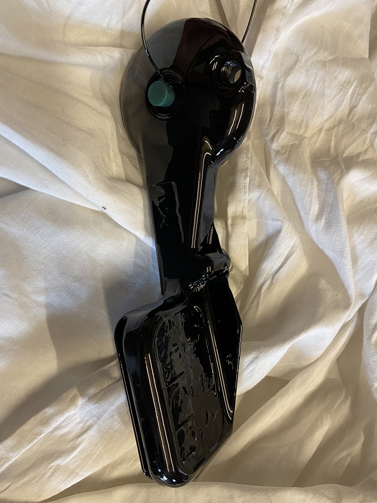

Postby Marcogs » Wed Jan 05, 2022 6:54 am
The draw bar had to be " restored". So i ordered a kit online and made it new again.
Also the clamp lever powder coated. (had no red anymore, but gloss black looks nice by me.)

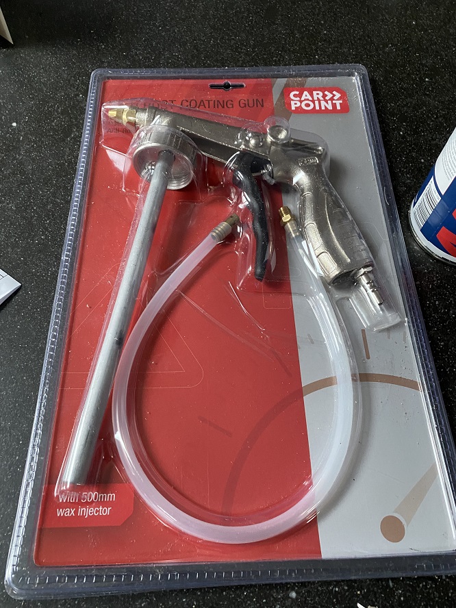

Postby Marcogs » Wed Jan 05, 2022 7:07 am
Last night the undercoating came in.
Zink based spray coating
Should be good.
When the position of the axel is clear and the guardrails in place. Then I'm gonna build me a spray cabin.

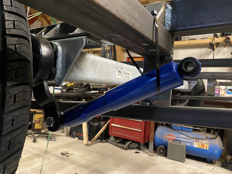

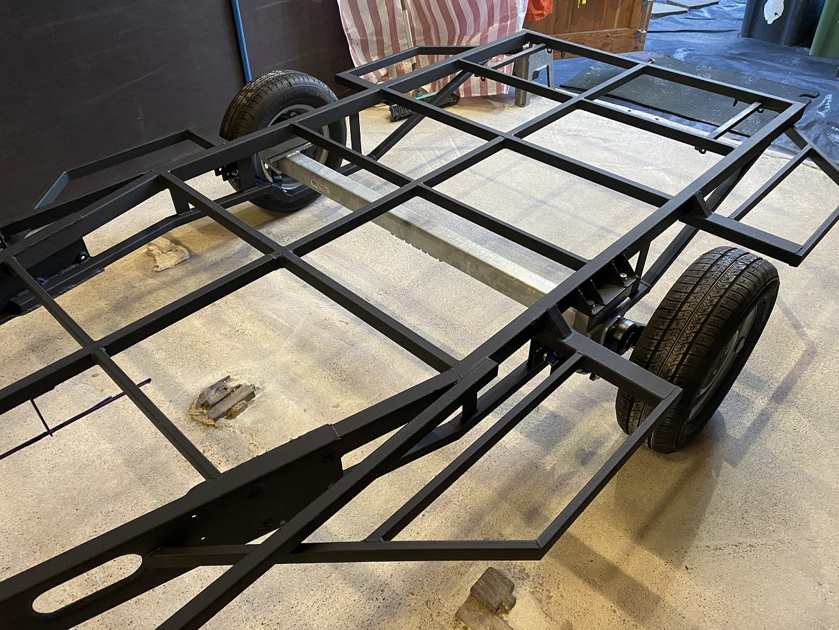

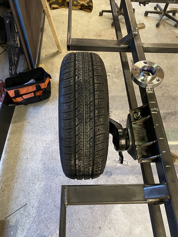

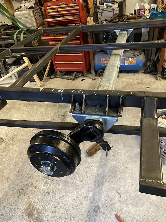

Postby Marcogs » Wed Jan 26, 2022 7:33 am
Finally,
My brand new 3000pound axle arived last weekend.
So it's Go time. A litle adjustment here and there, but nothing serious.
Marcogs
Posts: 66
Joined: Fri Dec 24, 2021 2:48 am

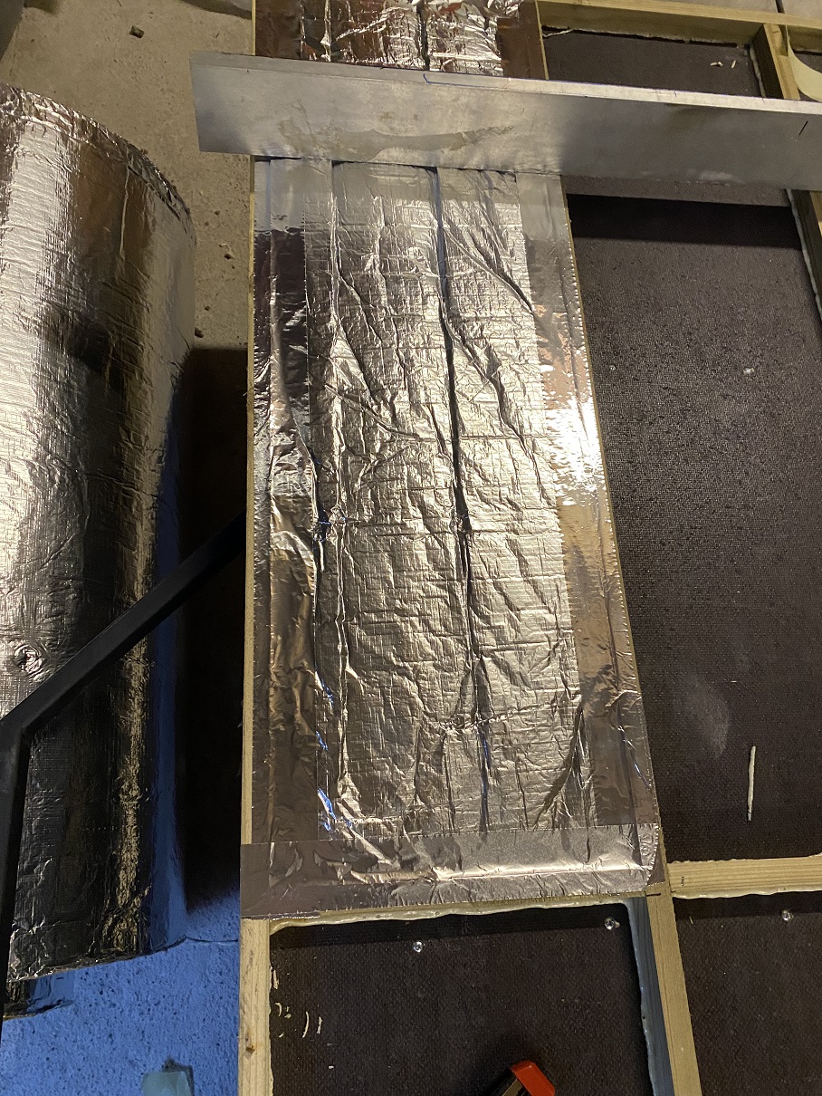

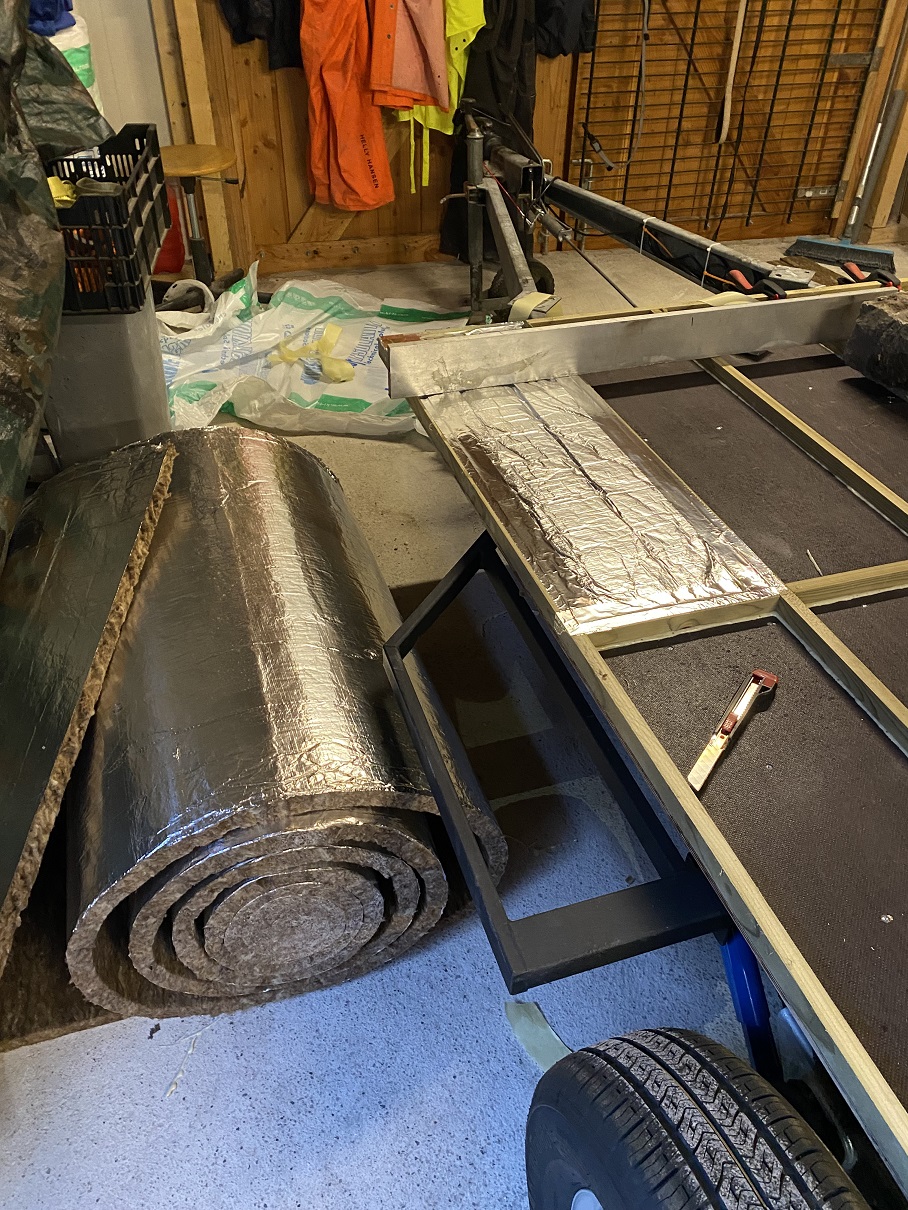

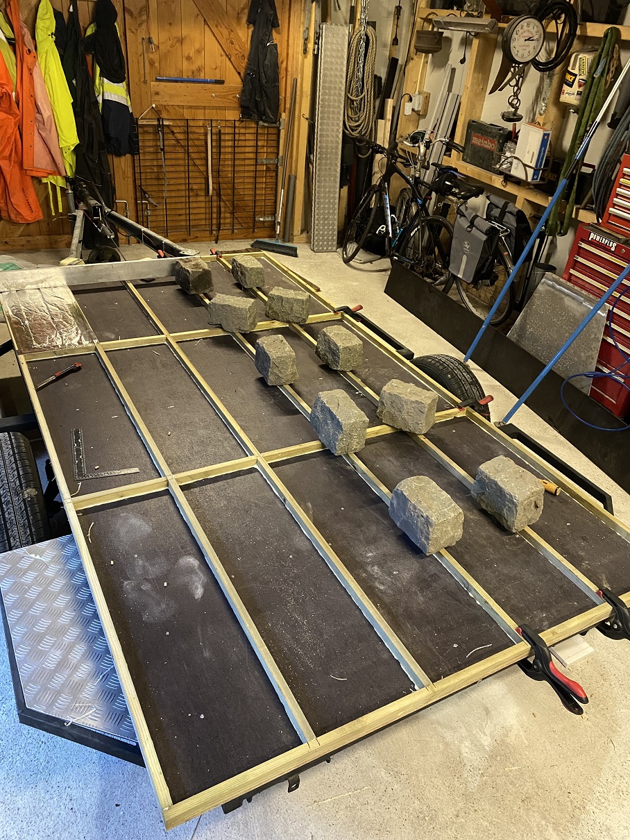

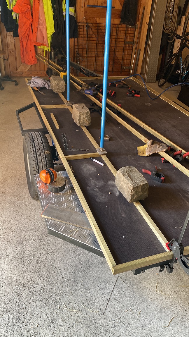

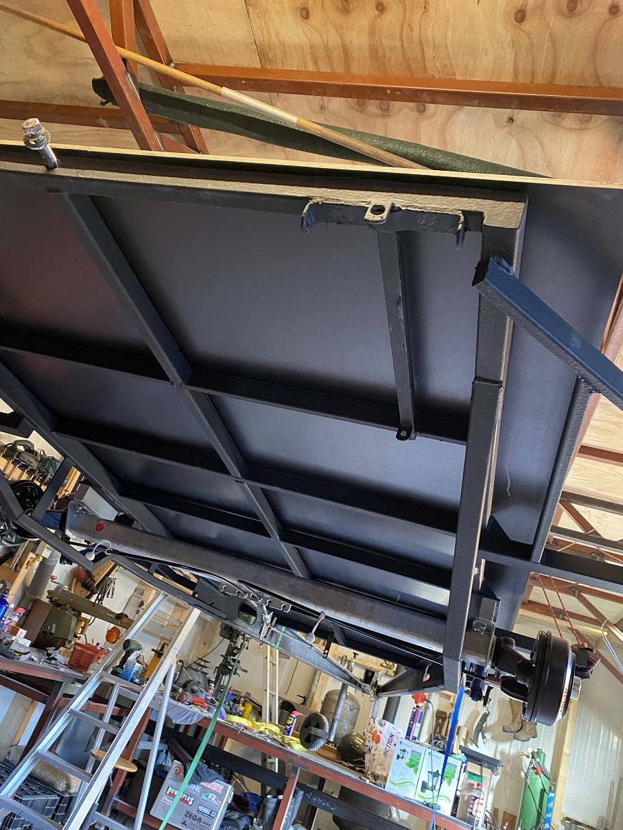

Postby Marcogs » Mon Apr 04, 2022 2:18 am
Here we are again,
Did some things to the base.
Did the frame with anti stone chip and put the underfloor in place.
Now pre insulation work in progress.
Marcogs
Posts: 66

Postby Shadow Catcher » Mon Apr 04, 2022 7:26 pm
Looks good. We have a much older version of the refrigerator, now more than 14 years old.
We do hope you will share your travels and country with us.

Re: The Dutch build
Postby noseoil » Tue Apr 05, 2022 8:44 am
Very nicely done. That should last for ever the way it's built! Should be nice for towing with a smooth ride & good handling.

Re: The Dutch build
Postby Marcogs » Wed Apr 06, 2022 7:48 am
noseoil wrote:Very nicely done. That should last for ever the way it's built! Should be nice for towing with a smooth ride & good handling.
Thanks :-) It's my first time and trying to do it right.
May take a while, because i need tot do it alone, but no rush.
Yesterday started with the insulation of the floor.
