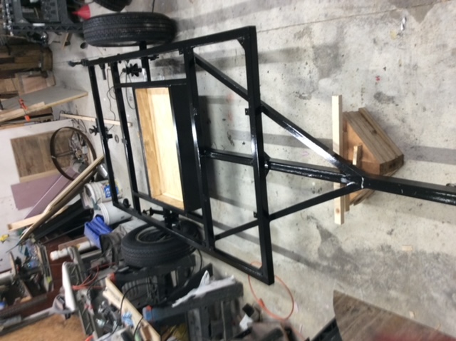

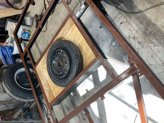

Postby Burbs » Sun Mar 27, 2022 1:17 pm
I have made a bunch of progress even before this first post. Frame is 2” square tube 5x8 ft with storage underneath for the spare tire, jack, etc. Tongue is 2x3” 3/16” tube. Axle is a 3500# Dexter with 4” drop and electric brakes. I also added square tube sockets to accept the stabilizer jacks so the do not have to remain attached on the road. I am wiring the trailer’s lights now before I begin attaching the walls.

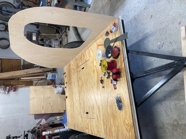

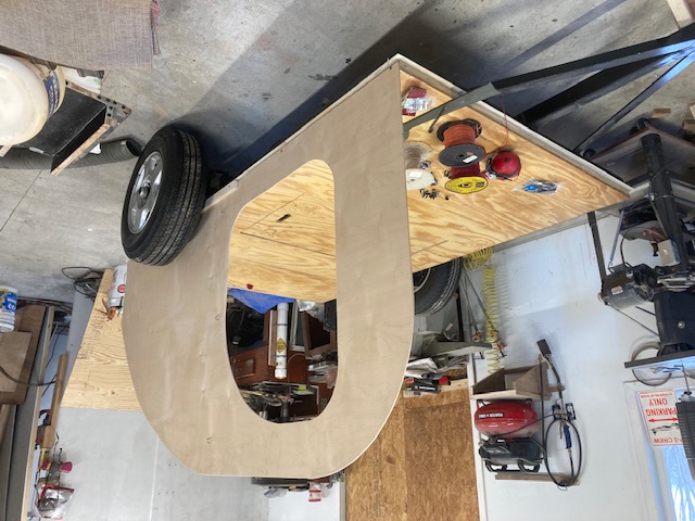

Postby Burbs » Mon Mar 28, 2022 4:00 am
Here is the finished floor with 2 coats of thinned polyurethane and 2 coats regular floor polyurethane. The wall template is temporary but it showed me that I had planned for the door to be too close to the wheel so it would have interfered with fender positioning - dodged a bullet there!
Next: trailer light wiring then securing the floor to the frame with carriage bolts

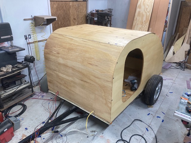

Postby Burbs » Sat Apr 16, 2022 9:04 pm
Making the most of my spring break by completing the walls then mounting them including the rear bulkheads. After marking the design using the template, I used a jigsaw to rough out the curves and remove the door. The wall template was worth its weight in gold when I used the flush trim bit to make the identical final/smooth shape on both walls.
Next will be framing the roof cross beams (including the opening for the Maxxair fan) and then the DC and AC electric systems wire runs.

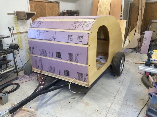

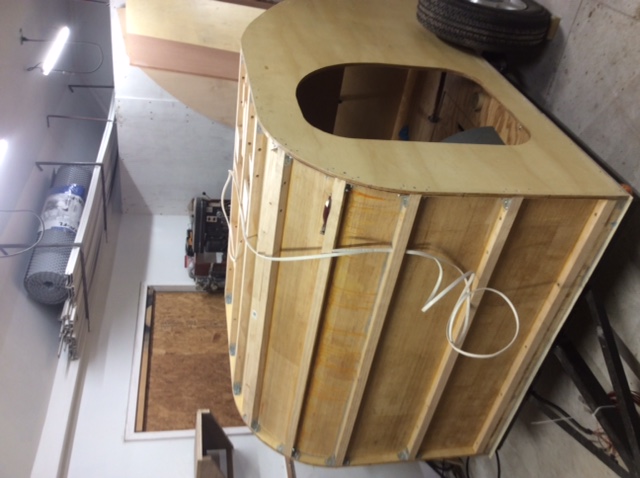

Postby Burbs » Sun May 08, 2022 8:08 am
I completed the roof spars and interior skin along with the forward storage shelf with its electrical distribution panel. Next will be the rear interior storage cupboards (also with electrical outlets) before I begin insulation.
Happy with how it is progressing!

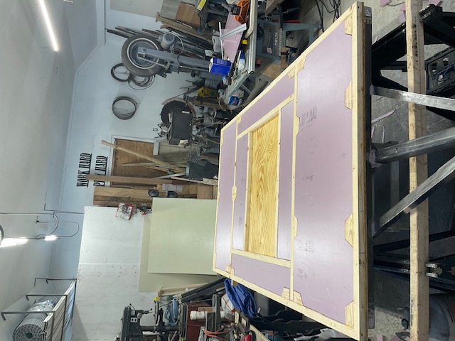

Postby Burbs » Sun Jun 05, 2022 9:05 pm
Made good progress over the last week by completing and testing all electrical circuits the installing the insulation and sheathing. I also framed in the interior cupboards. Galley hatch is next!

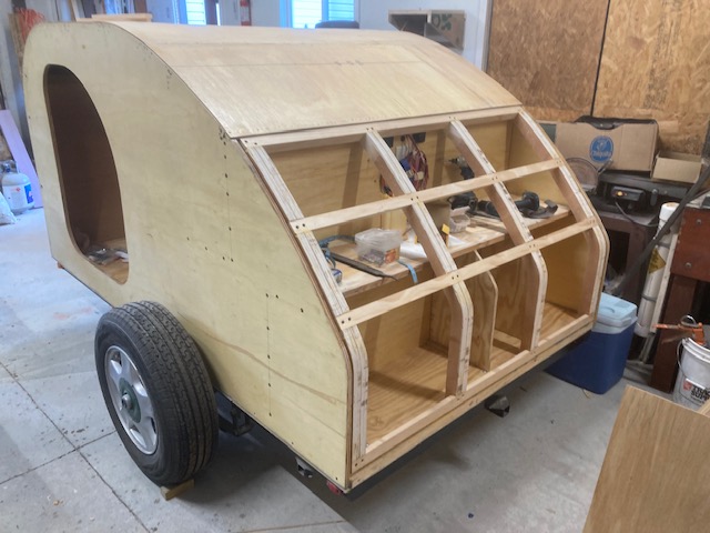

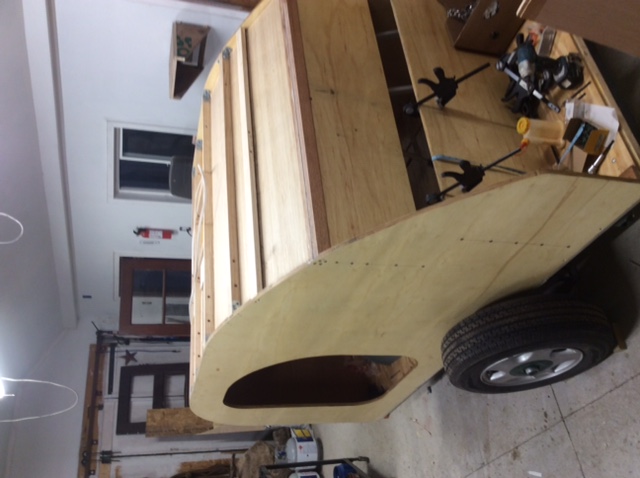

Postby Burbs » Sat Jun 11, 2022 5:12 am
I made good progress on the Good Life build over the last couple days
I completed the ribs and stringers for the galley hatch! Definitely over-built it with each rib being double layers of 1” Baltic Birch plywood. After rough cutting out 8 pieces on the bandsaw, I used a 1/2” thick template and a flush trim router bit to make the all identical. Boy did that process take some time and lots of dust! After gluing them together in pairs, I used a plunge router bit to form dadoes to accept (very snug fit) the stringers. Assembled with TB2 and decking screws for a strong structure.
Going to run wiring and add the locking mechanism this morning then add the outer skin this afternoon.

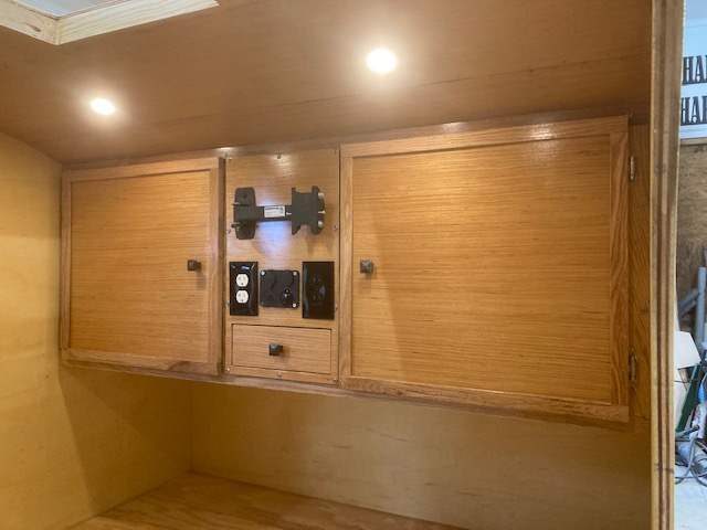

Postby Burbs » Mon Jun 13, 2022 3:27 pm
The interior is mostly complete now as I finished the rear storage cabinet and mounted the TV swing arm. The drawer is set up with a hinged 9x12 inch mirror that tilts up for access to makeup, brushes, etc.
Aluminum arrives tomorrow so it’s time to make the Good Life Teardrop pretty and watertight!
