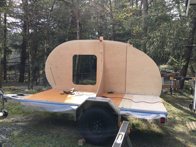

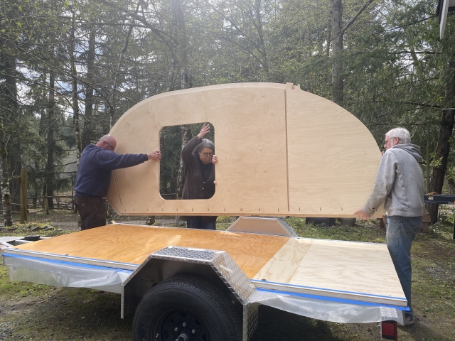

Postby VanIsledave » Sat Apr 16, 2022 8:56 pm
After lots of prep and planning we finally got the walls up on our TD.
We recruited some help as the walls are getting heavy AND we have to lift them over the fender.
So we had kind of a modified barn raising followed by smoked brisket and beer.
It was a good day!
Nice to finally reach this milestone.

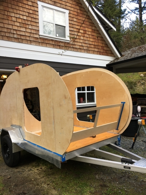

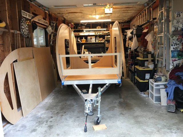

Postby VanIsledave » Fri Apr 22, 2022 11:32 am
We've been at it this week but progress has been slow.
We've poly'd some of the bits that will be covered up in subsequent steps. Yes, it might be overkill but we lived on a boat in a previous life and really like to have things sealed as much as possible.
We've built the shelf in front of the forward bulkead.
168919
And we laminated together a 2 X 2 spar for our galley hinge.
168920

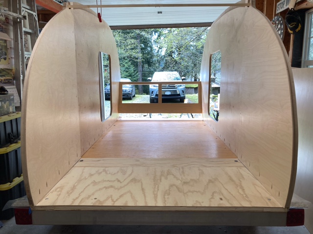

Re: D&D build (Walls up!)
Postby VanIsledave » Sun May 01, 2022 12:04 pm
We're in between major tasks and are waiting for a couple of electrical components to show up. We should see them by Wednesday (we hope!)
Once we have them we should be able to finalize decisions about interior cabinetry, wiring runs and a couple of other details. In the interim we're still making progress.
This week we fixed my blunder on the back wall. We spliced on an additional strip to give us the needed height. Didn't come out too bad.
169022
We dry-fitted the wall, scribed the roof angle and cut it to length.
169021
Then we added some holes along the bottom, ran some adhesive into the dadoes then dropped it into place. Feels really solid.
169023
We've also made some progress in determining the height of our basement and have ripped some long scrap to the correct width.
Looks like a nice day so we may work on the subfloor this afternoon.
169025
