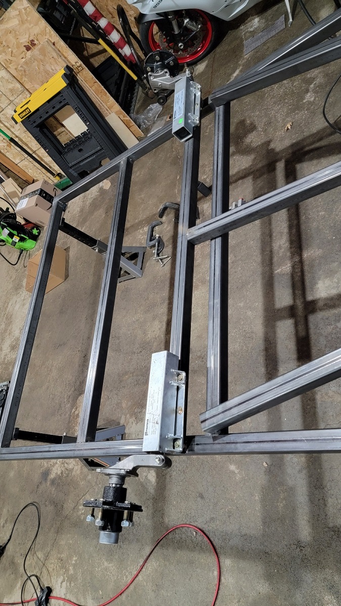

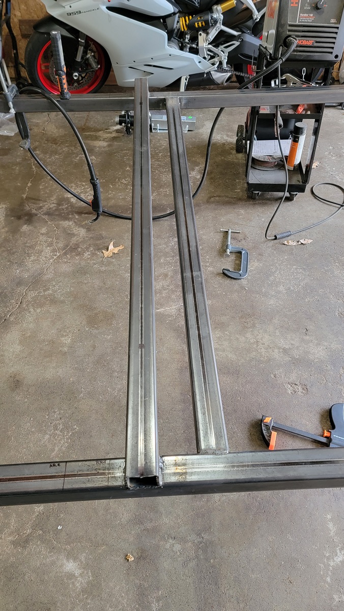

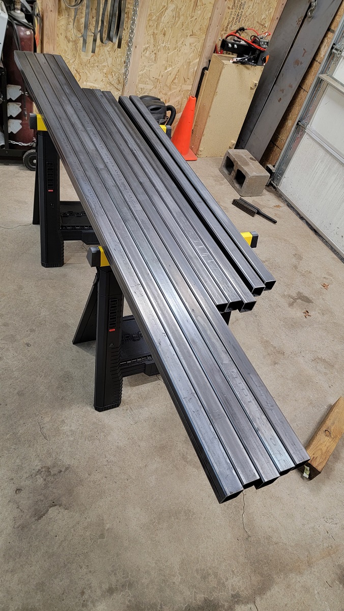

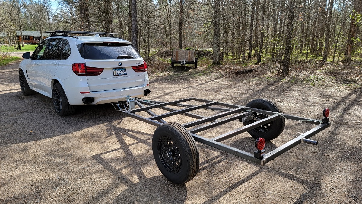

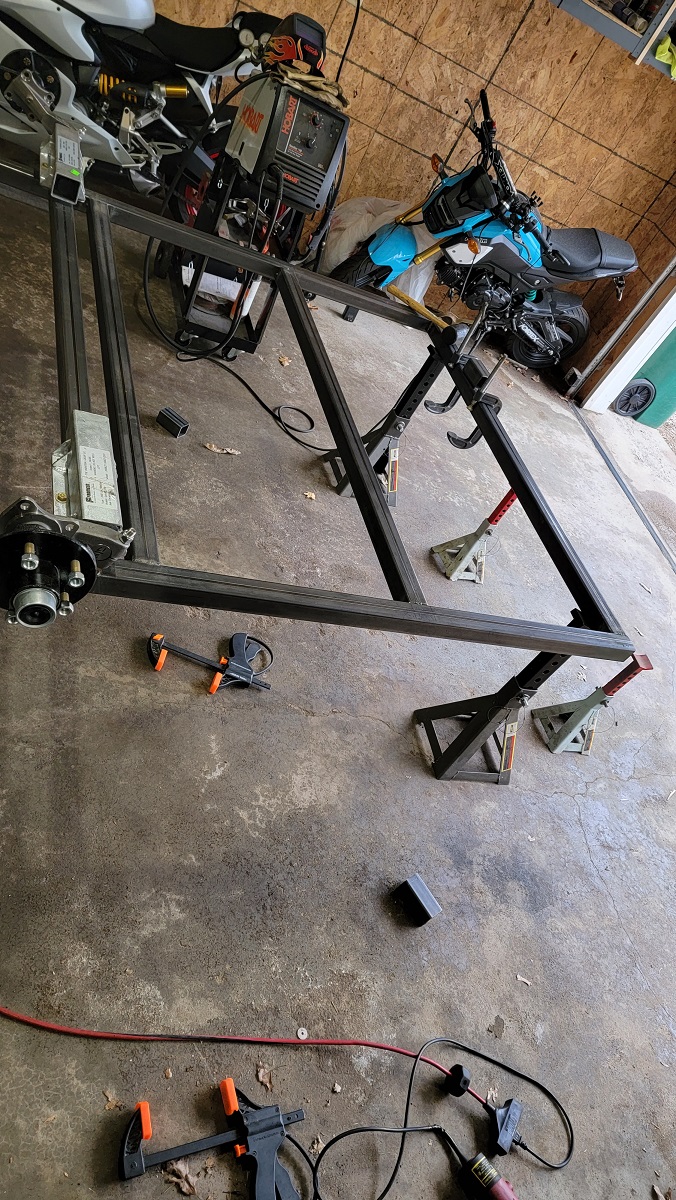

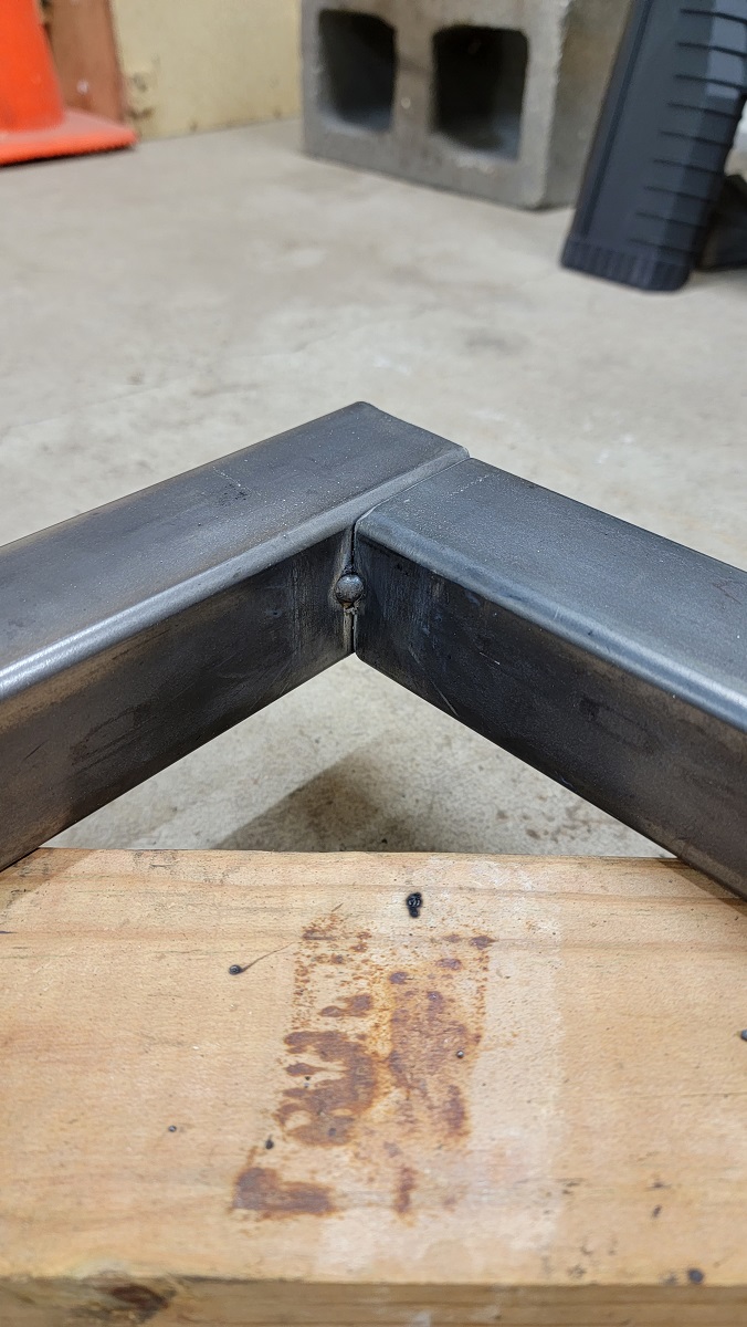

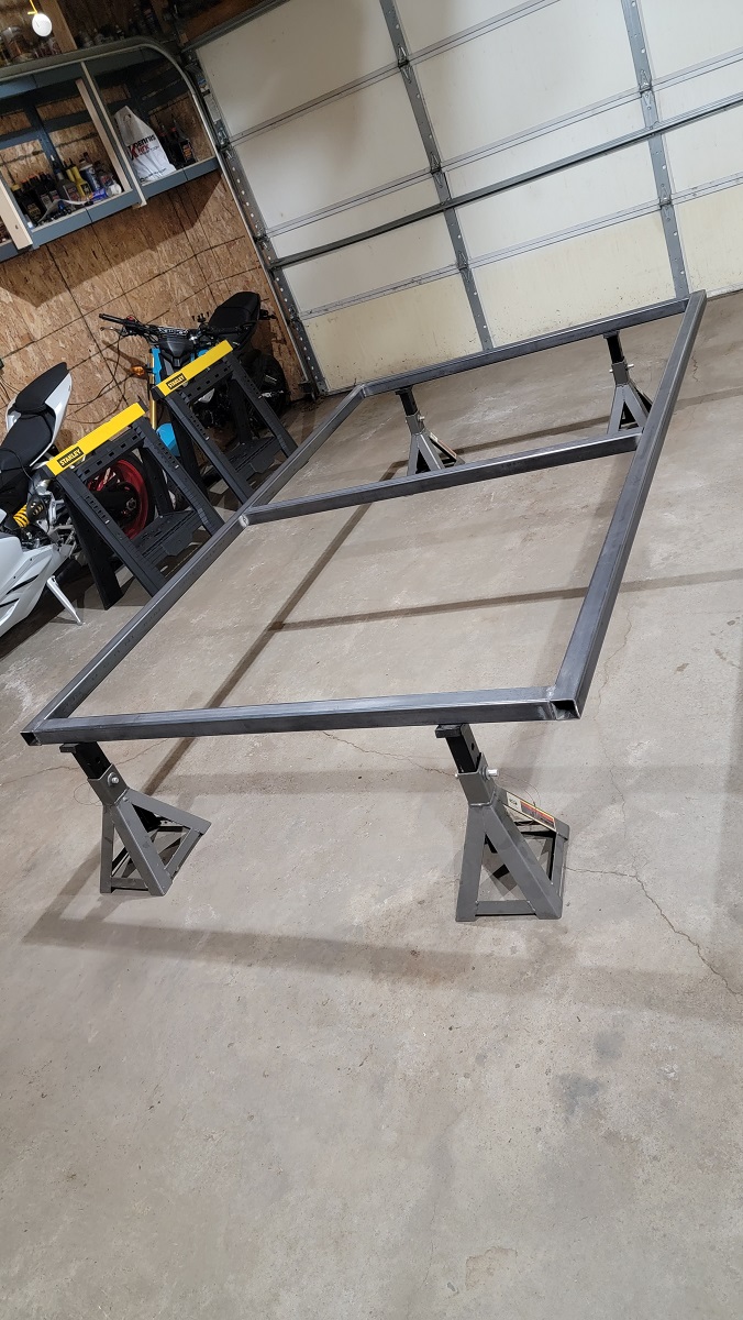

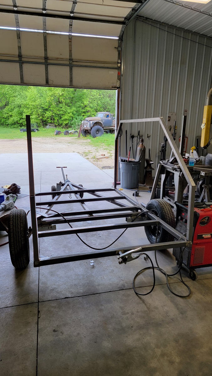

Started on the frame. I searched and searched for a 5x8 trailer to build off, but all I could find was drop gate utility trailers that would have been $1,000+ before modifications for a used one, so I decided to build one instead. 2x2 .120 wall steel tubing with Flexiride 2,000# Torsion Half Axles. 2x2 .120 is probably overkill, but I wanted to make sure it was sturdy and robust enough for anything off-road. I went with the Flexiride for the smoother ride, ground clearance, and adjustable ride height. I haven't completely decided on wheels/tires yet, but leaning towards Falken Wildpeak 215/75R15 on black steel wheels. With todays prices I have $536 in steel from a local shop. Another $491 for axles after shipping. I need to pick up one more cross-member piece tonight because I didn't take into consideration the axles would need their own. I fully expected to have to fight with the frame since I'm not a professional builder or welder and I'm not using a jig, but to my surprise the frame has stayed square and true after welding, I even tacked into place the tongue last night (no photos yet) and thats within 1/16th from side to side. Hopefully thats a sign of things going well moving forward.
Also don't judge me on my welds. I've seen much worse on here!

Postby 2one8 » Mon May 09, 2022 9:08 am
Apparently we can only attach 3 photos at a time...

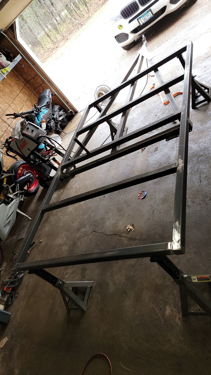

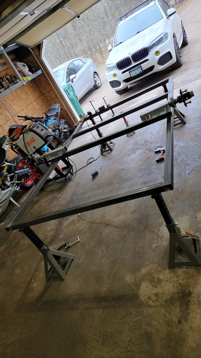

Postby 2one8 » Mon May 16, 2022 7:29 am
UPDATE:

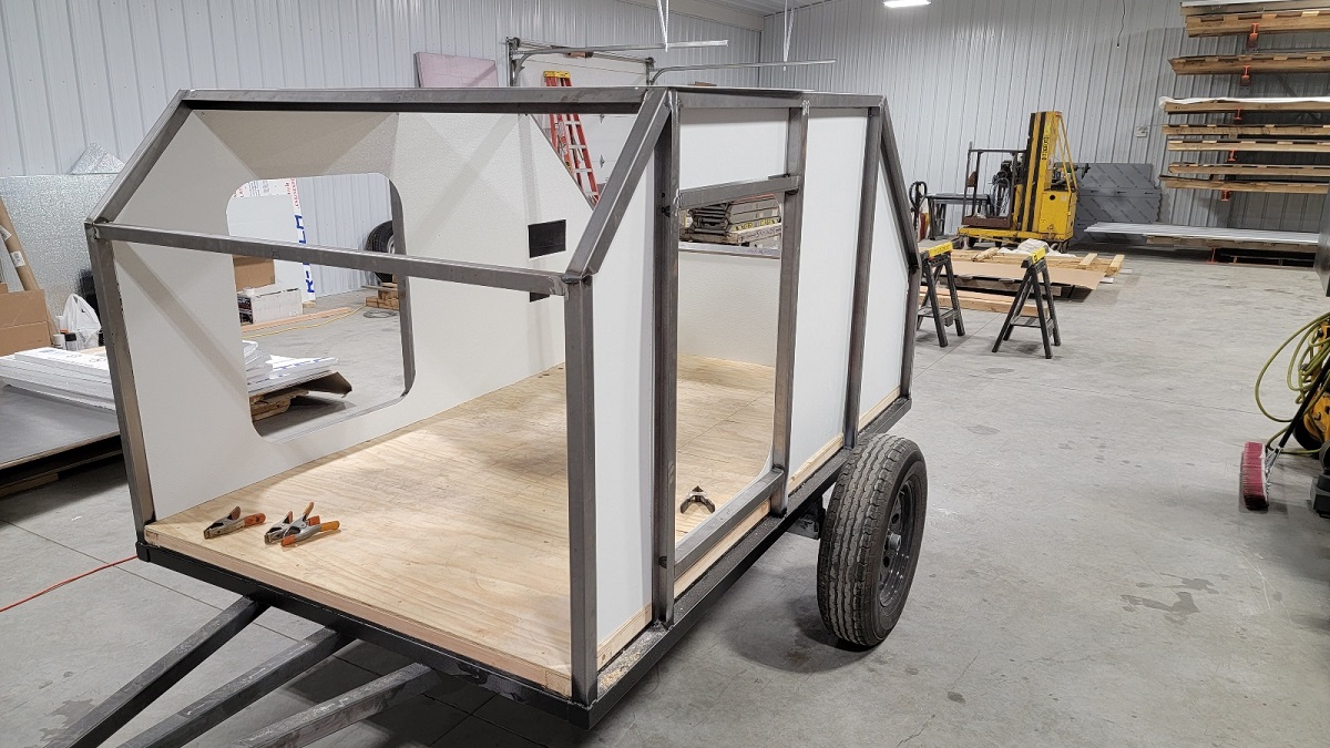

Finished the trailer frame. We will make some small tweaks to it as we go for things I didn't take into consideration, but overall it turned out pretty good. Far better than I expected.

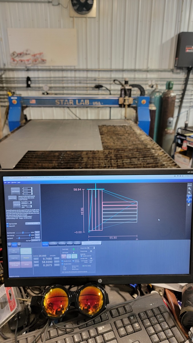

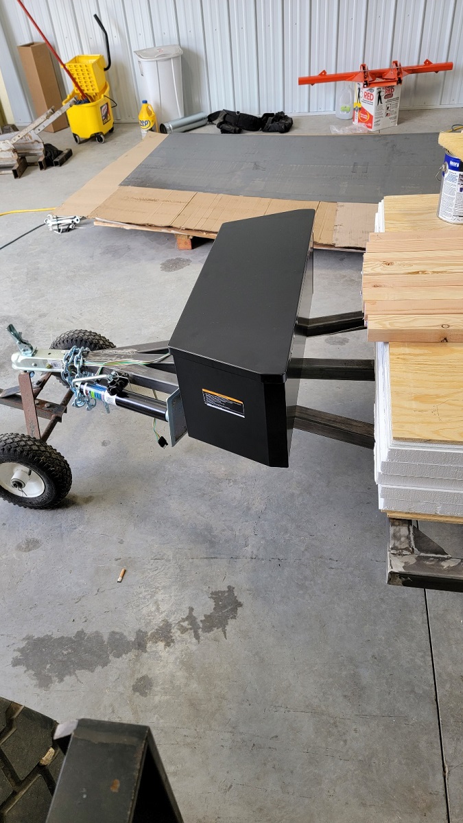

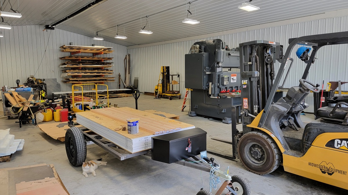

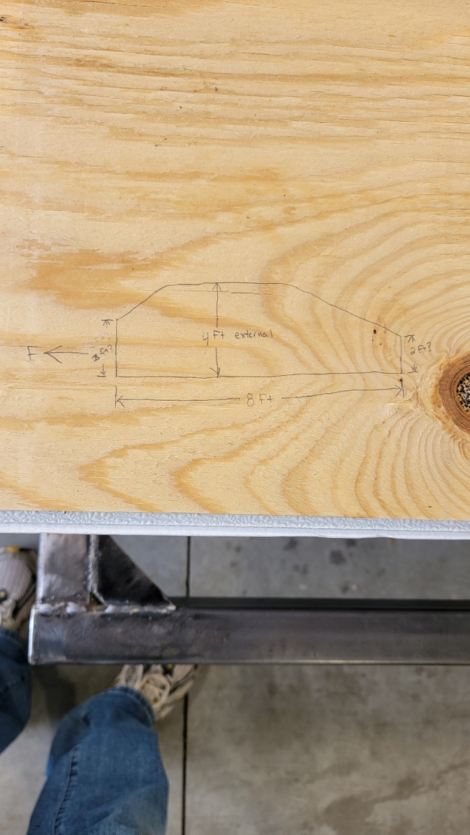

Picked up the flooring, insulation, and interior walls and drug everything 3 hours to my buddies shop. The trailer pulled very well, no noise, no vibration, tracked straight. We planned out the dimensions (we made a far better drawing than my professional wing it drawing on the plywood) and started creating the CAD drawings to cut the supports. We will use a 14 gauge C-channel design for any corners/ends that the insulation will slide into, and a Z-channel for all supports in between. The outer skinning and interior panels will be riveted to the c-channel, and we will make our own 1-piece trim to finish it off. Toolbox will sit on the tongue as shown and the spare tire will sit between the box and the cabin.
I was extremely fortunate to meet Mike years ago while riding motorcycle. We were the only two guys in the area with the same bike and just happened to meet in a parking lot. Ever since then we have been close friends. He is a specialized fabricator and welder and managed a motorcycle racing team for many years and I helped with bike setup and prep on race weekends, and now any project I can think up he tells me to bring it over.

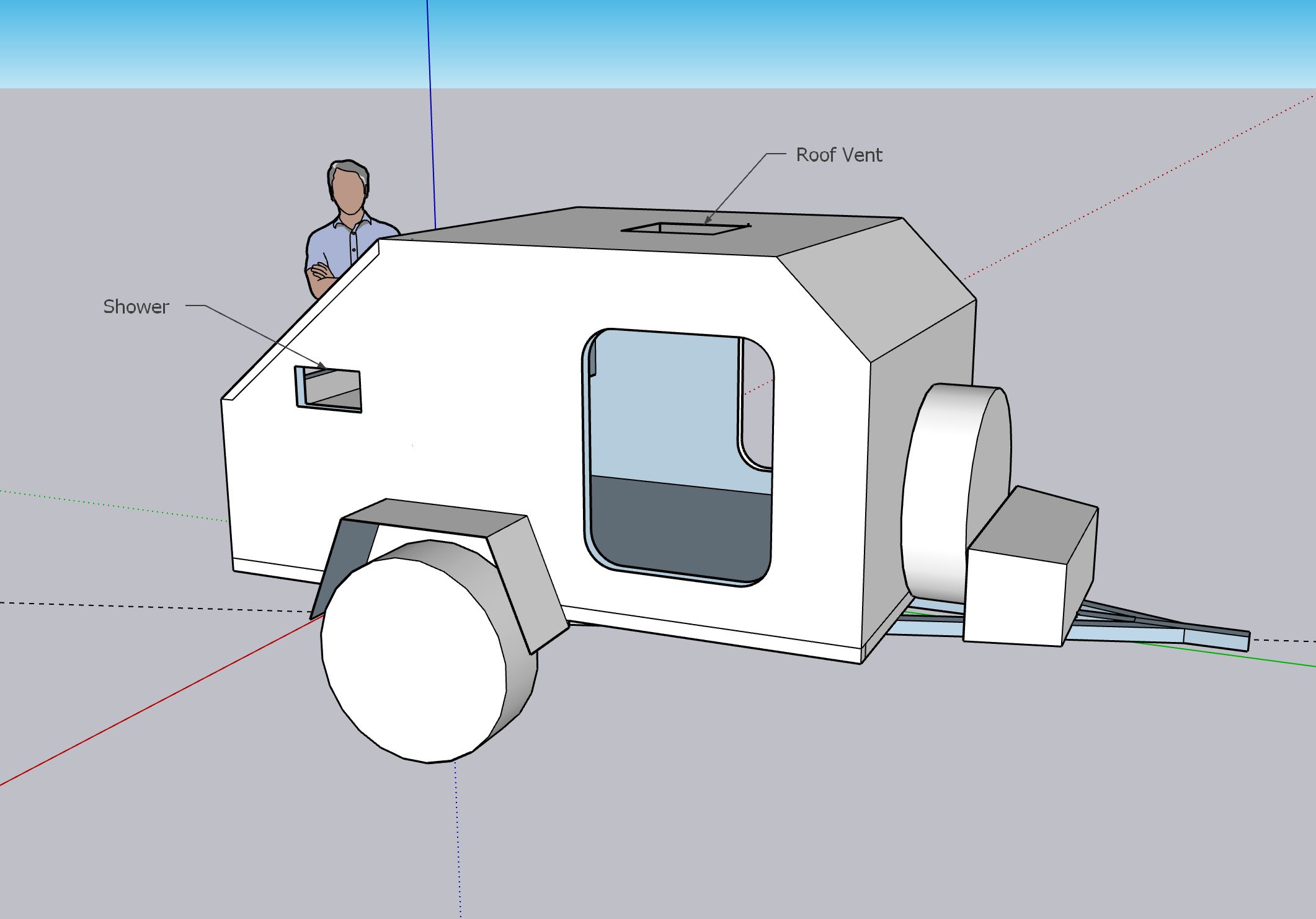

I downloaded Sketchup, here is the end goal.

Postby tony.latham » Tue May 17, 2022 8:17 am
I downloaded Sketchup...
I've worked up teardrop plans using graph paper and Sketchup. The latter really helps work out details that would be difficult --or impossible-- with paper.
Your design looks damn snazzy. :thumbsup: :thumbsup:

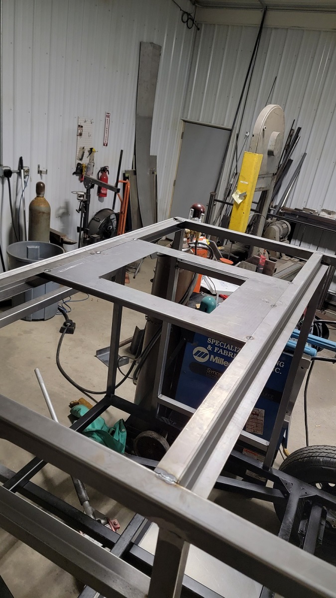

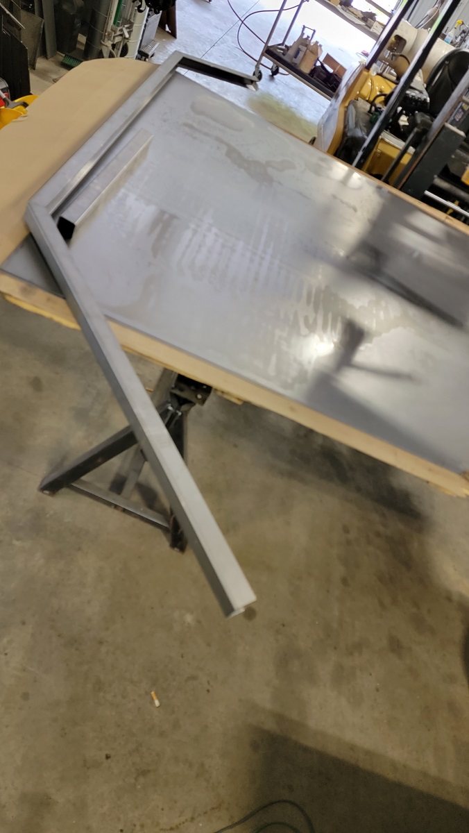

Weekend update:

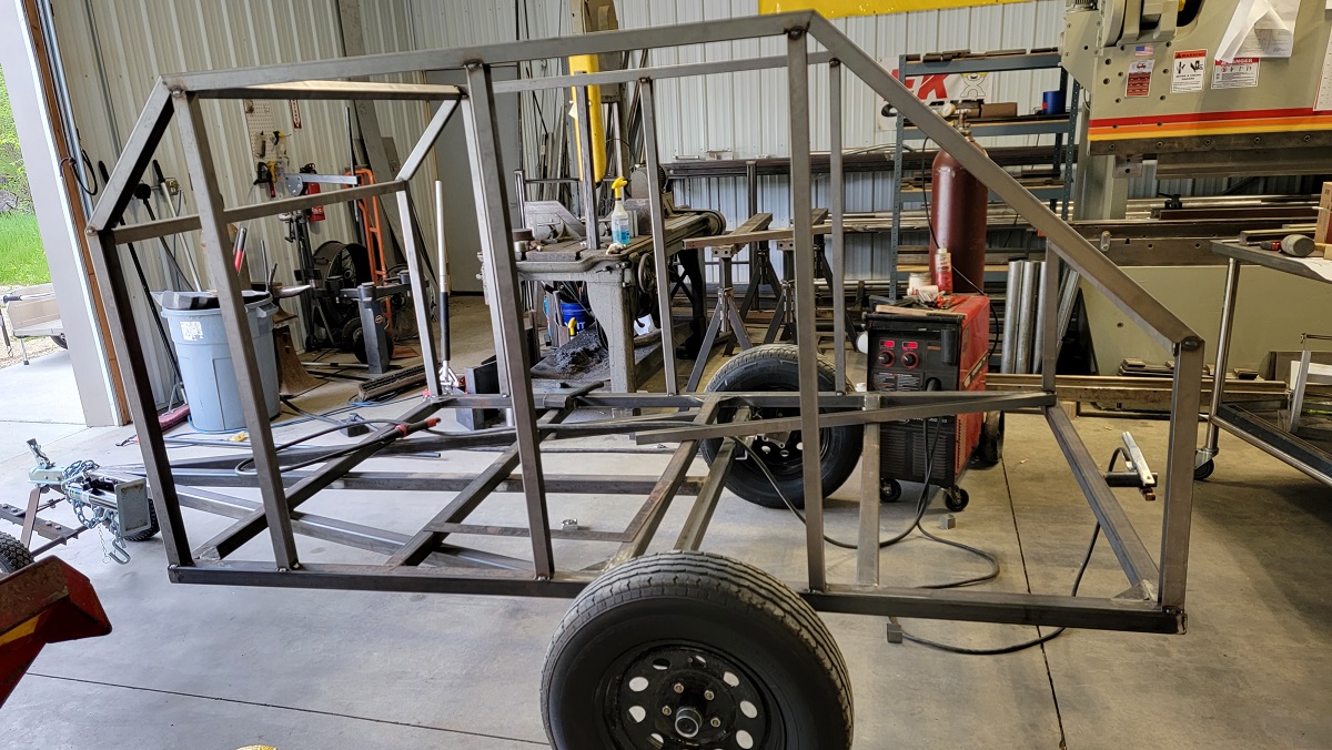

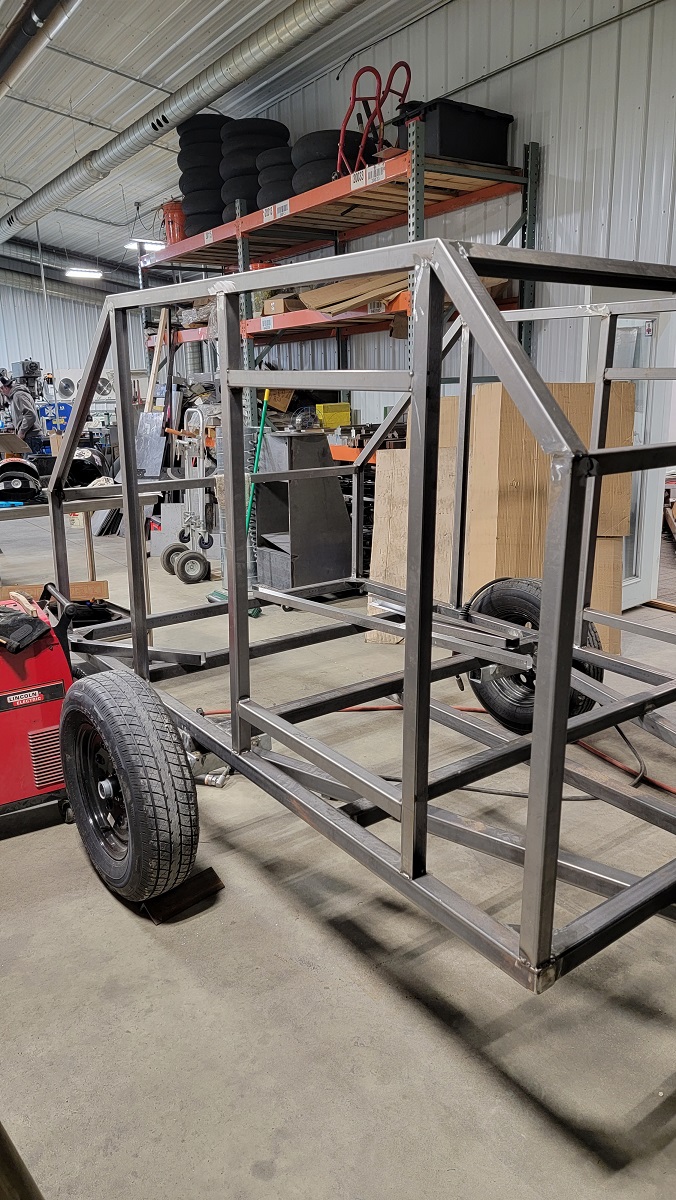

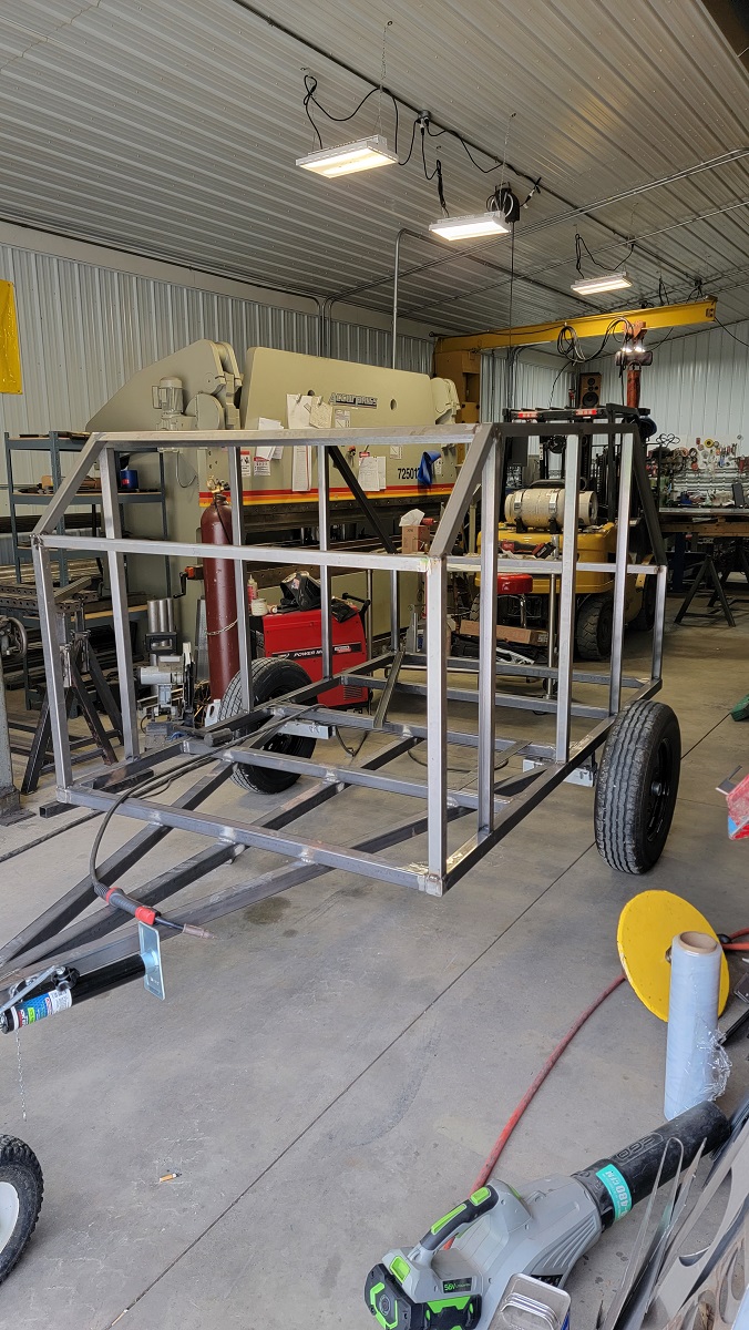

We got quite a bit done on Saturday. Received the doors, ceiling fan, fenders, hurricane hinge, cowboy shower, and water pump. We got most of the cabin framing done. Material is 16ga steel, laser cut and formed into C-channel so the foam panels can slide in the channel. We still need to add a couple ceiling crossmembers, frame in the fan, and frame in the cowboy shower.
I have a long weekend coming with Memorial Day, so hopefully we can have this finished or just needing the small things next weekend. I won't have the wheels and tires yet, so I will just continue to use the ones on it now that I borrowed from my car trailer.

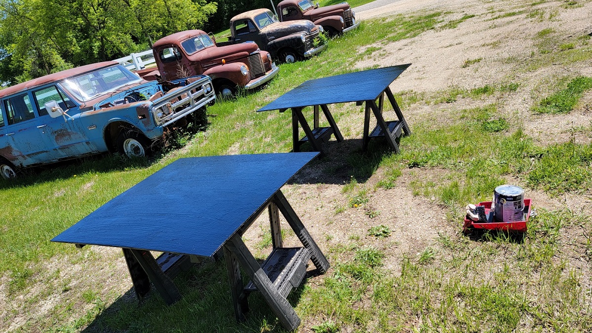

Postby 2one8 » Tue May 31, 2022 12:22 pm
Update:
It was a long Memorial Day weekend but we got some good progress done.

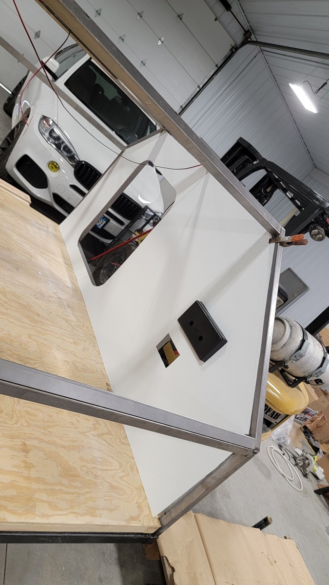

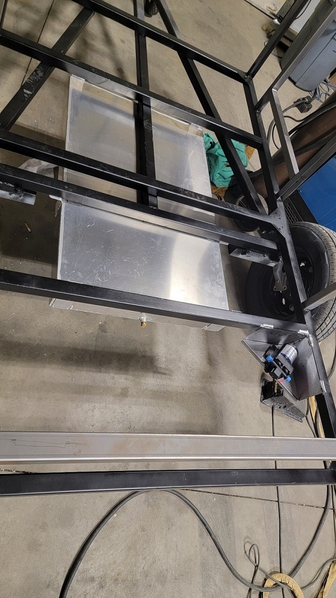

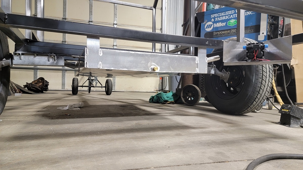

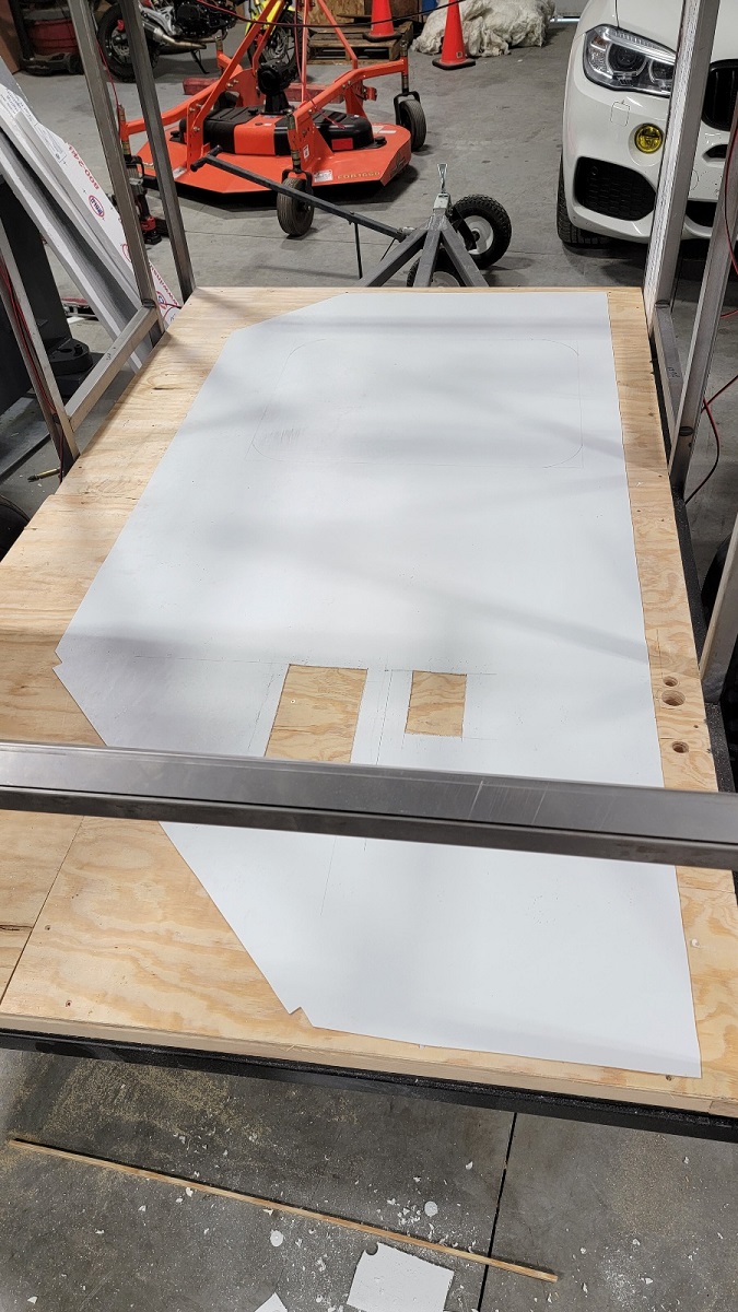

Frame was painted (minus tongue, still some welding to do there), flooring bottom layer was coated in roofing tar and let to dry overnight. Once dry it was placed into the trailer, insulation and floor framing was done, and top layer installed.

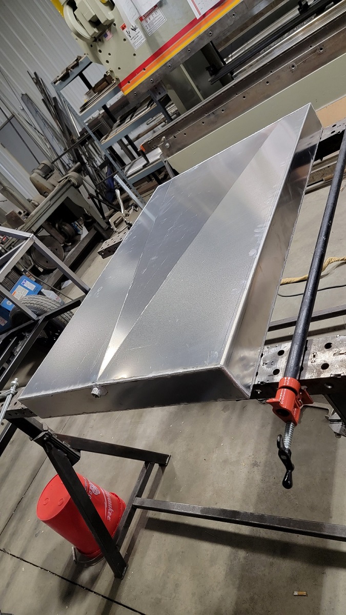

We made the fresh water tank a little larger since we had the material. It now holds 25 gal, which is likely far more than we need. Pump is mounted underneath and will get a vented cover to keep grime and what-not from building op on it. Since this is towed with my X5 we aren't too worried about damaging the tank, but if it does become a concern later on we can make a belly pan for it.
Installed the roof fan framing and started planning out the rear hatch area. I didn't get any photos of the hatch progress yet.
Interior walls are rough cut and test fit. We had to add some bracing to the ceiling to mitigate sag. I also cut the wall insulation panels and test fit them.
