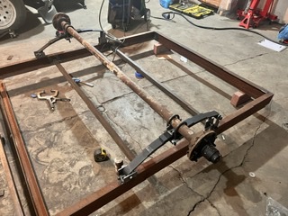

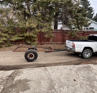

I’m very fortunate enough to find a deal wherever I can. Scored all the metal for the frame as well as an axle for $150. My biggest concern with the axle was that it had hubs to match my Tacoma bolt pattern. Should have went for electric brakes but I went with a 7 pin connector to upgrade in the future.

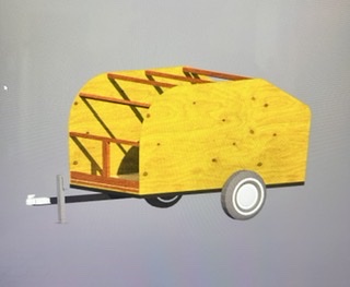

Designed the frame and pod in sketch up. A plan of attack really minimizes the 1 hour of work for every 4 hours of beer/thinking.

The frame came together really quickly. I run a sign shop in Edmonton and have access to all the tools I would need but ended up buying a few cordless tools because..well..who really needs an excuse to add to your arsenal LOL.

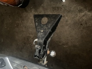

So this is where I started. An a-frame coupler for $10.

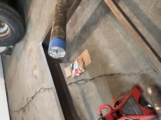

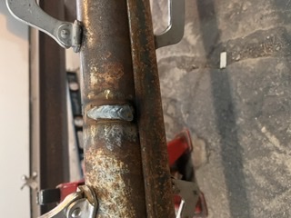

Moved on to 3” C-Channel frame with 2” channel for the crossmembers. 2”x3” Tubing for the tongue. My axle was a foot too long so why not just cut it down right? Crown in the middle pointing up. I thought it was a tube. After cutting through half way I’m thinking “yeesh, this is some thick walled tubing”….turns out its 2” solid round bar. This axle came off a dump trailer with 9000# leafs. So I cut out the center, beveled the bar really good and ran two passes over it. Slapped it and said “that’s not going anywhere”.

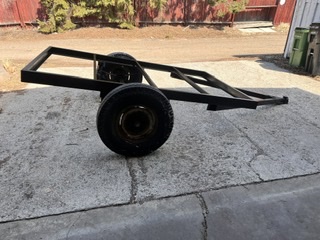

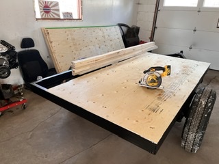

Had the frame cut and welded together in a couple hours
Edit: some have noted the axle placement and that it’s not as far back as it should be. I did the math and 8” behind center was where it should land for tongue weight. I’m not running a full galley here where that extra weight would have impacted towing.

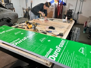

For the floor we went with a 1/2” sheet of plywood for a base (one side sealed with tremclad and rubber undercoating), 2”x2” framing, 1-1/2” foam, and then another sheet of 1/2” plywood.

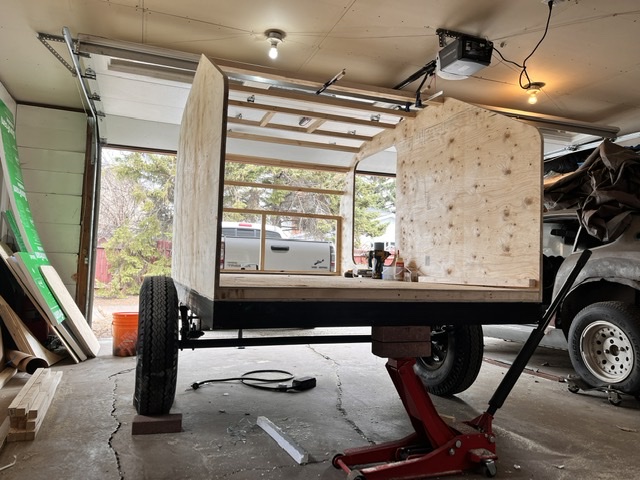

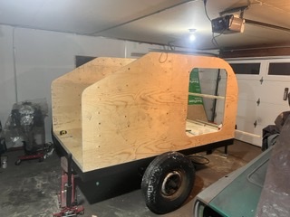

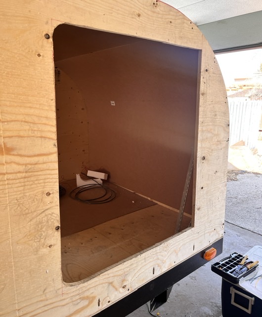

Postby Metal_Magoo » Sat Jul 02, 2022 8:15 pm

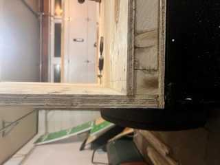

3/4” ply for the walls. They seem solid. Glued and screwed everything as we go. Can’t rave enough about a pocket hole jig.

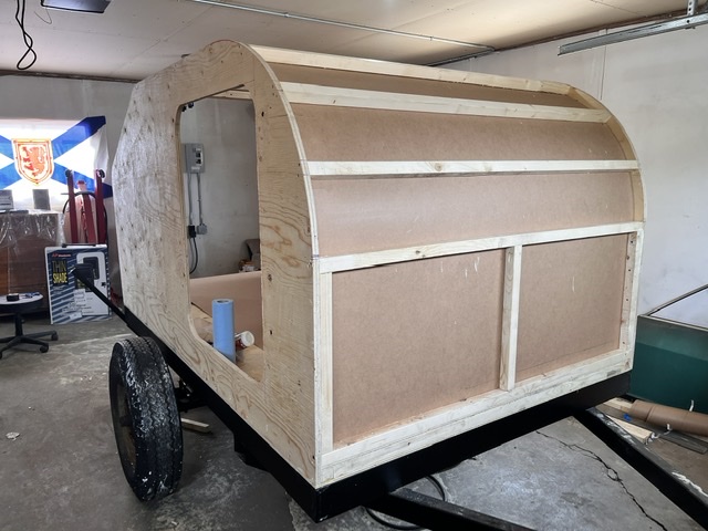

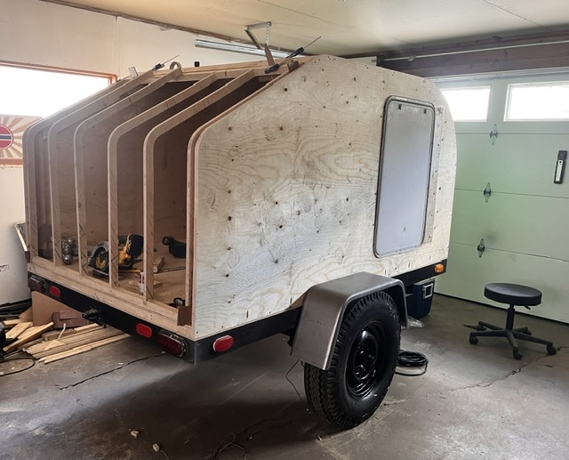

After the walls were up I started on the ceiling with hardboard and used 1/8” Baltic birch for the outer skin and more 1-1/2” foam for insulation.

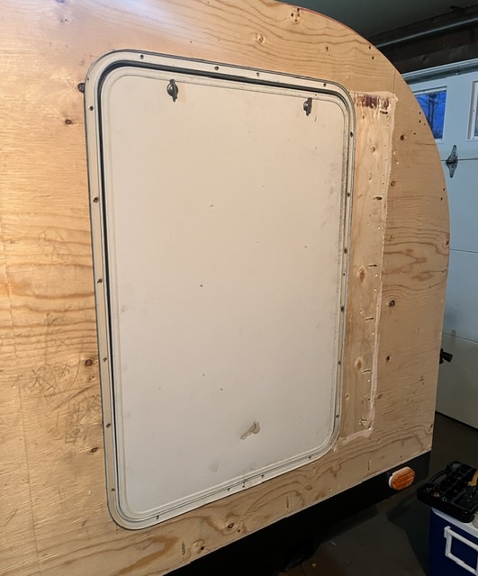

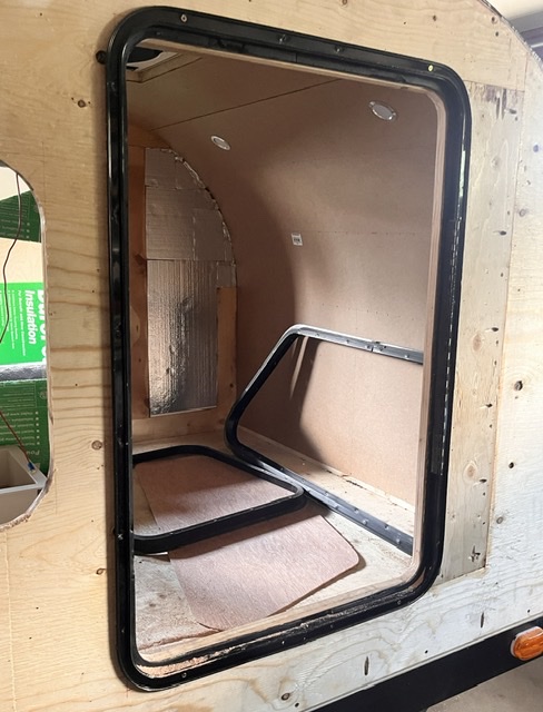

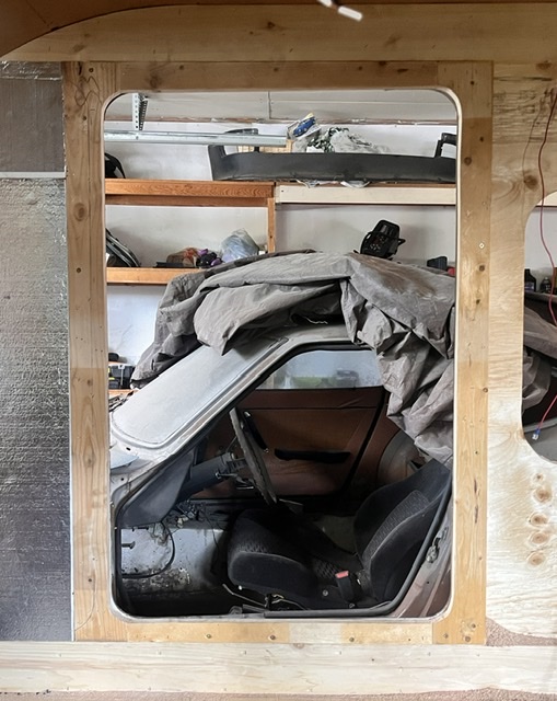

Postby Metal_Magoo » Sun Jul 03, 2022 4:45 pm
Sparksalot wrote:Nice doors. Did you find frames with seals to put you own skins into?
Thanks! I did fast forward a little bit as I can only post 3 photos at a time.
Looking at the price of doors (albeit really nice products) I couldn’t justify north of $500 per door. So, being frugal, if I can’t buy it then I build it!
Although there was already a cutout for a door I originally planned to build, I found a storage compartment door complete with the trim/frame. Only $50!! Those were the important bits to me. So now I had to fill in the oversized gap. Pocket holes to the rescue.
I framed out the inside of the door jamb with 1x4 strapping. It provided a 3/4” flange backing to put the door frame against.
Side note ** why do some of my picture post rotated 90*?

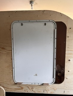

Postby Metal_Magoo » Sun Jul 03, 2022 4:54 pm
Shot of the frame and backing.

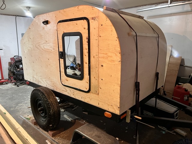

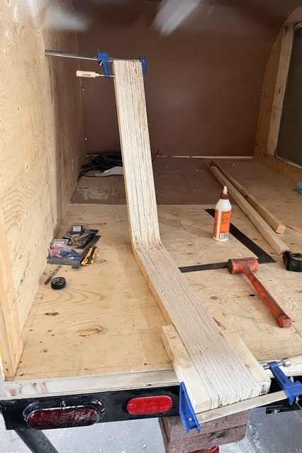

Postby Metal_Magoo » Sun Jul 03, 2022 7:10 pm
Attempting the hatch was the most intimidating facet for me. Searching this forum provided a lot of great examples. I have no clue what I’m doing so naturally I dove in head first.
Made spars from 3/4. Clamped together and sanded. For the top and bottom plate I used 2x2 with dados half way through for each spar. Glue, staple, and screw!

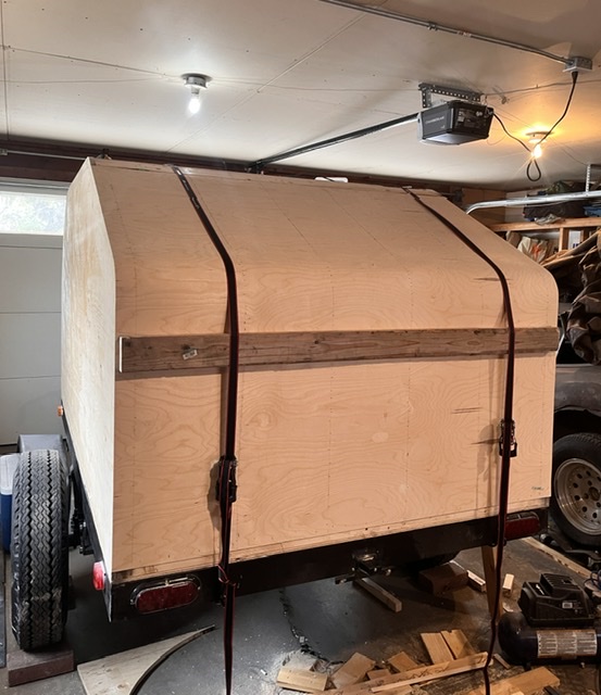

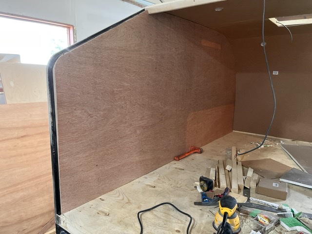

Postby Metal_Magoo » Sun Jul 03, 2022 8:25 pm
After the hatch framing was together, next was another 5x5 sheet of 1/8” Baltic birch for the sheathing. It’s really great stuff. Bends very easily around contours. This is when I wished that I had added a radius to the bottom of the pod too haha. Way too late for that.

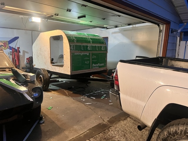

Right around this time the 5x8 trailer itself received its VIN! Kept it under 80” wide (79” fender to fender lol) to avoid extra lighting. It’s registered as a 3500# utility trailer due to the springs I used even though everything else is stupid beefy for its intended use.
Found some ash for interior panels at a Windsor Plywood, where I had bought the Baltic birch.
