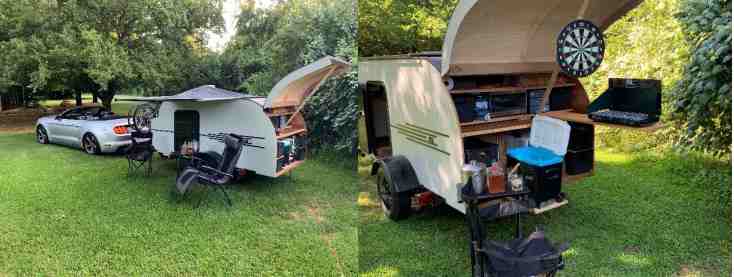

Awning
I went through many designs before arriving at the one I am sharing with you. Awnings are much like sails. They catch wind, which applies pressure to the awning mounts. Too much pressure and bad things happen. The trick is to have an awning, that allows the wind to go through it freely, minimizing the pressure on the awning mounts.
I was camping at Monahans Sandhills State Park. It was a sunny day and I had the awning up. The sky was clear, very little wind. The awning did its job perfectly. I did not think to put the awning down when I went to bed. Being West Texas, a storm rolled in out of nowhere. Huge winds, big rain. There was no way I was going outside. I laid in bed, thinking of ways to repair the roof, which surely was in the process, of being destroyed.
When I woke up the next morning, I was prepared for the worst. I went outside to check the damage. The awning was still in place. More importantly, the roof, was still in place. You could have knocked me over with a feather. It was the last thing I was expecting.
It starts with a tarp. I bought a 5x7 tarp, that just happens to match the color of my trailer. I built a frame, of ¾” pipe, that is the exact size of the tarp. I mount 2, 1” pipes, to receive the awning pipe frame. I cut these pipes to the width of the trailer roof. They are held to the roof by conduit supports, with a single screw each. There are two supports, one on each end, for each pipe. The pipe frame is cut to a length, such that the frame, in closed position, is flush against the roof edge, and out of the way. The frame has three screws that extend up. These screws are located such, that the tarp holes align.
When I get to camp, and it is time for the awning, I remove the clip that keeps the pipe frame, securely inside the 1” pipe, and pull outward. Once fully extended, I put the clip back in, to keep it in this position. I then retrieve the tarp, from the front storage, and place the holes down on the three extended screws. On the other end of the tarp, I secure a bungie cord hook, inside the tarp hole, and secure the other bungie cord hook, to the end of the 1” pipe.
This design allows the wind, to go under and around, the tarp, minimizing the pressure on the supports. It acts more like a flag, then a sail. Another benefit of this design, allows you to deploy the awning on either side of the trailer. If the view is better on the other side, simply pull the pipe frame out, walk around, and slide it in on the other side. Easy, quick, efficient.

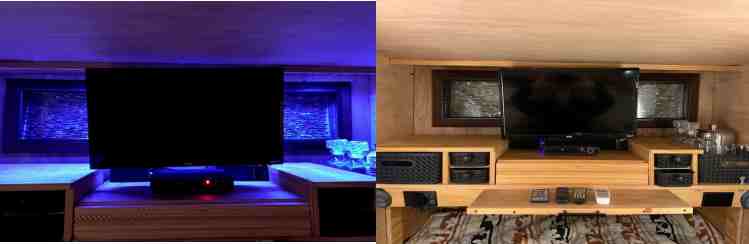

Cabin
We will now approach building the holy of holies, the cabin. This is your refuge from the storm, the mountain lions, the bears, snakes, the ex-wives, the pigmy’s with poisonous darts, the heat, the cold, the rain, the international bad guys who have searched high and low, trying to assassinate you. Let’s face it. It’s a cruel, hard world out there.
The cabin is your cocoon. In this case, it is your luxurious cocoon.
I believe this is an appropriate time to remind you of my favorite saying, “Too much, is never enough.”
Allow me to share some insights here. I grew up watching James Bond movies. As a young impressionable boy, these movies were the things dreams were made of. Well, now I am an old impressionable boy. As such, I channeled James Bond at every turn, designing this trailer.
Whether it be the two swivel, dimmable reading lights, the two library shelves of DVD’s and books, the 24 mood lighting scenarios with remote control, the swivel, extendable TV with surround sound and of course, remote control, the extendable bar with crystal decanters and ice bucket, complete with cigar caddy, the pull out service table for eating when inside, the space heater, the electric blanket, the A/C with you guessed it, remote control, the hidden laptop with wireless keyboard and wireless mouse, that plugs into the swivel, extendable TV.
Yes, I agree. Most people would say this is a lot. After all, it’s a teardrop.
But wait a minute. Let’s think about James. You have to ask yourself, what would Q provide James?
I’m not sure what Q would provide, but this teardrop, has a linear actuator, underneath the bedding, which at the press of a button, turns the bed, into an elevated chaise lounge!
Trust me, there is nothing better than reclining on your chaise lounge, cut and fit to the measurements of your body, elevating your knees, reclining back at 45 degrees, with built in pillow…while watching a movie, with mood lighting, enjoying an adult beverage, and possibly a cigar…hidden from all the super villains, out to get you.
Well…there is one thing better.
Hold tight purest! This might hurt.
The one thing better, is having two, custom made, built-in live waterfalls, fully tunable, on each side of the TV, which fills the cabin with soft, melodic sounds.
Yeah, didn’t see that one coming, huh? ;^)
So, I amend the previous statement.
There is nothing better than reclining on your chaise lounge, cut and fit to the measurements of your body, elevating your knees, reclining back at 45 degrees, with built in pillow…while watching a movie, with mood lighting, enjoying an adult beverage, and possibly a cigar…being bathed by the sweet melodic sounds of waterfalls…while hidden from the all the super villains, out to get you.
I think James would be proud.

Chaise lounge
There is a fully adjustable headboard, with four-inch foam. When in sleeping mode, this headboard folds flat against the front wall, and out of the way. While in chaise lounge mode, it can be tilted out, at any angle, comfortable for viewing TV, working on laptop, reading, etc.
Measure the wood pieces for the chaise lounge. They should be the length of your legs, and just shy of the width, of the interior trailer. Secure the two pieces together with a hinge.
The placement of the chaise lounge pieces, to the floor, is directly related to your upper body size. I find a 45-degree angle on the headboard is just about right. So, depending on your body size, place the chaise lounge pieces, where the headboard meets the floor, at 45-degrees. Be sure to allow for the thickness of the foam.
Lineal Actuator
I used a 12-inch DC lineal actuator with a two-way switch to manipulate the chaise lounge. This allows for any degree of inclination, for the chaise lounge. Attach the arm to the piece closest to the rear wall. Now attach the base of the actuator to the floor, while in the contracted position. In my case, I wired it to a DC converter, as the trailer is all AC. Hold the switch down, extending the arm, thereby moving the two pieces, to V up, underneath your knees. When arriving at a comfortable inclination, let go of the switch.
You are now relaxing in a queen sized, chaise lounge!
At bed time, simply lower the bed to the flat position, and move the headboard flat against the front wall. The sleeping area is actually bigger than the queen-sized bed in my house.

You’ll recall our discussion about splash.
Buy a wood framed picture. The opening of the picture frame, should be large enough, to see the ‘rocks’ of your waterfall, yet small enough, so the plumbing does not show. Take the glass, from the picture frame, and attach it to the wood structure, that contains the rock tile. The glass, deflects the splash, into the drain, right along with the rest of the water. Being glass, and mounted on a slant, so as to direct the water, becomes invisible, behind the outer veneer, that holds the picture frame.
You mount the picture frame, on a piece of wood veneer that looks nice, therefore framing your indoor waterfall!
Hopefully, it will look something like this. The mood lighting, going across the top, behind the TV, is positioned such, that it highlights the water feature, without glare on the glass.
You can set the mood lighting based on the type of movie you are watching.

Galley
Now, some design features of the galley.
There are two shelves positioned in the middle. The two middle shelves are separated by ¾”. There is a table top, that is held underneath this bottom shelf. That table top comes out, and is placed, between the two middle shelves. This design doubles the kitchen counter space, allows the table top to be on the left or right or in the middle, depending on where you want it, at the time.
There is an upper shelf. That shelf is positioned, just enough below the top of the hatch, so that it can be accessed. This shelf will hold the power station, paper towels, cloth towels, and the vanity slide out.
You will recall, that earlier in these notes, I teased that there was another item, in the galley, of special interest.
Wait for it. Wait for it. Okay, here we go.
That item, inspired directly by James Bond, is a hidden, spring-loaded device, when activated by the press of a button, will dispense his-and-her blowguns, from the roof of the galley.
Oh MAMA!! Did he just say… Yep!
Okay, be honest. Tell me you wouldn’t want the ability, to summon weapons, by the press of a button! Every teardrop should have it. And it adds less than two pounds to the build. It’s freaking genius. Eat your heart out, Mr. Bond!
In all seriousness, I like to play darts. The difference is, I use blow darts. Sooo…why not have those bad boys coming out from their secret hideout in the roof?

There should be a clearance in the middle of the shelf, for the blowguns to be deployed. The left side of the shelf will hold the vanity slide out, towels, etc.
