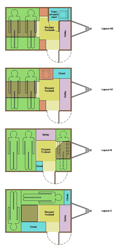

Ok I pulled the trigger and brought home a harbor freight 4' x 8' trailer. I have 3 custom size windows ordered. I have also been collecting bits a parts for the build.
I plan to follow the plans pretty closely for layout B, the one with the double bed in the back and a table/bed in the front. it a few ideas for how to make the table change to a bed and some storage ideas. I will try to keep a build journal here.

Postby cdlwingnut » Sun Nov 06, 2022 2:10 pm
The plan is to use layout B. the weight limit is the limit of the harbor freight trailer. the plans say I should come in well under it. and my own calculations using the shipping weight of the materials I plan to use indicate I should have weight to spare if I keep the build light. I also plan to skip the dropped floor, I know this will mean not being able to stand up strait but I think it will feel less confined and be simpler and stronger without it.

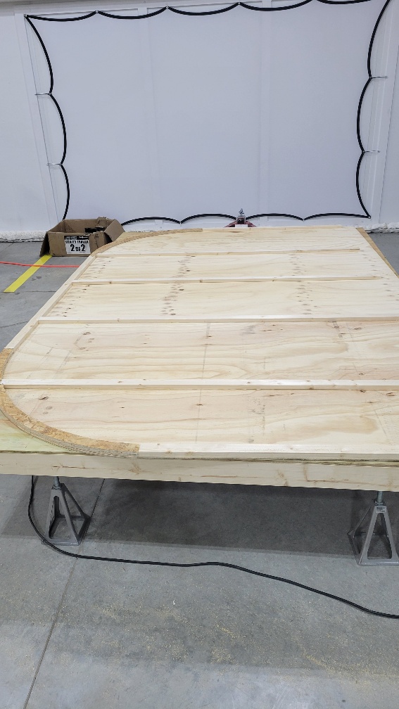

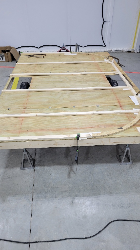

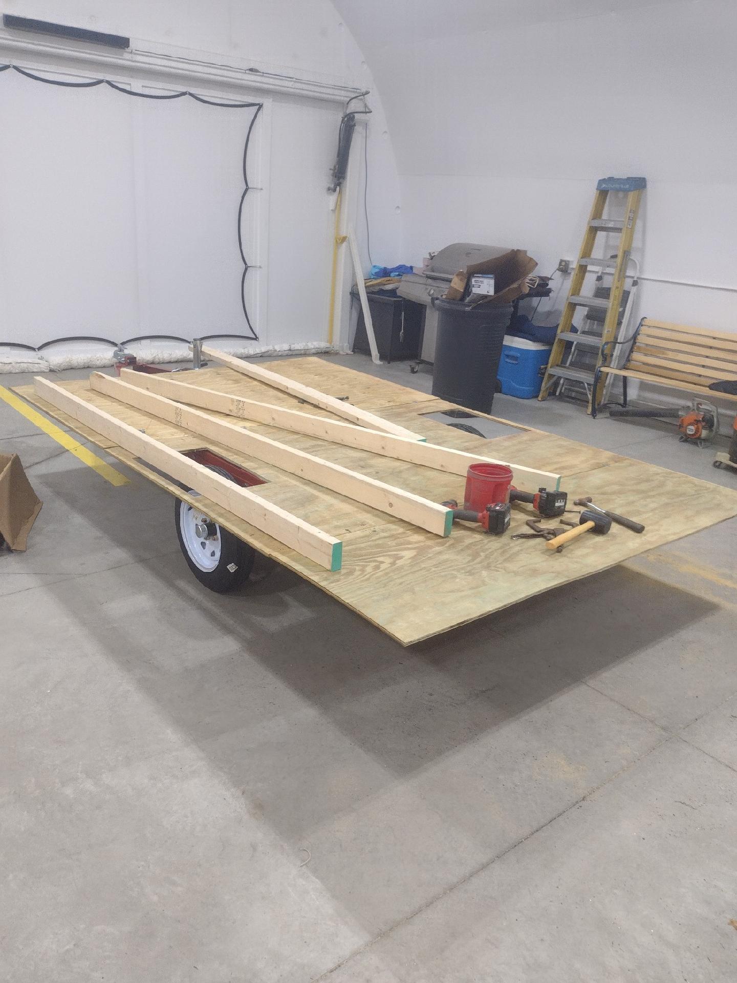

Postby cdlwingnut » Sat Nov 19, 2022 10:05 pm
Construction has started, the frame is assembled and the floor is cut and on.

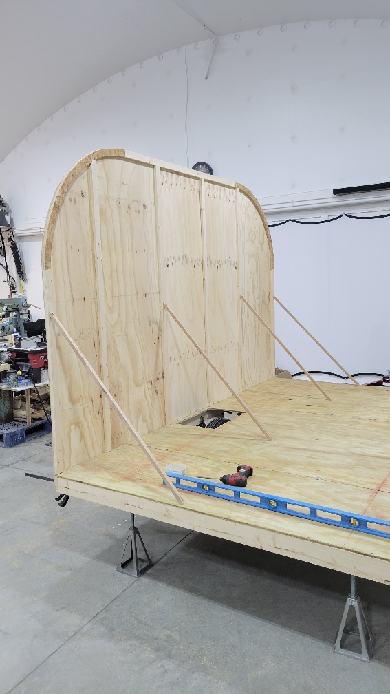

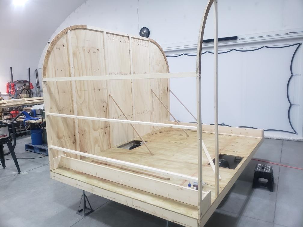

Postby cdlwingnut » Sun Nov 27, 2022 7:04 pm
Been tinkering away, The supports for the floor was added I used 1x3 boards on edge. One wall was framed out on the deck of the trailer, they plywood skin was then glued and stapled to the frame. The wall is now up with some temp braces. I glued and screwed and stapled it to the floor and the bottom 1x6 boards that the plans have as the main strength.

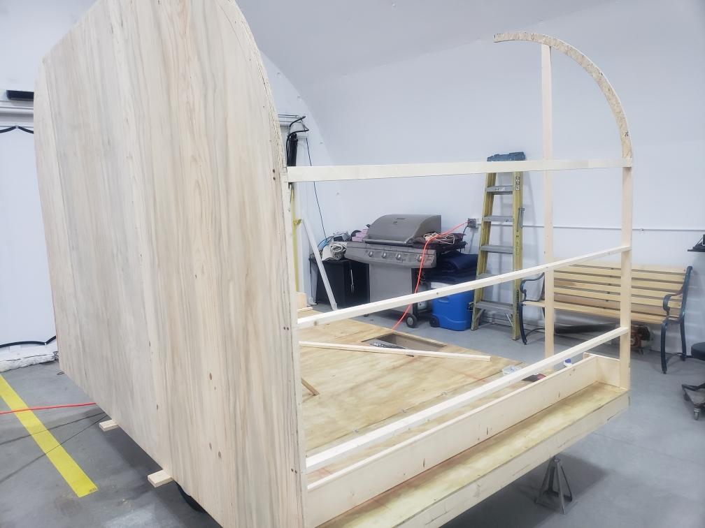

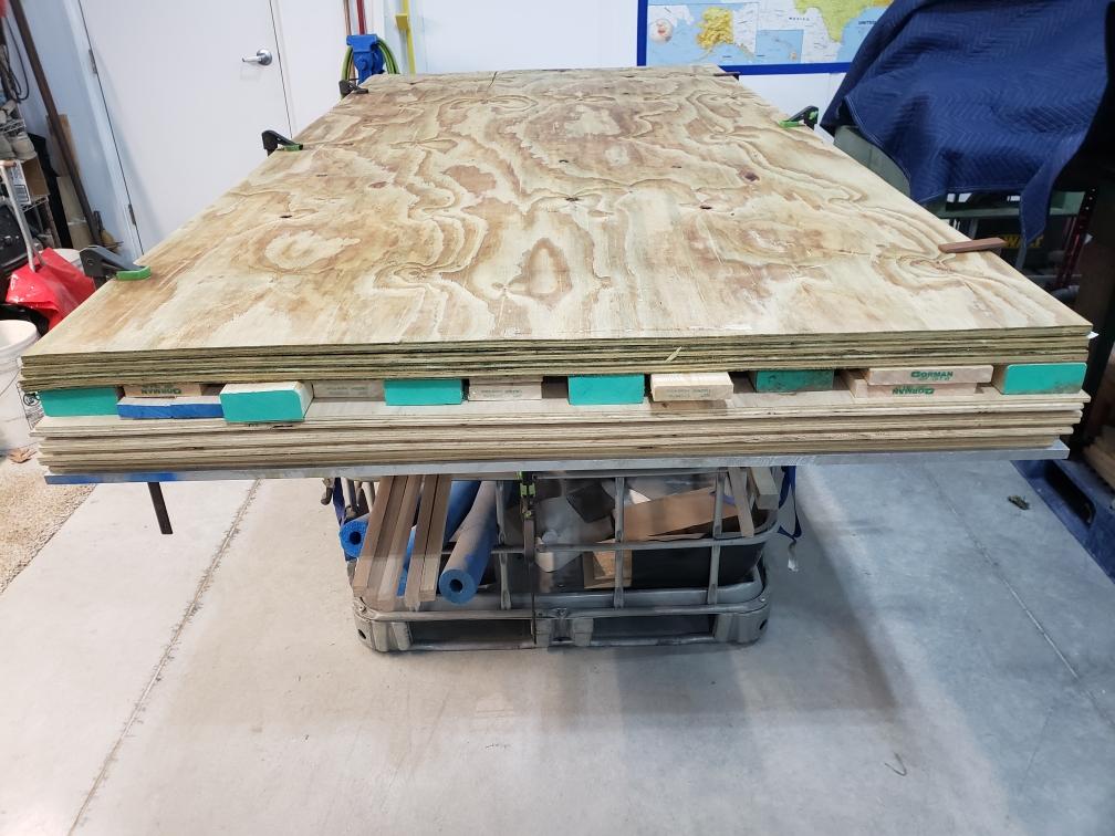

Postby cdlwingnut » Mon Nov 28, 2022 7:36 pm
The frame of the second side is starting to go up. seems to be working well building the frame first. We will see when it comes time to skin it though. I've been using pocket screws and glue to hold the parts together.

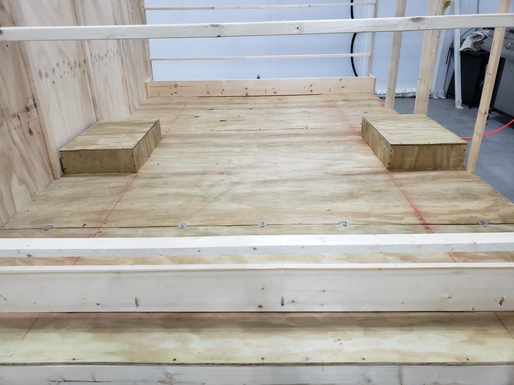

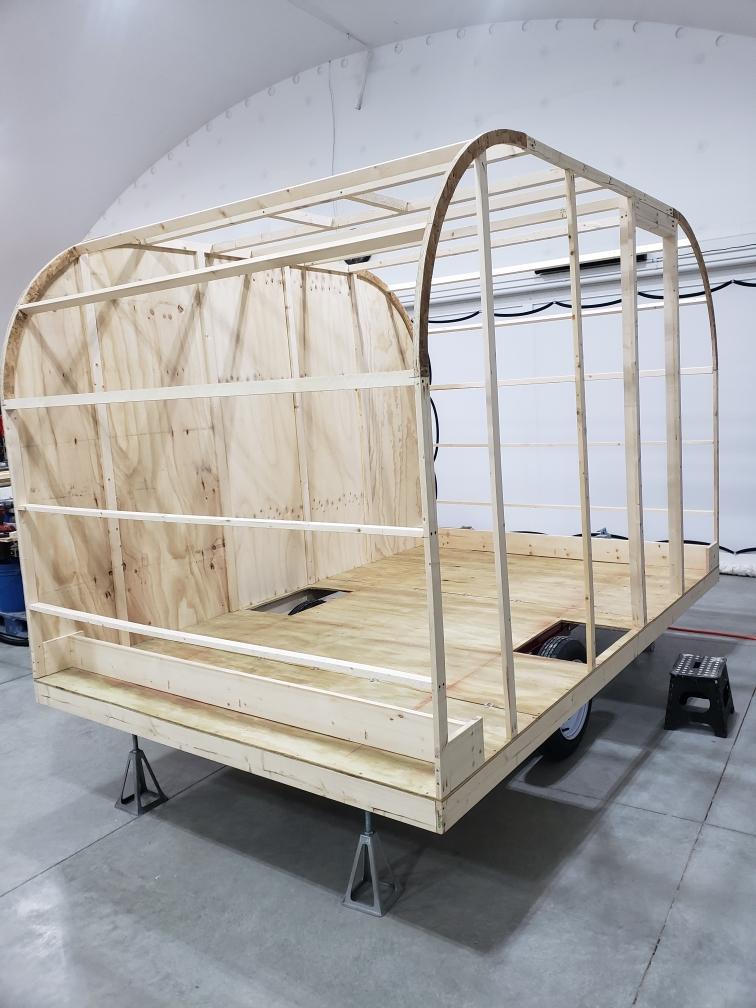

Postby cdlwingnut » Thu Dec 01, 2022 6:11 pm
the frame is up and the wheel well boxes are built.
this is coming together really well

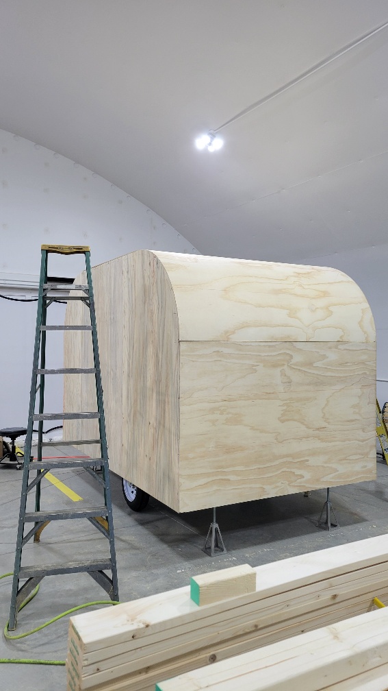

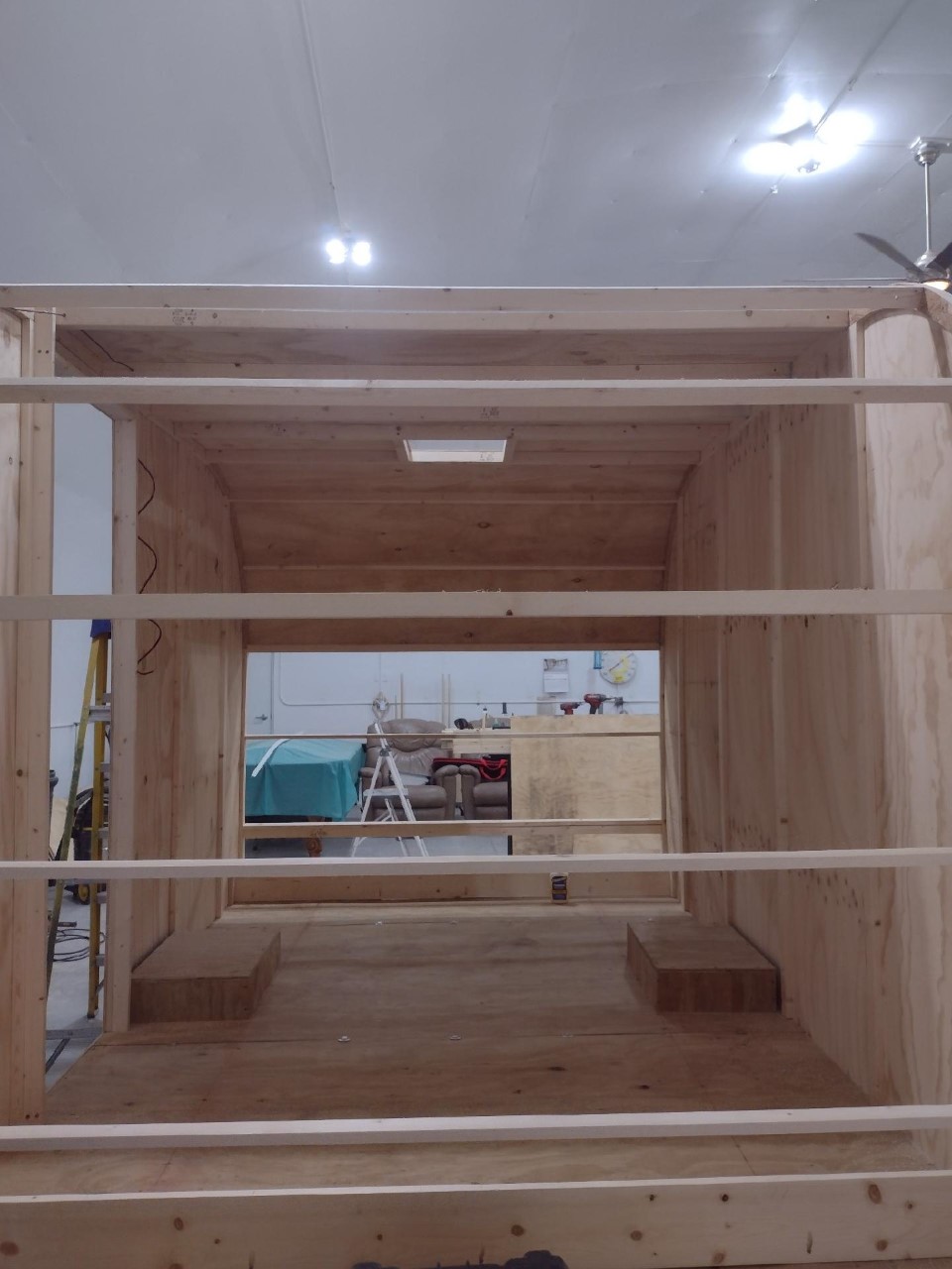

Postby cdlwingnut » Sat Dec 03, 2022 8:09 pm
drilled some holes for wires then got most of the outer skin on. looking like a camper
