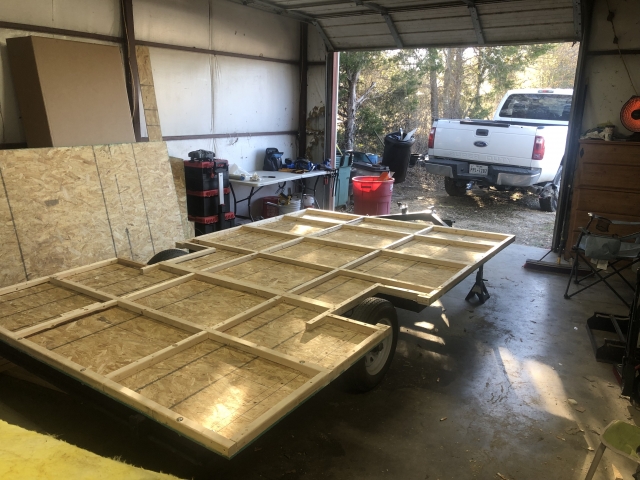

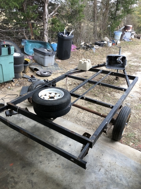

Hi all, I'm new here. I'm about to embark on a standy build, so here begins my journal.

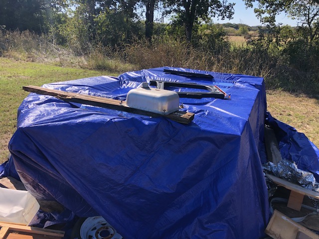

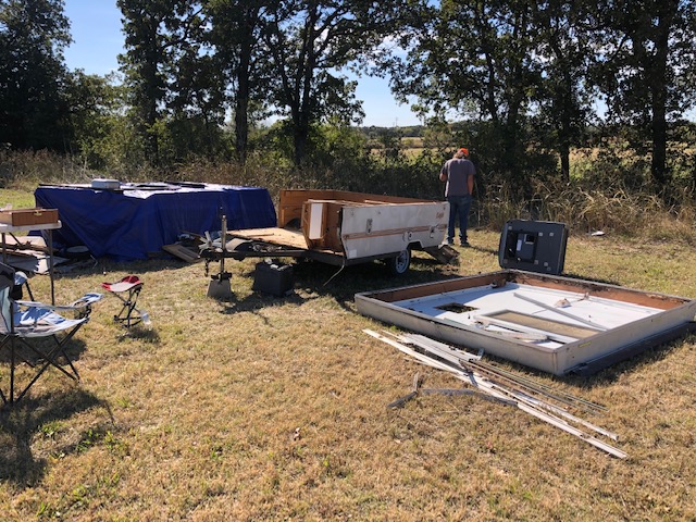

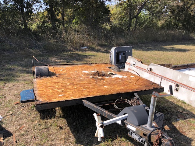

I'm building on an old popup frame. It measures 10'9" x 6'5" (excluding tongue). In this image, it is on sawhorses and covered in a tarp. I'll post better images once I have it in the shop. I bought this bare trailer for $150.

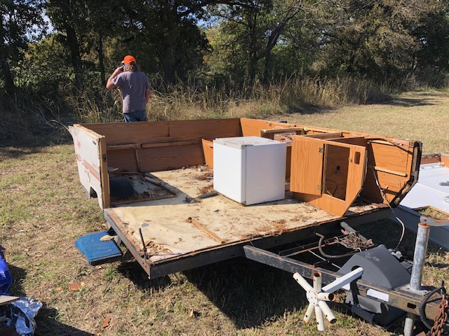

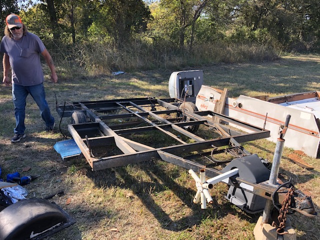

I also purchased a damaged smaller popup for $300. I'm salvaging the stove, refrigerator, heater, water pump, etc. and swapping axles between the trailers. The following pics show us tearing down the smaller popup.
The scary looking dude in those pics is Timmy, a good friend who is helping me along. I'm renting an area of shop from his landlord to do the build in.

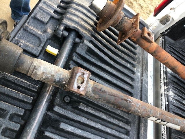

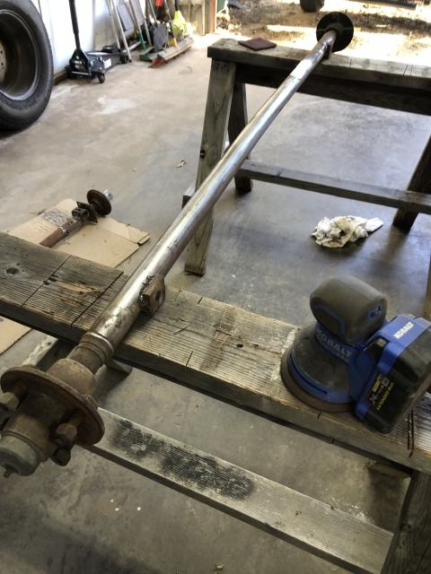

And here is a pic of the axles, we're relocating the mounts to swap them out.

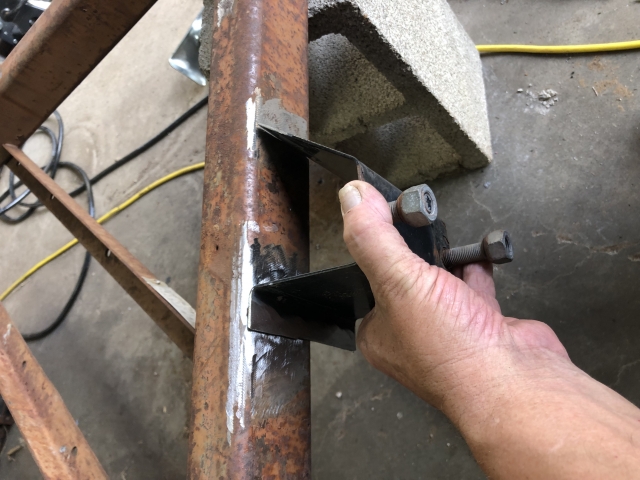

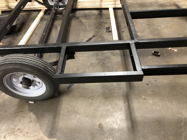

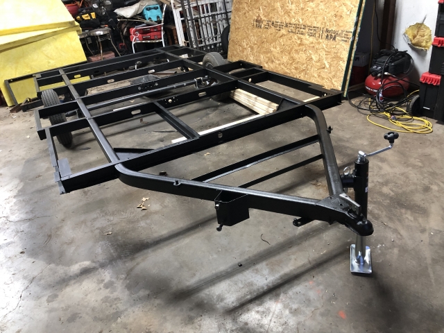

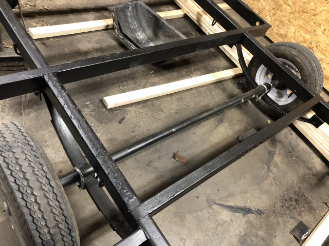

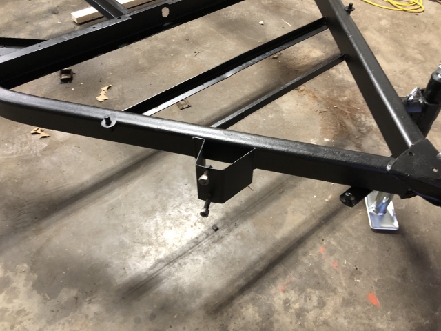

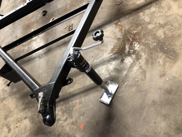

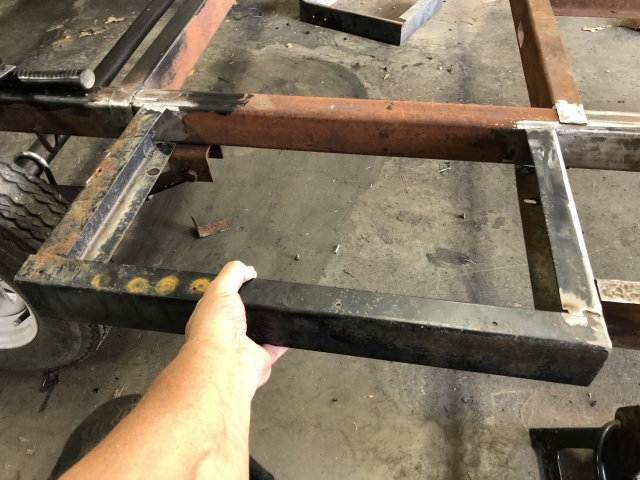

I've been busy working to get my trailer frame & suspension ready, then working to get my floor built.
Got the axle from the 'newer' popup welded, moving the mounts to fit my build trailer. Here I'm prepping it for paint.
Axle installed, trailer moved into the shop.

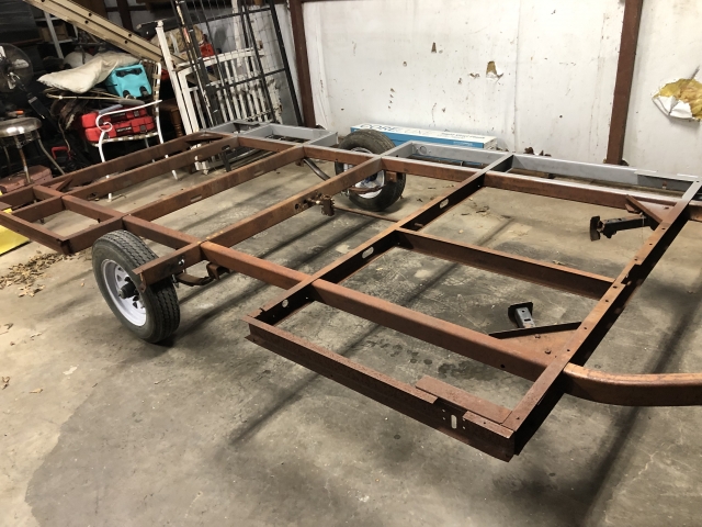

Next, I cut all the "wings" off the newer popup trailer frame in order to use some on the build trailer. Here is the extra, newer, smaller pop-up trailer frame that I have left over. This is after I cut away the "wings"
The doorstep from the newer popup will be mounted below this section, which is also replacing a bad section of my build trailer.

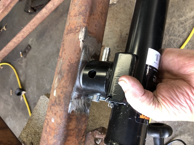

Mounting spot for my new swivel jack.
Mounting spot for spare tire holder, I got it from the sacrificial popup and modified it to go here.

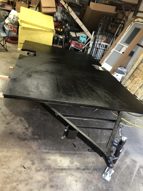

Once all the welding was done, I prepped and painted the build trailer using truck bed liner for the finish.

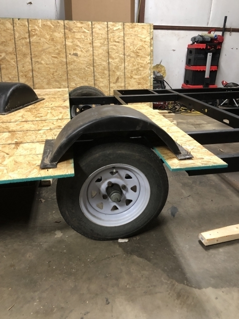

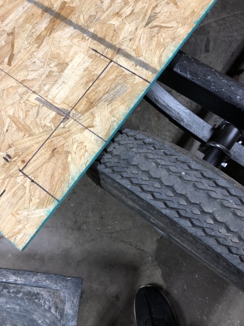

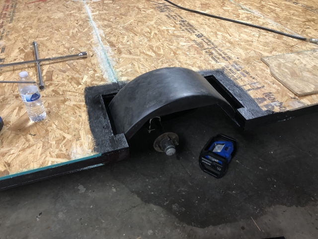

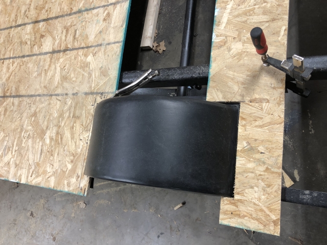

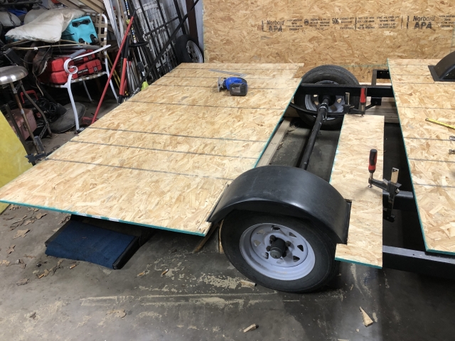

I had to do some mock-ups in order to determine how I would use the wheel wells of the sacrificial popup. Took several swings at it until I was satisfied how to proceed.
I'm a happy man, I love my life!
My Gunter Li’l Standy build journal:
https://www.tnttt.com/viewtopic.php?f=50&t=75291
Mark Gunter
Posts: 76
Images: 211
Joined: Tue Nov 29, 2022 9:54 am
Location: Cleburne, Texas
Re: Gunter L'il Standy Build

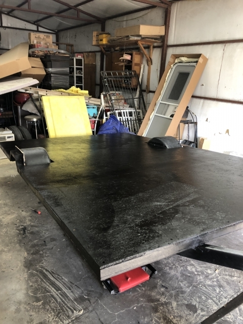

Postby Mark Gunter » Sat Jan 21, 2023 8:31 pm

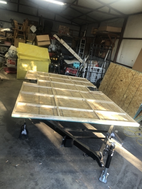

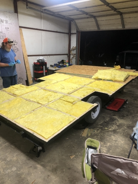

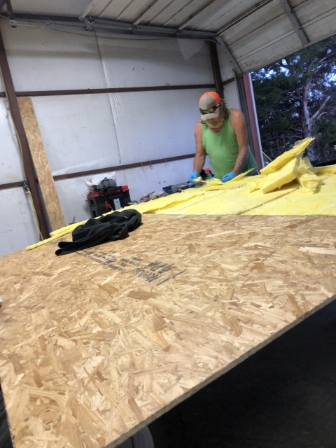

With the wheel wells figured out, it was time to start the floor. The floor is 7'3"x11'6" ... 3 sections ... so I "tacked" them together to build the framework.
Then I disassembled and flipped them over for waterproofing. I permanently assembled then used several coats of bedliner. I got help to flip it back in place once all this was done.
I bolted it to the frame with 3/8" bolts, washers, lock washers. Then it was time for insulation.
And wheel wells
Finally, I got to put on the first coat of bedliner before leaving town on a job.
I KNOW, I know, give me flak for using OSB on my floor. Believe me, I know. It was worrisome. I know better. But my funds are limited. And once I got the floor bolted, and went back underneath, and caulked every seam, and did some more bedliner touch-up, I am pretty confident that my foundation will last the 5 or so years I plan to use this camper ... so sue me, lol.

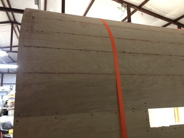

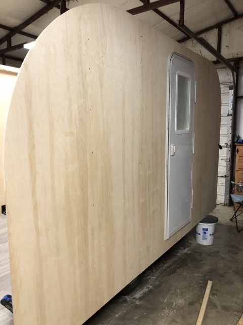

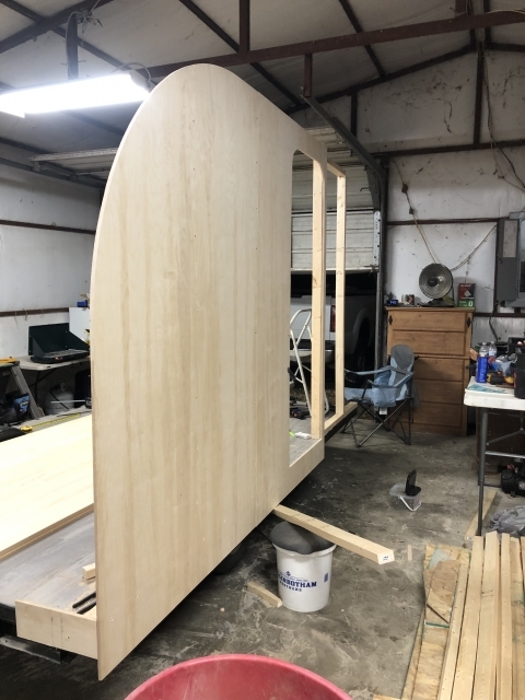

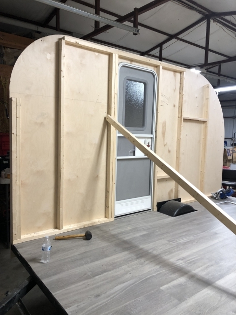

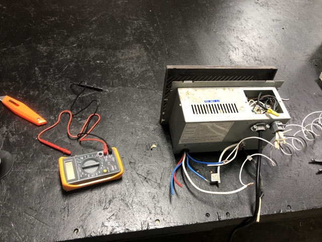

I've been pretty busy since my last post, I've got the side skins on and the front skin, and working my way to the back on top now. For some strange reason I couldn't get many photos to upload to my laptop from the phone, but here are a few.

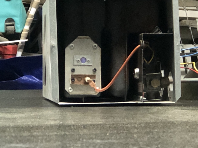

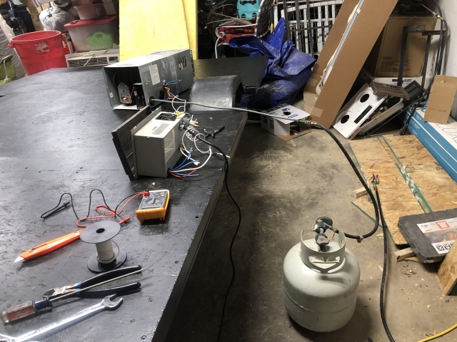

First, I tested the power converter and the heater that I salvaged from my sacrificial popup. I had to be sure they worked before thinking about where I'd install them. Everything tested out fine.

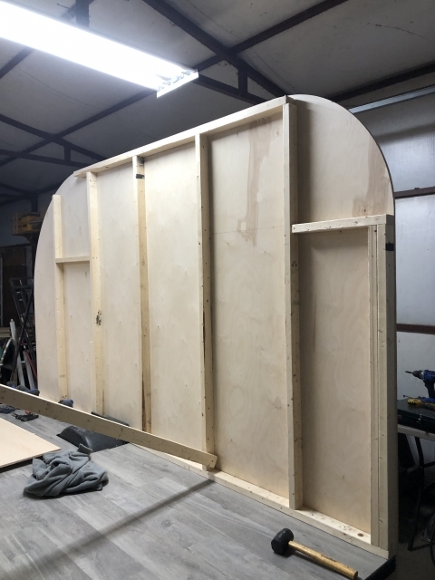

Then began the more exciting stuff. First, cut front panel radii and match them up properly, fine tuning with belt sander, the front gets a 24" radius and the back gets 40". Then I began to frame up the right side, installing panels from the back forward.

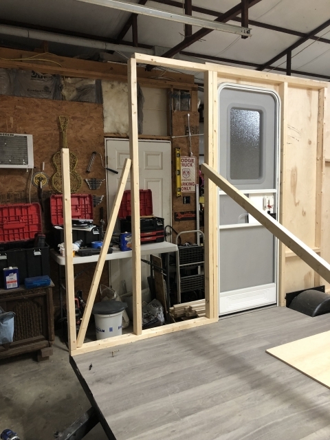

I had to figure, frame up, and cut out panel for the door for the next panel.
In framing the center section, my top plate was figured 1-1/2" low to account for the 2x2 ceiling ribs to come later.
The process was repeated for the left side. One of the awesome things about a standy build is that I can pretty easily skin the inside after the outer skin has been constructed and the wiring run.
There is so much more work and detail to tell about, but as I said most of my pics aren't available now. I have begun wiring traces and stuff, it's all pretty interesting, but only two more pics. I finished up the framing for the front end, with an opening for AC unit box, and began with the top ribs, framing up for a maxxair fan. Last evening, I put the radiused top piece on front.
And that sort of brings me up to date, skipping a lot of pics and details. For 98% of this project, I've been a lone wolf with no help, but drawing on creativity and working myself silly. ;)
Any questions about details are welcome. As of yet, there have been no big problems that couldn't be overcome.
