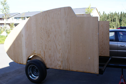

Side walls set in place to locate wheel openings.
Side walls .jpg (63.5 KiB) Viewed 446 times

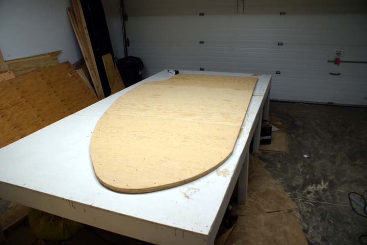

Build a large flat Table to develop a profile on and build the side walls, nine sheets of 4x8 plywood laminated for each side. The side walls are two sheets of 1/2 and one of 1/4 plywood.
Build Table.jpg (44.94 KiB) Viewed 446 times

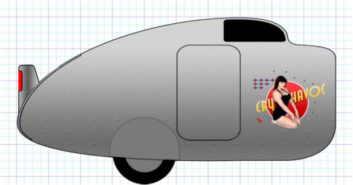

Found this very small picture somewhere and decided to use it for design.
B17 Idea.jpg (138.35 KiB) Viewed 446 times
