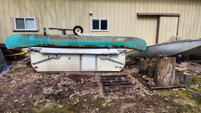

So, since the inception of this project, the plan was to use the chassis from a 1971 Skamper Pop Up Camper.
The camper was last used roughly 20 years ago... and since its last use... it has been parked behind the barn.
Parking Place for 20 years
Skamper Day 0.jpg (201.51 KiB) Viewed 2986 times
Needless to say, it has seen better days! It sat here for so long, it sank into the mud.
Recovery in progress
Skamper Day 0 - recovery.jpg (212.47 KiB) Viewed 2986 times

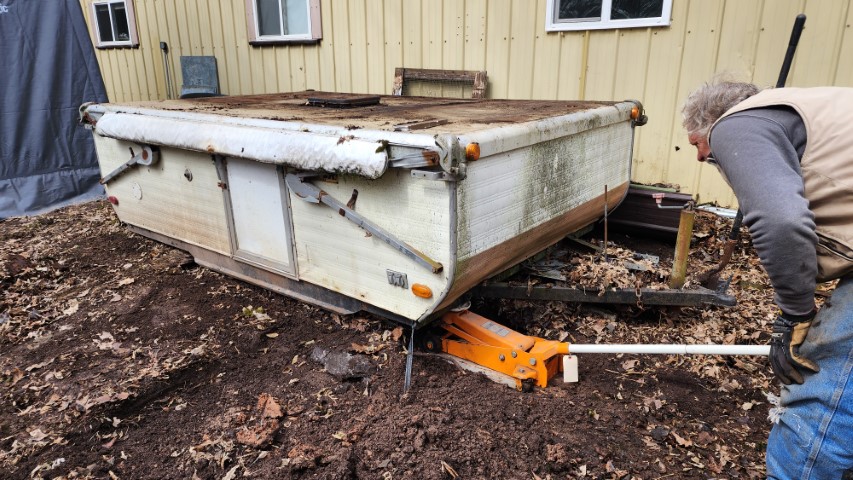

It took some digging and convincing to get this free from the mud!
There was a fleeting moment where the plan shifted from rebuild to refurb...
Then we tried to open it up...
Salvage
skamper day 0 - popup.PNG (1021.75 KiB) Viewed 2986 times

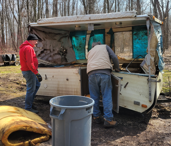

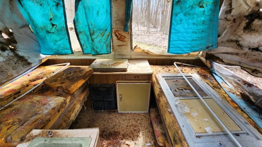

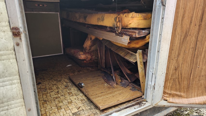

The Donor (part 2)
There was no way now this was going to be a refurb...
Skamper Day 0 - inside2.jpg (190.54 KiB) Viewed 2985 times
We barely needed a hammer to rip this all apart!

Luckily, my family supports the project! Today, my dad was helping with the demolition. He never said it, but I got the feeling there were some mixed emotions here.
On one hand; This was a wedding present from his favorite Aunt/Uncle, and our family has many memories of using this camper as I was growing up! I even remember helping my parents replace the canvas some time in the mid 90's!
On the other hand; his son (that's me!) wanted to preserve a family tradition and start new traditions with his new and growing family... and I want to do it TOGETHER with my dad!
There were certainly some emotions at play that day!

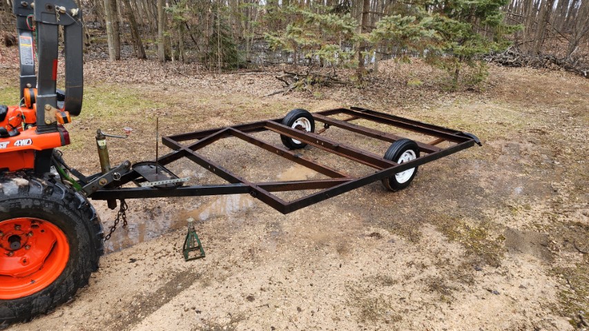

It was a long day, but in the end, we liberated the frame from the rot, and had a foundation to build upon!
Skamper Day 0 - power wash.jpg (250.96 KiB) Viewed 2984 times

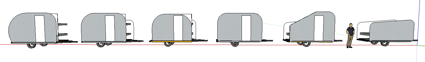

The PLAN
Now that we confirmed the frame was "ok" to use... it was time to get serious about a plan!

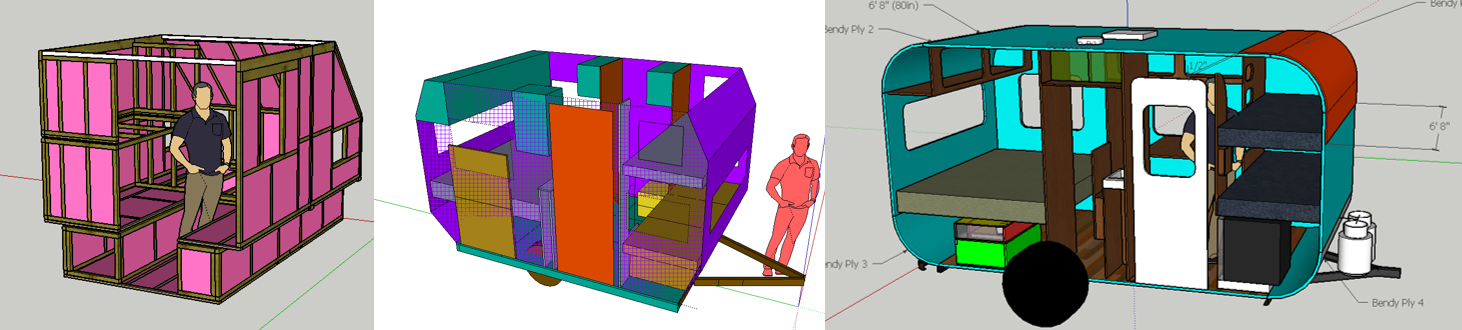

It was a long winter waiting for things to thaw enough to liberate the frame, so I had plenty of time to dream up different plans and sketches.
Some were great, some... we "mis-calculated"...
Concepts v1-v3.PNG (389.18 KiB) Viewed 2976 times

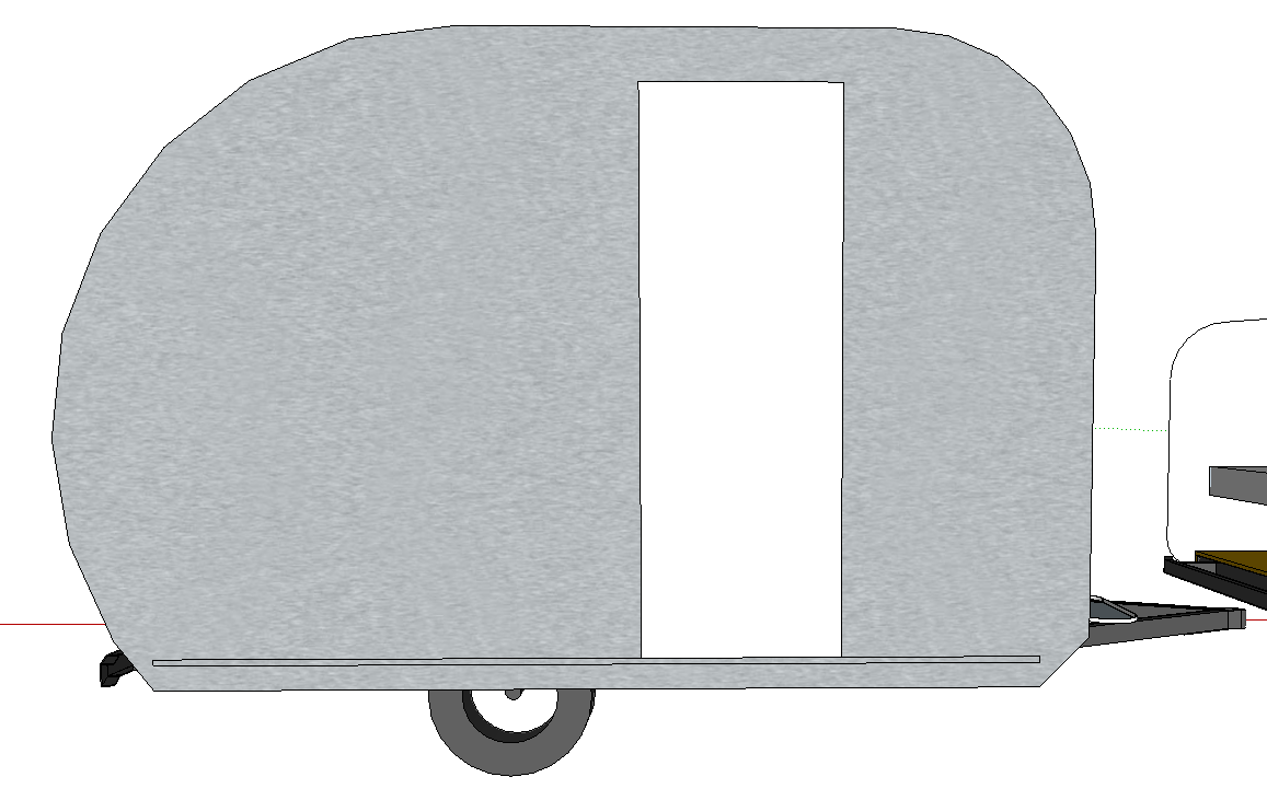

By the time I got to VERSION 4, I had a layout that was practical, now I just needed to settle on a "shape".
design progress.PNG (61.79 KiB) Viewed 2976 times
I really like the look of the old CalCrafts, Scotties and Shasta's and such... so the large radius back end was the direction I was headed!
I was playing with the design in SketchUp one day, and that's when I FOUND it! I found a way i could make the profile work for head room, AND overall length!
V4 outline.PNG (388.25 KiB) Viewed 2976 times

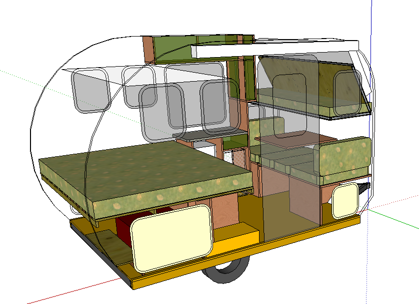

After much deliberation, and trial and error, A plan was coming together.
V4 Reveal.PNG (238.8 KiB) Viewed 2966 times
This layout had storage, sleeping for 4, a pull out kitchen, and should be light enough to meet my goal!

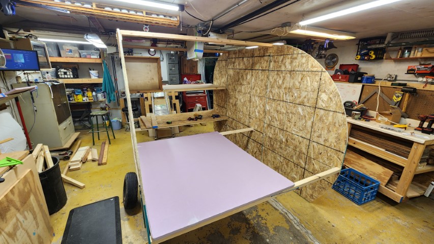

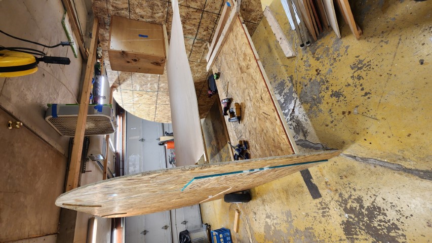

It was time to make a mockup... so I bought the cheapest panels of ply I could get from Menards, and built a mockup in the garage!
This mock up was actually really helpful! I laid out the beds and walls and it was quickly apparent that it was going to be cozier then we thought!

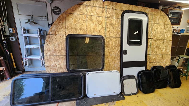

It's HOT! And I'm getting antsy... I want to keep progressing on the build, but the frame is still up at the family property, 3 hours away...
I've got a free Sunday, so it is time to make the pilgrimage. Roughly 3 hours from home base, is a mecca that any TNTTT DIY'er should visit at least once in their build... all they over in White Pidgeon, Michigan, a hop skip and a jump from the RV museum of course I am talking of Botrangers! This is a RV Surplus "store" full of bits and bobs for any and all RV builders. There are doors, windows, panels, switches, sinks, lights, cameras, ovens, jacks, fabrics, mattresses, toilets, fans, fasteners, frames, you name it, they have it! I planed on a 4 hour visit... the first hour I just walked though the aisles, the different buildings... awestruck... speechless! Why does this have to be so far away! If you are familiar with the Habitat for humanity RE-STORE, this is the RE-STORE for RVs!
Anyway... once I finally centered myself, and got to task, I ended up finding a set of 6 matching windows ($40 each), a door ($150), an emergency exit window ($52), and a set of luggage doors ($90), all for well under what I was expecting/budgeting!
The Haul (plus some other goodies!)
The haul.PNG (946.11 KiB) Viewed 2965 times

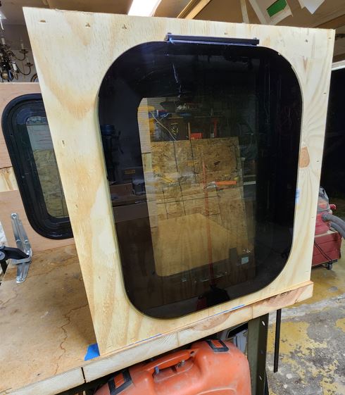

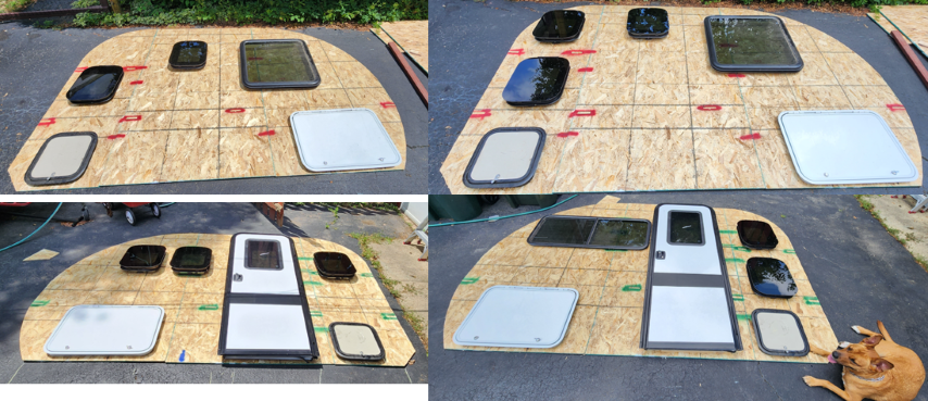

The Puzzle

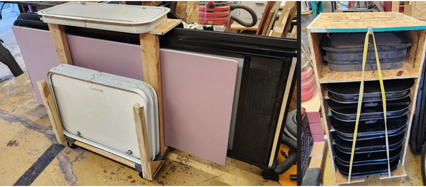

Turns out making the mock up had a second advantage! Now that I had the profile I wanted, and the windows, doors and luggage doors, I could finalize my design.
Using the Plywood templates, I was able to layout all the windows and doors and find a final design that suited the floorplan.
puzzle a (Small).PNG (673.47 KiB) Viewed 2957 times
After tinkering for a while, I finally had a layout that worked, and looked good too!
Puzzle b.PNG (604.8 KiB) Viewed 2957 times
With the scraps I had from the plywood mockup, I threw together some storage carts to hold the windows and doors until it was time to use them.
puzzle c.PNG (756.1 KiB) Viewed 2957 times

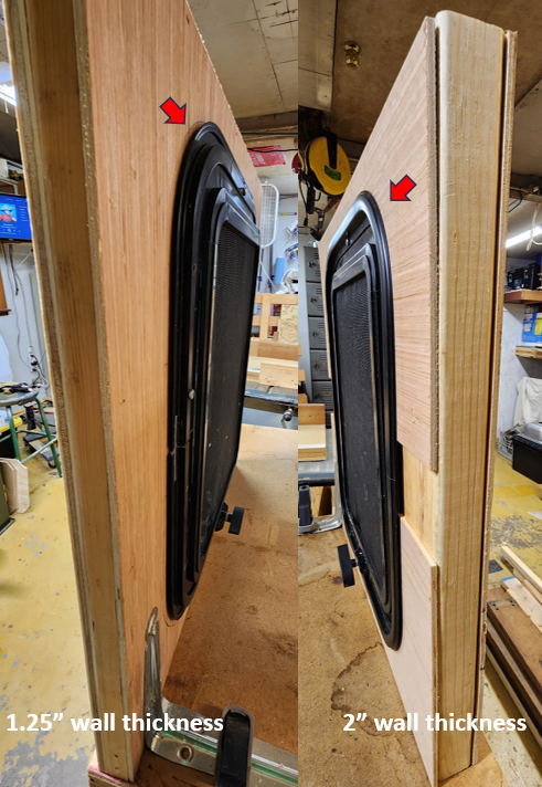

Spent some time out in the garage today working on some design elements. I have been back and forth a few times on just how thick the walls need to be. I am trying to design to my windows... and... it's not as easy as I thought.
Testing wall thickness
wall thickness side example.PNG (956.33 KiB) Viewed 2668 times
I have a full post on this adventure here: https://www.tnttt.com/viewtopic.php?f=2&t=75800
The quick summary, looks like I am planning on 2" thick walls!

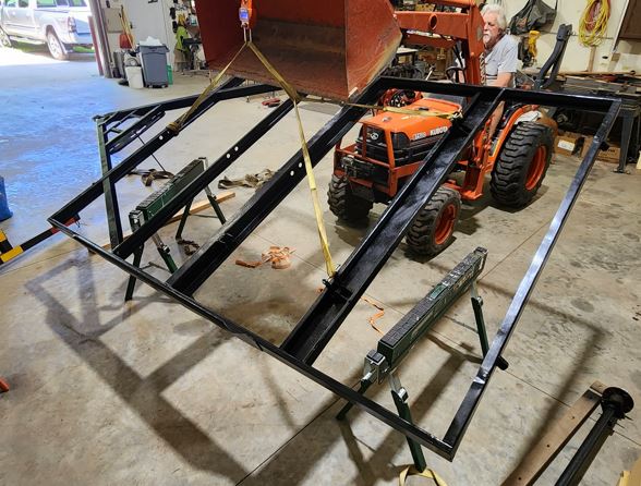

Good As NEW!

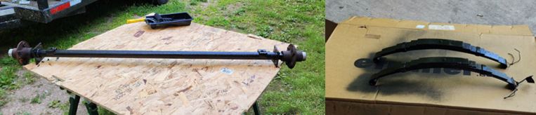

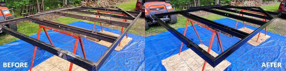

Had a chance to work on the frame over the weekend. Managed to fully clean, grind, and sandblast the old frame. Luckily all the rust was surface rust, and it cleaned up pretty well.
Once the frame was clean, I wiped the whole thing down with alcohol and then painted it.
Before and After
Frame Before and After.JPG (78.48 KiB) Viewed 2577 times
I used POR15 on the frame.
POR15 is NOT cheap ($60/Qt), but in my opinion, WORTH EVERY PENNY! I was really happy with how well it coated and how easy it was to apply.
I managed to get 2 coats on the frame with ONE QUART. Once the POR15 dried to tacky (approx 2hrs as suggested on their site) I applied 2 coats of rattle can Black Implement paint. (1 can each coat)
This is the spray paint I used for the "Top Coat": https://www.acehardware.com/departments/paint-and-supplies/spray-paint/general-purpose/17072
For the springs, I applied 3 coats of Engine Paint. (Found this as a recommendation online somewhere...)
Here is the paint I used for this: https://www.acehardware.com/departments/paint-and-supplies/spray-paint/hobby-spray-paint/1498161
For the axel, I applied one coat of POR15 then one coat of Engine Paint, just because...
Axel and Springs
Axel and Springs.JPG (28.68 KiB) Viewed 2577 times
We also worked on the suspension. The 50 year old shackles and bushings were well past their prime and seized up, so we broke all that loose and rebuilt that.
Finally, just for fun, we weighed the frame. Turns out the 1971 Skamper FRAME weights almost exactly 150lbs!
