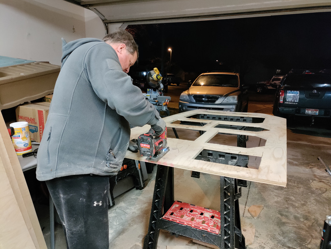

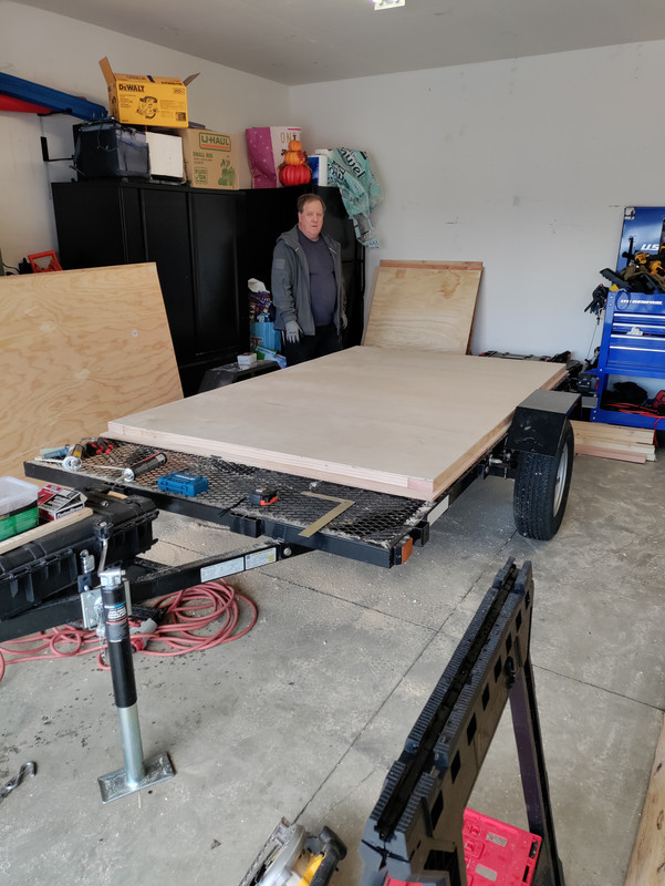

We started with the floor. I used 2x4 for the framing, 1/2 in ply for the bottom, and 1/4 birch on the top. The voids are filled with 1.5 inch foam insulation
The panels are staggered on the top and bottom. There are two 48x60 panels on the bottom of the floor, and one 48x58 (or thereabouts) panel on the top center, and one 24x58 (give or take) panels on each end.
We then measured about 8 times before cutting the door out from the side wall, and seeing where it landed.
The, basing everything off the dimensions in my design, cut all the voids out for the wall insulation, giving us the template for the other wall.
Today, the plan is to get the rear galley skeleton cut, test fit that door, get the other wall skeleton cut, and get the inner skins on the walls.
I was hoping to be able to wait on moving the axle, but that's going to have to happen sooner, rather than later, it seems.
We then cut o

I didn't get as much done today as I'd hoped, but, after one weekend, I have the wall skeletons cut, and skinned on the inside, as well as the floor made.
I'll be back at it next Saturday, getting the walls up, the rear galley wall cut and skinned, and whatever else I can get done.

While I was measuring the back wall in preparation to cut out the rear door, [USER=33922]@David H[/USER] was busy cutting out some of the expanded metal, so we can pass wires and water hose through the floor.
We also managed to get the stabilizer jacks mounted.
I need shorter bolts, but they're quite solid, and can easily lift the trailer off the ground.
We also managed to get ALL the panels cut out for the cabinetry. 4 sheets of 1/2 in plywood....
And the glue for the canvas dried enough to put the first coat of paint on the floor.
We should be able to get two more coats on the floor tomorrow. We also get the inner skin on the back wall, and hopefully we can flip the floor, and get the side and rear walls glued and screwed to the floor.
