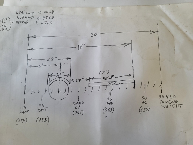

Here's one of the very basic weight and balance drawings I made while trying to determine where to mount the axle, and where to secure my heavier furnishings.
When I'm hauling toys, there will be between 600 and 900 pounds of motorcycle balanced squarely over the axle.

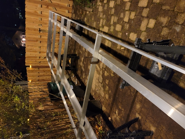

Step two was learning how to tig Weld and welding up an aluminum frame from 1/4" thick 3x6 C channel and 1/8" thick 1.5x3 square aluminum tube.
After many sample pieces welded together and destructive tested with a 4 pound hand sledge, my Weld became consistent enough to trust with the not heavily stressed areas like this 1.5x1.5 inch L channel perimeter frame:
After that, I moved along to welding my 1.5x3" floor joists to that perimeter:

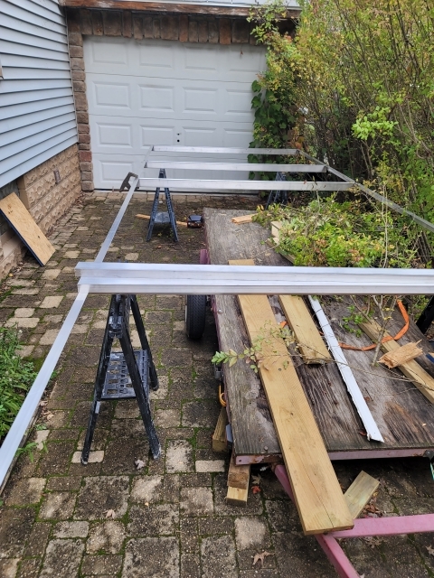

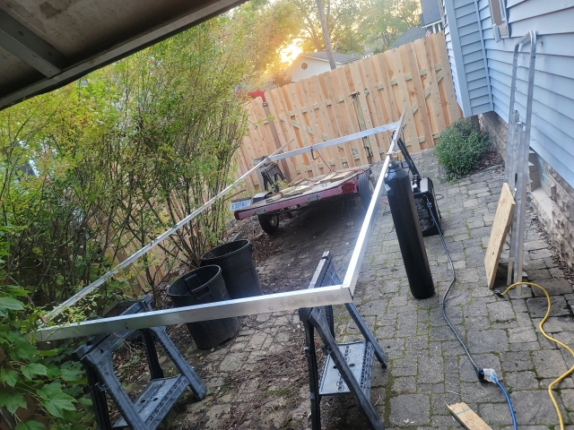

Postby coal_burner » Tue Jun 25, 2024 12:21 pm

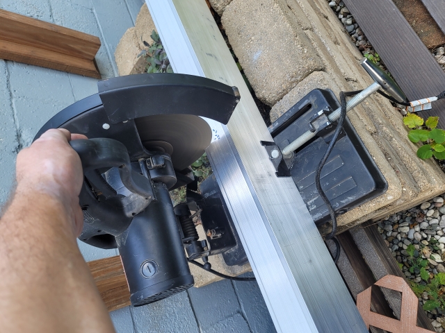

Using my craptastic Harbor Freight chop saw, I cut my frame rails to length.
I leveled my 1/4 thick 3x6 frame rails on saw horses, laid the joists in their frame on top, and welded them all on.
I now have something that looks kinda' like a trailer frame with frame rails that stick way out past where a tongue should be.

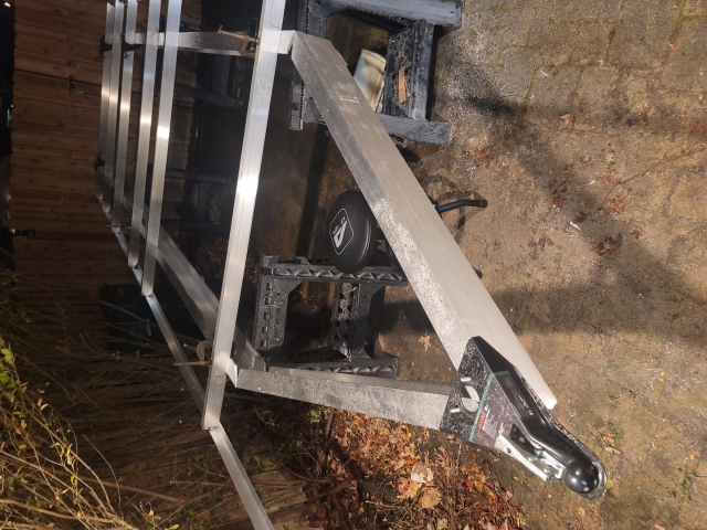

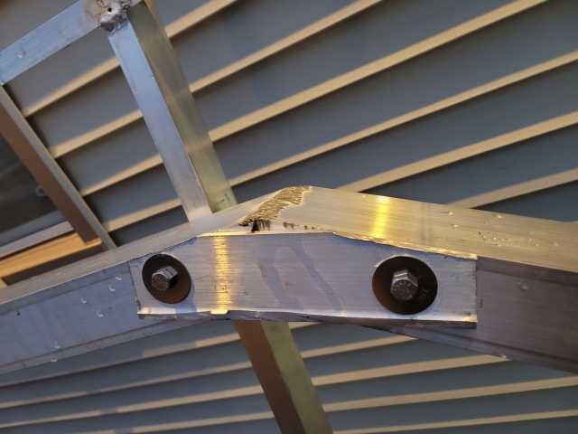

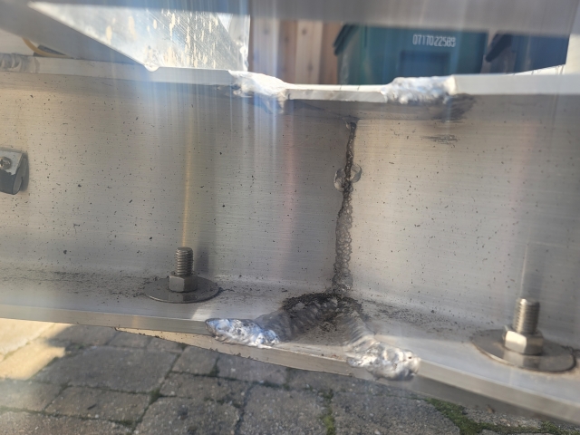

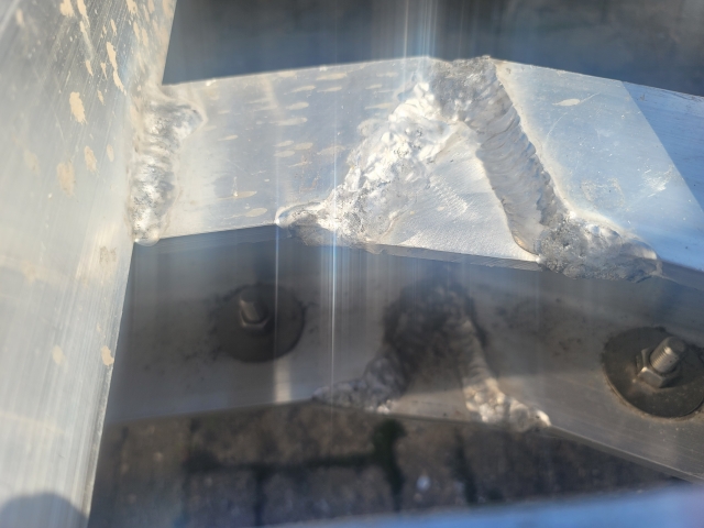

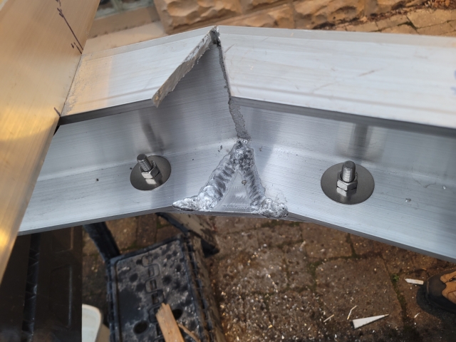

Now it's time to take that pair of frame rails that are sticking out and turn them into a V tongue.
I used an 8" cutoff wheel to take v shaped chunks out of the top and bottom of the C-channel, then gently bent both rails together, and held them in place by bolting them to my hitch.
Once I did a bunch of warping and straightening of the frame/tongue area, I made what are probably going to be the most structurally stressed welds of the entire project: welding 1/4" aluminum plates to the top and bottom of where I cut out those notches to bend my frame to tongue transitions together.
I spent alot of time running at high current to make sure I had good penetration all the way through both pieces of 1/4" aluminum, and that's when I melted through the gas line on my welding cable.
$150 later I now have a heavier duty (and longer) welding cable and torch head.
Note the existence of large stainless steel bolts acting as a backup just in case those welds crack.

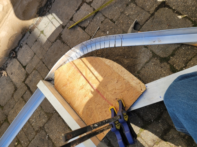

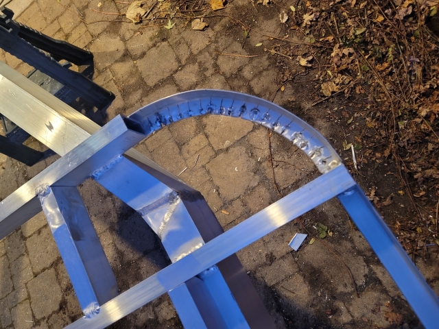

To round the front corners of the perimeter frame, I cut notches into the 1.5" angle every inch, then bent it around a rounded plywood former.
Once I welded those to the frontmost floor joists, the curve stayed.
That's when I welded the ends of all those notches together, and realized that wind is not the friend of a TIG welder. My gas blanket kept getting blown away from the ark, and my tungsten electrode would burst into flame and contaminate the Weld area with big scorch marks and lots of burn through.
I'll eventually grind all that down and re-weld things before I install a floor.

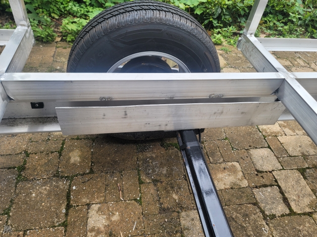

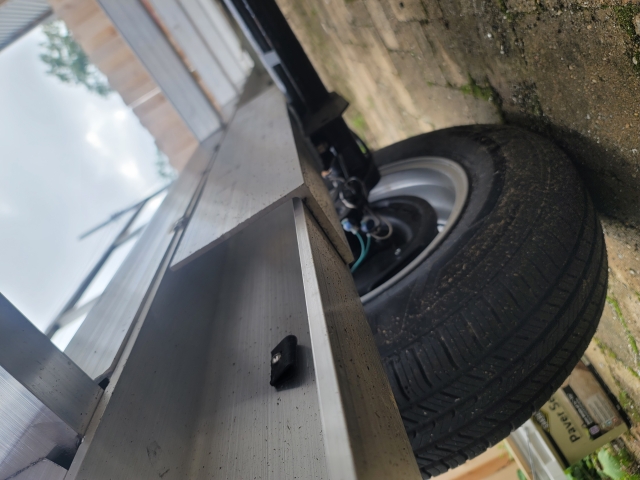

Moving right along, time to mount the axles.
I have a 3,500 pound torsion axle which allows me low ground clearance for aerodynamics, as well as good bounce damping, but it does concentrate all the trailer's weight onto 2 tiny point loads on the frame rails.
I decided to spread those loads out a bit by using some scrap 1/4" C-channel pieces cut down into L profiles.
Those scrap pieces are about 3' long, so should seriously help with frame rigidity in that area.
Unseen in these pics is the fact that I put foam "sill seal" between the steel axle and aluminum frame to prevent any dielectric action from corroding the frame.
The hardware holding it all together is 5/8 stainless steel which is dielectrically compatible with aluminum.

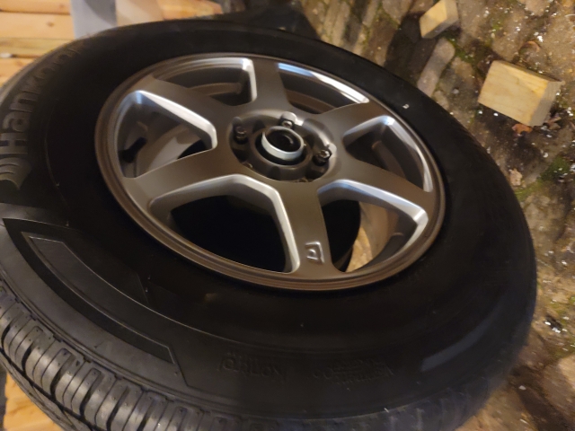

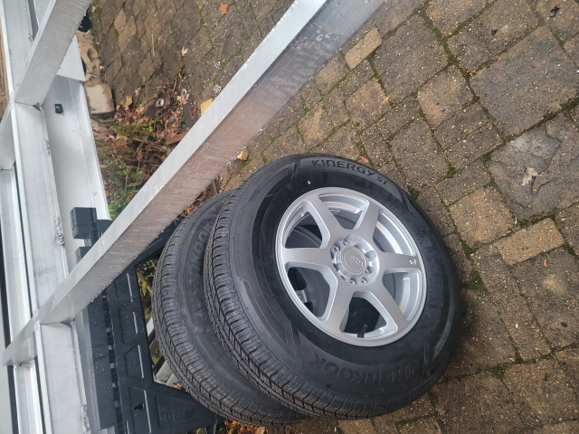

With the axle mounted, it's time for me to start into the comedy of errors which are my tire and rim selection.
Wanting to save a bunch of space, I decided to select a trailer wheel that allows me to use my car's spare tire as my trailer spare.
That's really good in theory, but really hard in practice.
I discovered that trailer rims have zero offset, which means that the face of the rim aligns with the center of the tire.
On my car (which has a 60mm offset) the face of the rim aligns with the face of the tire.
Now, trailer tires can be mounted on car rims with no difficulty, but it turns out that car rims cannot be bolted to trailer axles without a ton of difficulty.
This right here is about $1,000 of tire and rim, since they were one of only 2 designs which had the appropriate offset as well as the size that allows me to mount my chosen tires.

Postby coal_burner » Mon Jul 01, 2024 7:21 am
On automotive axles, the bearings are set inboard of where the wheel mounts, on trailer axles, the bearings are centered in the middle of the rim.
This means that the rim has to have a large hole in the center for the bearing housing to pass through it.
My automotive rims had center holes that are too small for that (and there are small plastic center caps in these rims).

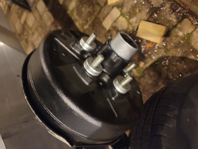

Postby coal_burner » Mon Jul 01, 2024 7:48 am

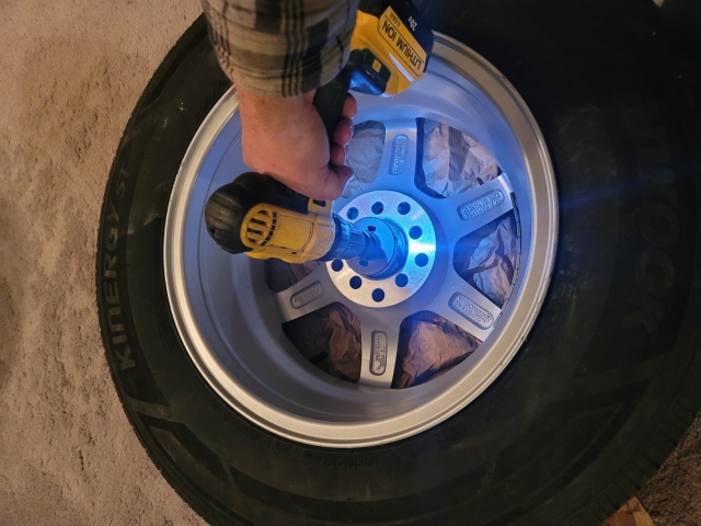

Well, it's time to take a hole saw to my $1,000 rims.
Fortunately there was enough space for me to shave off 1/8" all around that center hole, allowing the bearing housing from the axle to slide right through.
WHEW!
Unfortunately there's another difference between a trailer torsion axle and a car axle: the axles lever arm is set very close to the face of the brake drum, which is no problem for a rim with zero offset, but rubs hard against a rim with 60mm offset.
My temporary solution was a stack of washers on each wheel stud that spaces the rim far enough out not to rub on the axle.
Eventually, those were replaced with some wheel spacers from Amazon

Postby coal_burner » Mon Jul 01, 2024 5:06 pm
Here's a couple angles of the tongue to frame welds.
I practiced these exact welds for a few days before putting arc to trailer.
I was eventually able to get good enough penetratio that I could crumple the samples up with a sledge hammer without cracking the welds.
