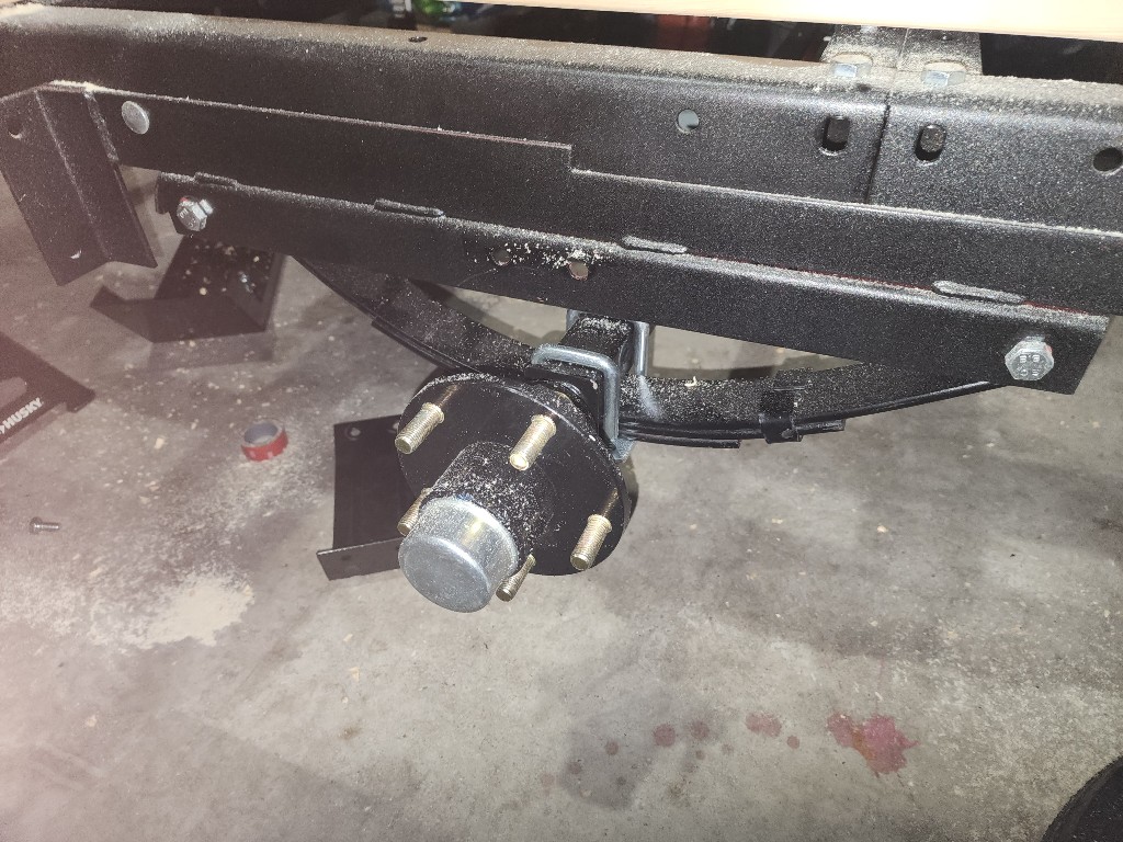

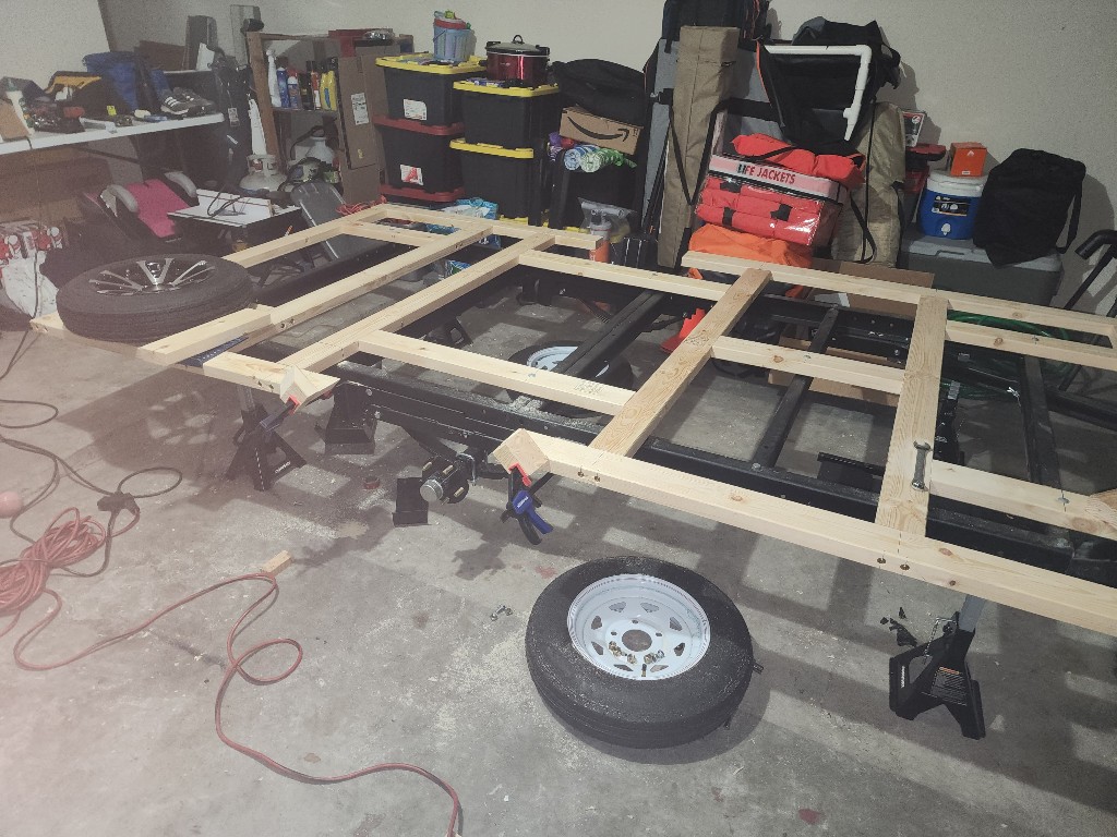

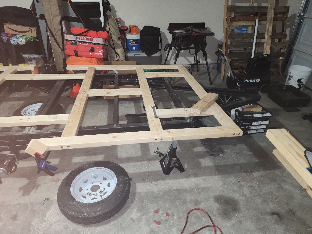

I've started with a 1720 HF 4x8. Coated with Rust-Oleum bed liner. I've underslung the axle. And laid out the grid work for the base. Glued and screwed that frame together and worked out bolting it to the trailer using seven 3/8 carriage bolts with lock nuts and washers.
