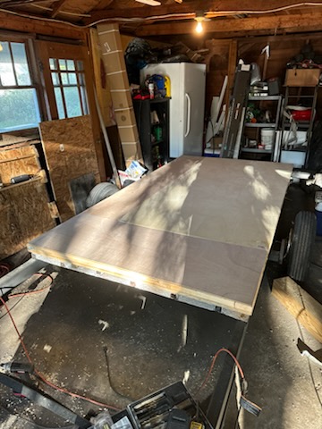

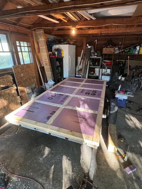

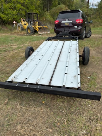

Finally started construction last week! A good friend helped me torch off some skid-plate from another trailer he was scrapping, and after a few hours of sandblasting, I primed and painted it. I rolled on bedliner on the flat side, which is the road side. Used the "bottom" as the new top, so I could screw my 3/4 BDX plywood onto that. This is welded and bolted into place (overkill!!!).
3/4" BDX plywood, followed by foam insulation between 2x4 framing, and topped with 1/4 plywood.
1/4 plywood installed
insulation
upside down skidplate

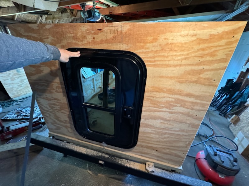

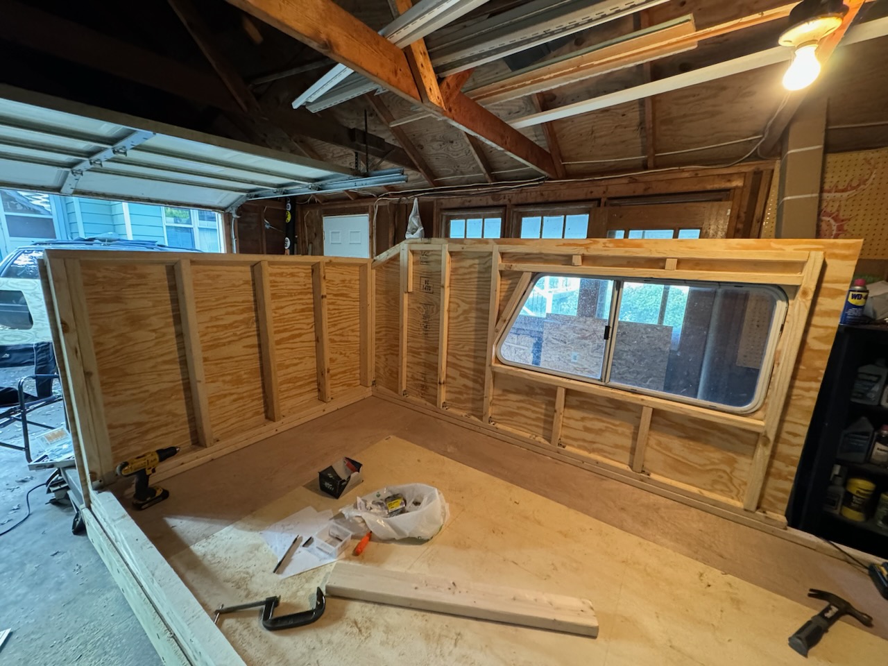

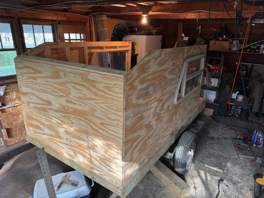

Made some progress today! Figured out my side profile, and window placement. These are the windows I salvaged from the donor trailer. The driver's side window is a fire-egress window. We're doing a rear exit door design, with a side-slide-out kitchen (also to come out of the driver's side). Used 2x4 framing for the front wall to help with load and wind resistance. Side walls framed with 2x4s ripped in 1/2. Windows just tucked in to see how it looks, not secured.
Ordered my entry door from Vintage, and that shows up tomorrow, but I don't think I'll build the back wall until my wiring is done on the inside to make it easier to get in an out :) It's fun to see it starting to take shape!

Third wall started
Two walls up!

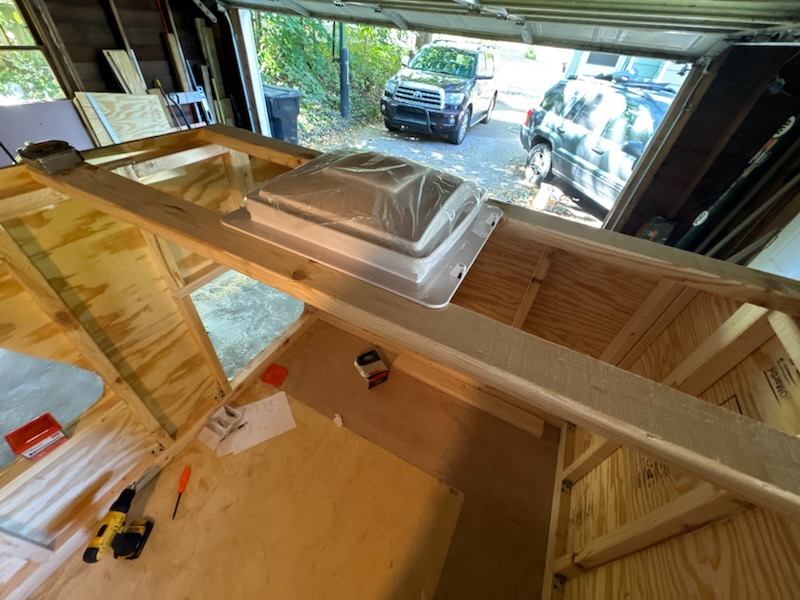

Busy couple days. Finally completed the walls, and began the roof. All components fitted for walls and ceiling (window, door, baggage door, and vent fan). A little more roof work, and a few more boards on the inside and I can start PMF, slide-out kitchen, and wiring.

Exterior 1
Rear Door from Vintage
Vent Fan

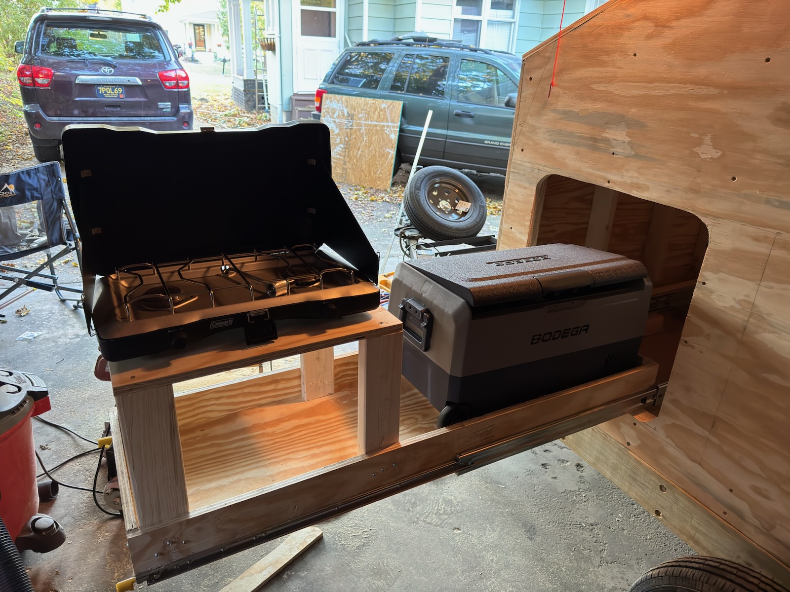

Postby mmccrumb » Sun Oct 20, 2024 4:25 am
With some pocket screws (thanks Kreg system!) and glue, I was able to make the slide-out drawer, out of some scrap 3/4" plywood. I purchased some 300lb 3" x 56" drawer slides (they aren't cheap $150 - https://www.amazon.com/dp/B08C52GDWP?re ... title&th=1). They did the trick, and the drawer slide locks into place at three positions: closed, 1/2 way, full way. I'm glad it slides all the way out, allowing me to open the fridge from the outside. I do plan on making a top access door to the inside cabinet to allow for fridge access from the inside as well. Still working on the inside cabinet, to keep the cabin warm when open (insulation and framing it like an outside wall).
I'm making a cutting board to sit on top of the fridge, unless I fashion something more fancy, haha. I'm trying to keep this simple, so I'm currently planning on just setting it on top of the fridge when using.
Very happy with how this part of the project came out!

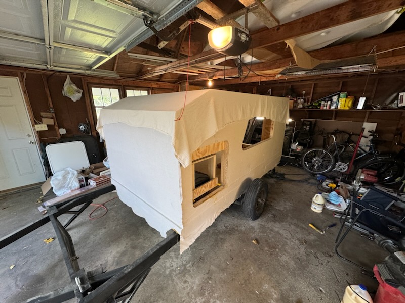

Postby mmccrumb » Thu Oct 24, 2024 2:14 pm

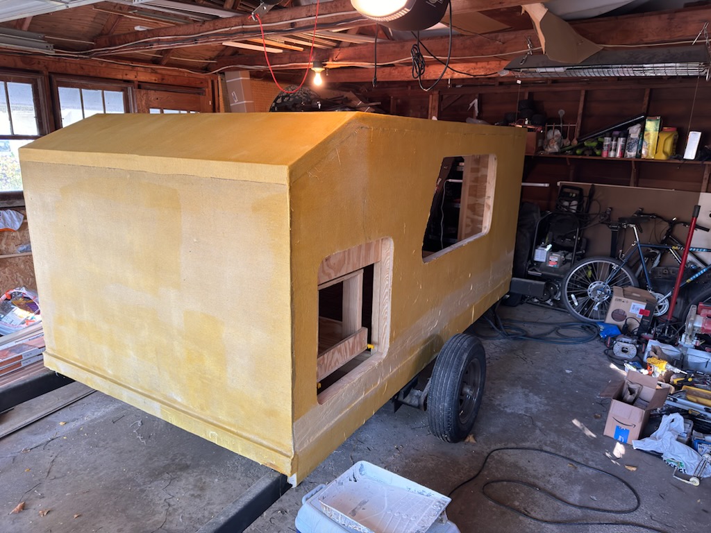

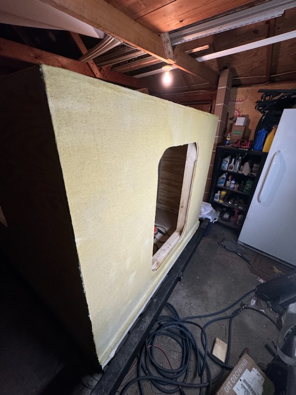

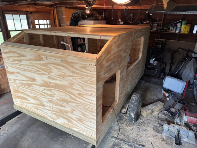

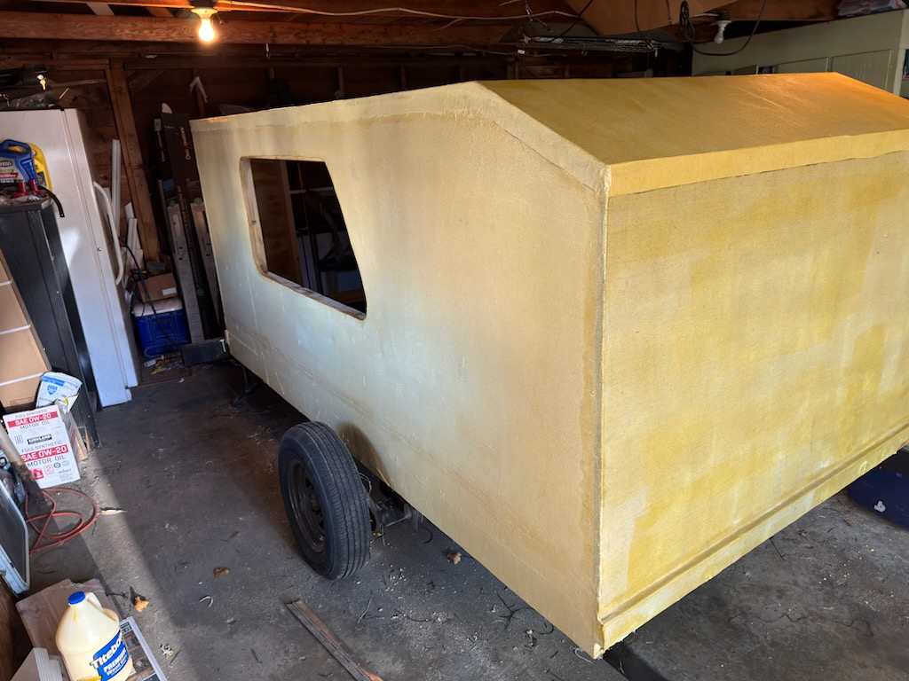

PMF has begun! It's a neat process. Learning some lessons along the way. If I ever build another one, changes will be made. VERY happy with how its coming out, and its so much stronger than I anticipated.
Again, so thankful for other build journals and information here!
Mike
passenger's side, no exterior glue yet, top laid in place.
Driver's side, no exterior glue, top just laid on.
Rear with first exterior coat of glue

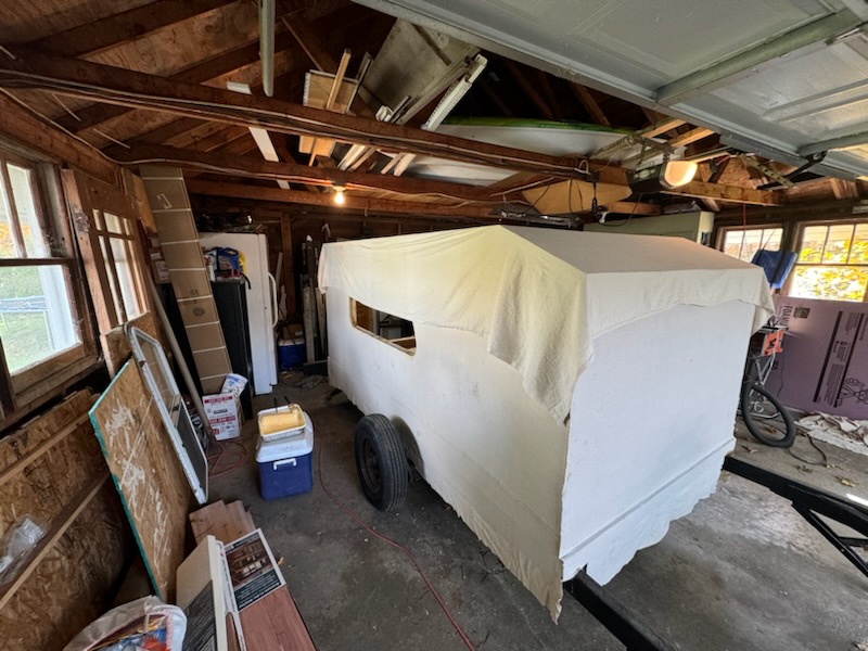

Last glue coat PMF
Last glue coat PMF 2
The last of the Titebond II glue has been applied...what a chore :)

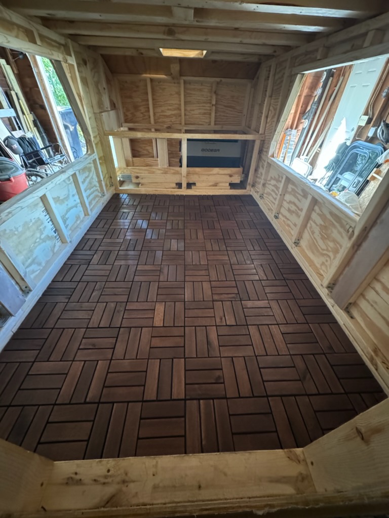

Teak flooring
I found these indoor/outdoor deck tiles on Amazon Prime day, for $16/box. All told, I have $48 in the flooring. They snap in place and fit perfectly. Since they are tiles, there are air gaps under the wood and between the parquet design, which I'm hoping means I won't have mold issues under the mattress. They should handle expansion/contraction with temp changes well, and can be pulled out if there is a bad leak or spill. Plus, I LOVE how they look...even if I won't see much of them when the mattress is in sleeping mode.

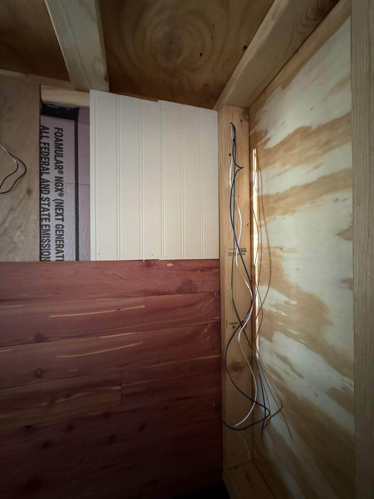

Postby mmccrumb » Tue Oct 29, 2024 7:55 pm

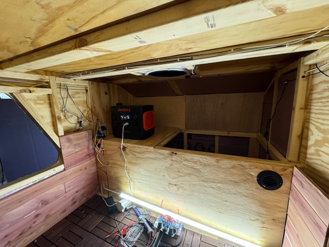

I spent a handful of hours running ALL of the wiring. Got the exterior DOT lights wiring ran, the exterior lights for use in campgrounds, and the interior wiring ran for lights and vent fan. A lot of work left to do in getting the fuse panel and switches all hooked up, but all in due time. :) It was nice to put up some insulation on the far wall with less wiring, and then see what our wall covering choices look like. We love the cedar look and smell, and the bead-board running perpendicular gives it a homie feel.
Wall covering and wiring

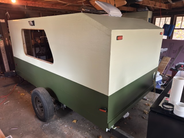

Postby mmccrumb » Tue Nov 05, 2024 7:43 am
Another productive week in the books:
Finished the paint (will do touch-ups when all buttoned up). We're going for the wilderness theme, and quite pleased.
Paint complete

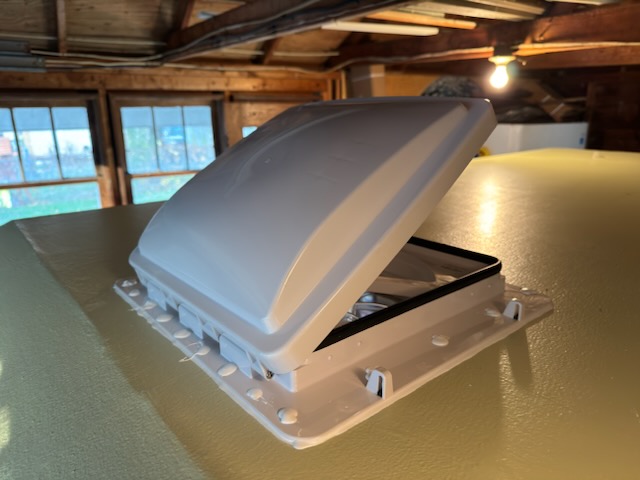

Vent fan installed, and was quite pleased it worked. Wiring success! :)
fan

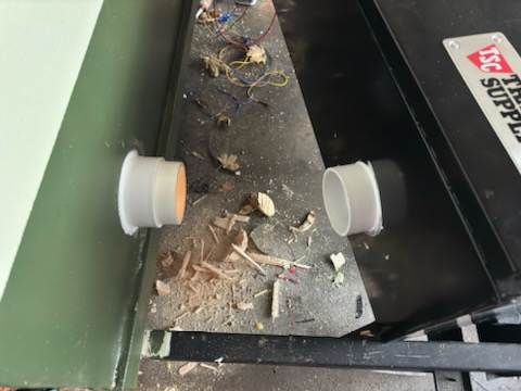

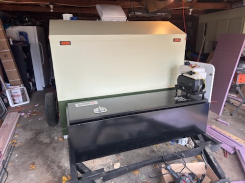

I purchased a clearance priced 60" toolbox from Tractor Supply. I'll put my diesel heater in there, routing the fresh air and exhaust out the bottom. To run the duct into the trailer I'm using 4" PVC. The heat duct will run in that between the toolbox and trailer. Those two cuts took me 3 hours to plan, measure, and accomplish...I did NOT want them to not line up. Still waiting on the 15 liter diesel tank to arrive to finish that part of the project. But, I did wire in the control unit into the trailer, will be mounted next to my switch plate. And I wired the power to the heater. Both wiring jobs worked, to my happy surprise.
Diesel Heater ducting
Mike

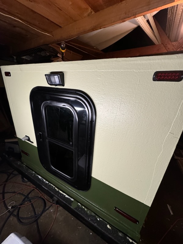

The door was installed (purchased from Vintage). The DOT lights are installed, and the exterior light (plus two more on each side) are installed. It took some figuring out, but I wired in on-on SPDT switches to be able to turn the exterior lights on from the bed or from just inside the door.
Door and lights

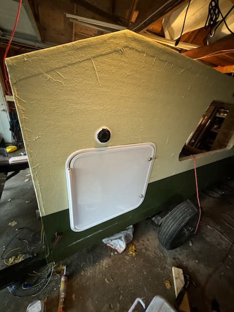

Got the kitchen door installed, and also added in the shore-power connection (which will power my Jackery and/or a power strip). You can also see in the picture how terrible I was at cutting my fabric and cleaning the frayed edged. For our purposes, we're okay with the "home built" look. I like to call it "character" haha.
Kitchen door, Shore power

Using 3" flexible tubing I got the heater vented into the trailer. There is just enough clearance from the end of the slide out kitchen/fridge...whew!
heater vent
Here is a good pic of the toolbox. The diesel heater will be mounted on the passenger side once my 10 liter diesel tank shows up. Plenty of room in there for wheel chocks, jack pads, firewood, propane for stove, etc...
Tool box

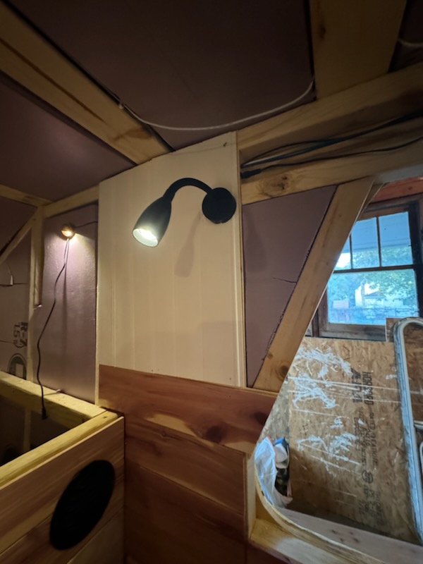

My wife picked these bedside lights out. They are flexible, can be dimmed, has a USB outlet on the bottom. We put one on each side of the bed.
bedside light
