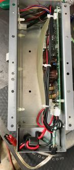

One small catch (truly) is that these are the European Voltage versions that have a 220v euro plug on them in addition to a set of 12v leads. I was able to remove the back electrical box and remove the 220v side panel and wire in my own $17 110v ->12vdc power supply. Super easy solution to power off of shore power! You can always power off the 12v leads if you don't care about shore power. I went through the effort because I am assuming that it will prioritize shore power over battery power when connected, but I have not tested this yet.

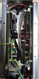

Again, this fridge has BOTH 12v leads AND a 220V euro plug on it. So if you don't want to bother with the AC shore power then you don't have to.
However we're a bunch of nerds and proceeded to tear into the power supply to see what we can do.
-I tried cutting off the euro plug and installing a regular 110v plug since some power supplies can handle it, this one can't. It produced no output at 110v.
-220v leads attached on one side of the board, and 12v leads out the other side, easy. Just connect the output of your aftermarket 110v -> 12vdc 10 amp power supply to those leads.
-Thats assuming that it's smart enough to prioritize shore power over the 12v leads and not backfeed the 12v leads (this is electrically easy, I just haven't tested it yet) I'll probably delete this comment later when I get time to test it.
Overview of the power supply, left side is the 220v side, right side is the components to actually run the fridge (we leave those alone)
These are the leads that need to be removed, I will be connecting my external power supply onto this.
Board removed, which was not necessary but I wanted to have a closer look. You can also barely see the black and red connector I added sticking out the bottom to connect my external power supply. It was late after this step so I called it a night.
