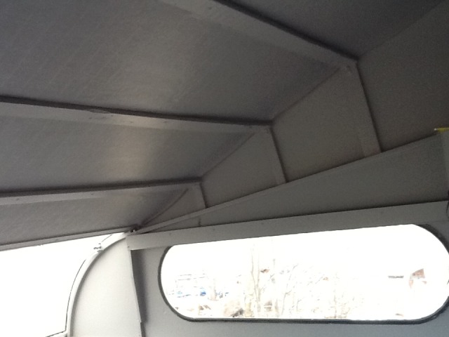

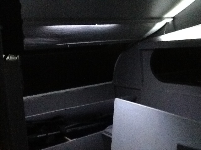

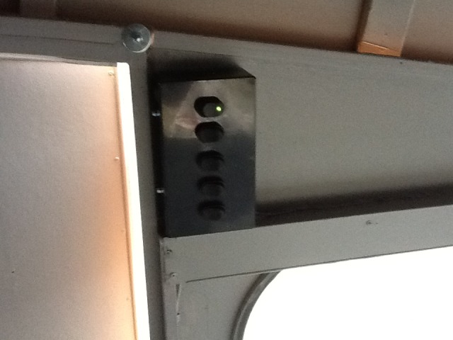

Postby tartosuc » Tue Apr 17, 2012 2:04 pm
HI all,
long with no post from em here.
winter has been long, coud not work on the camper but the nicer days are back and i've been working on and off on the camper for the last month now.
so far i've completely redone the 120v electrical system(read make safe) added 5 zones LED lighting with a 12v system.(need to buy a battery now)
I also repainted the interior and exterior, exterior still need a second coat. all accents wil be red. fixed some holes, rotten parts.
i need to re-work the counter, add a new rear tablet, re-do the seals around the roof, add bug screens at the front and back...and tons of other little things.
My wife is working on cussions and drapes.
Camping/biking season is starting and our first bike trip is on may 21st so i dont have much time to do it all. i dont tink i will work on the roof this year, neither the suspension, maybe fall or next spring. well see how everything goes.
a few pics.: as i said before my goal is not to have a perfect trailer, i want something that is mine, that work good and is safe.
