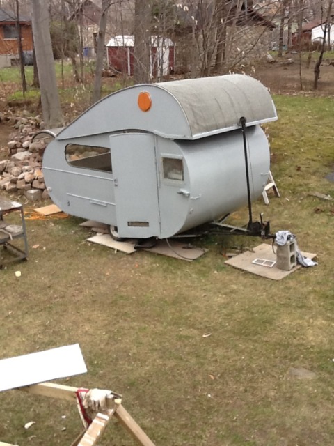

Postby LeoH » Wed Apr 18, 2012 4:30 pm
I didn't find many other images of trailers like yours, looking at your interior photos, how do you keep the weather out of the gap towards the front ceiling, when the roof's raised, and when you're done, is there a roof that covers the gap between the rear hatch and the front roof's hinge?
Just wondering how that is supposed to function....
LeoH
Posts: 10
Joined: Wed Apr 11, 2012 7:55 pm
Re: The wawaron
Postby tartosuc » Wed Apr 18, 2012 7:25 pm
LeoH wrote:I didn't find many other images of trailers like yours, looking at your interior photos, how do you keep the weather out of the gap towards the front ceiling, when the roof's raised, and when you're done, is there a roof that covers the gap between the rear hatch and the front roof's hinge?
Theres a pices of wood on a hinge on The font part that goes up when you bring down the roof. I'm adding some rubber seal to keep it tight when ts closed but also making a bug net system to have some ar flow when needed
Theres no gap between the roof and the rear hatch, just the hinge that is water tight...a bit like the galley hatch on a teardrop

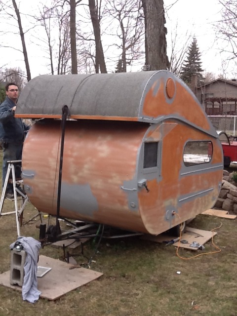

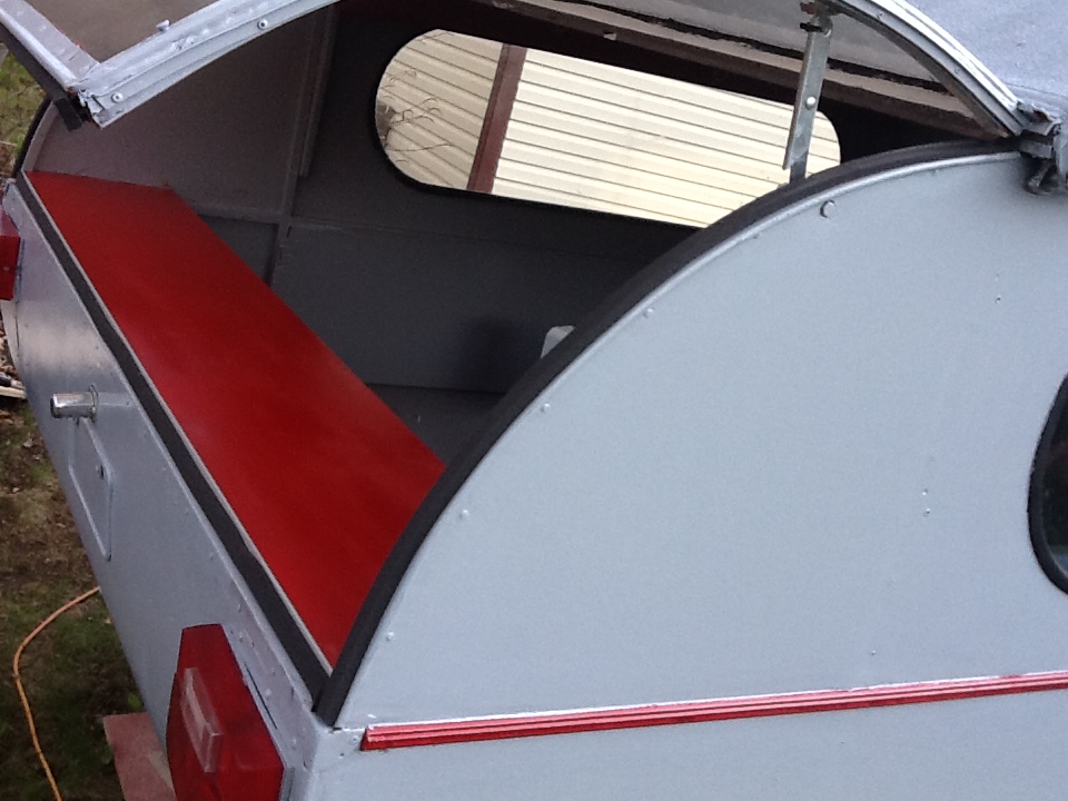

Postby tartosuc » Tue May 01, 2012 7:45 am
more work done over the weekend:
finish exterior painting.
added new rear tablet
seals around rear window.
fixe front windows.

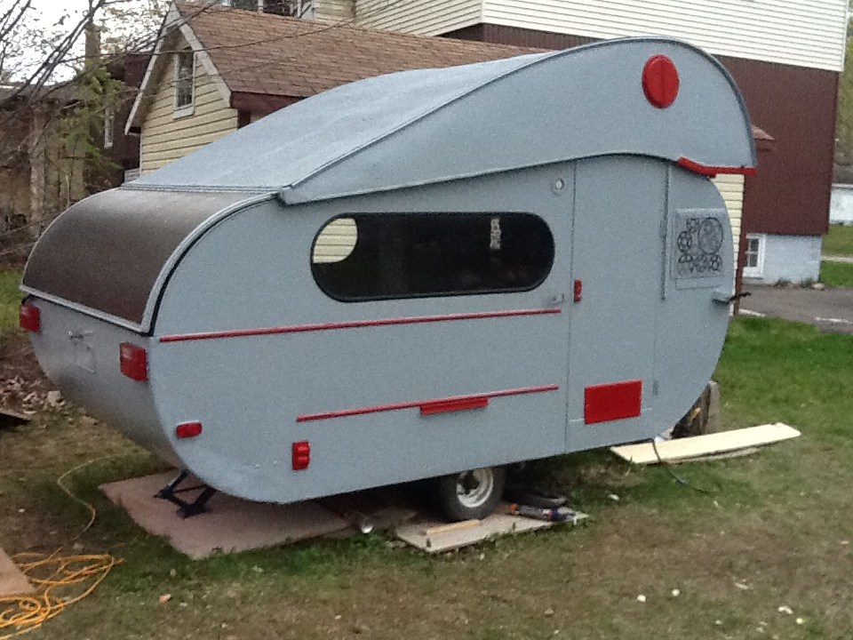

Postby tartosuc » Tue May 07, 2013 3:07 pm
latest modification.:
replaced the two vent with two lexan windows.
the original plastic vents litterally shattered when i tried to take them of to try and restore them...
i also built a new side light using an old surveillance camera housing and LED light inside.

Postby angib » Sun May 12, 2013 4:48 am
Have you locked the roof in the up position, even for towing? I can't work out otherwise how you don't scrape the porch light off when the roof goes down.....
