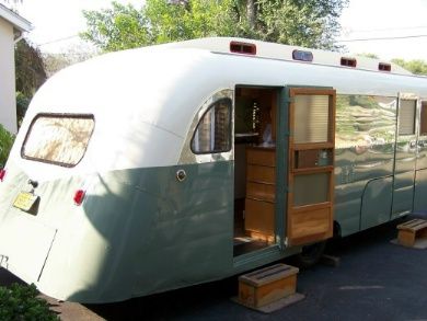

I really like the back end design of the Westcrafts. The problem is that the way the radius design wraps around the rear it doesn't leave a clean "parting line" for the roof to separate from the walls.
So that probably means a canted back end like the Pierce-Arrow or the double canted back end like the Hayes.

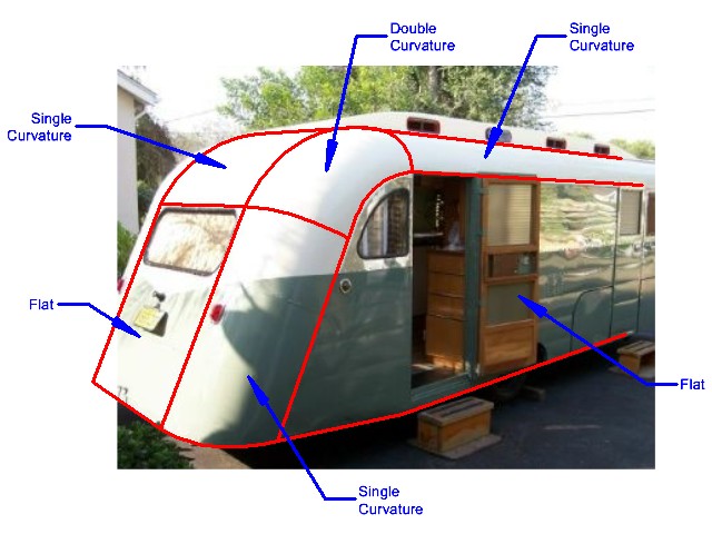

aggie79 wrote:I really like the back end design of the Westcrafts. The problem is that the way the radius design wraps around the rear it doesn't leave a clean "parting line" for the roof to separate from the walls.
That's because there is no parting line - just like a teardrop, the roof continues right down the back to the bottom.
It's not really any more difficult than the other designs - the diagram below shows how it is split into flat areas, areas of single curvature and the two corners of double curvature. This is ignoring the trolley roof which is a separate problem.
I'm assuming you understand the terms 'single curvature' and 'double curvature' - as in all these designs, the single curvature sections are relatively easy to do in metal or thin plywood, while the double curvature pieces are a total nightmare in any material.

Thank you for that drawing. I can see the parting lines now. I do love the trolley top element, but I had not planned on doing that.

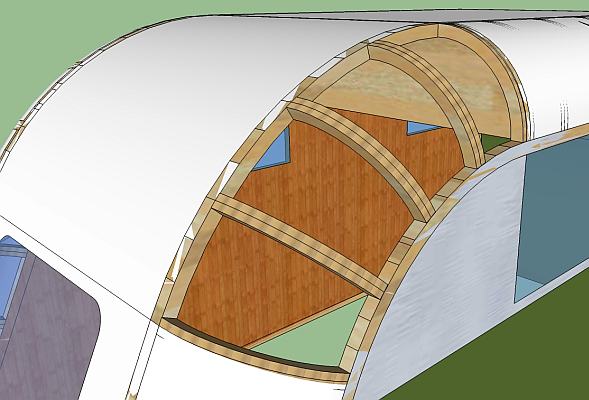

Yes, I had thought about this. I think I could have executed this design, by doing framing similar to below, laminating 2-3 layers of 3mm ply, sanding, epoxy and micro-balloons, and more sanding. (Thank you to "pebo" on this forum for this drawing and a possible way to construct this design.) I didn't realize this but you can see the parting lines in this drawing.
In the end I decided that the single curvature would be much easier to build, particularly with the limited confines of my garage. I will probably use the Pierce Arrow Travelodge back end.
