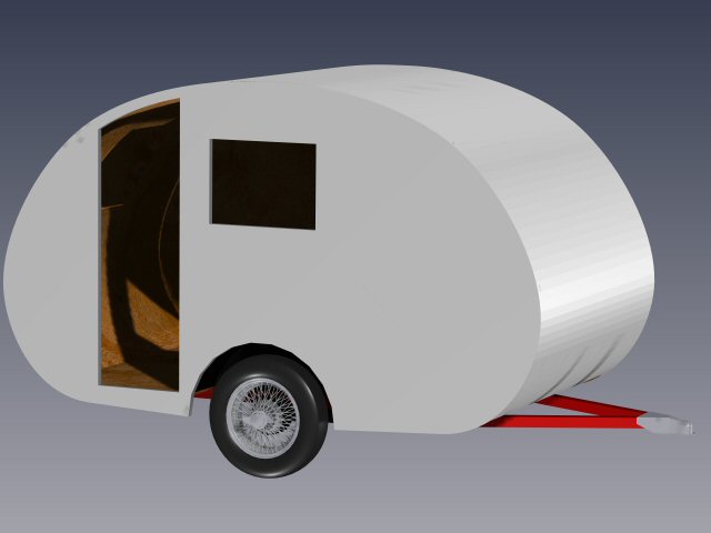

mikeschn wrote:
Steve_Cox wrote:Mike,
Do you still have the drawings you did of the Raven? It was one of my favorites. Yours was an Americanized version wasn't it?
I'll have to go looking for that...
There's some modified midget screenshots in this thread...
http://tnttt.com/viewto ... highlight=

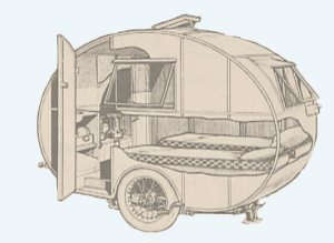

and on the internet, this is pretty much all I can find...

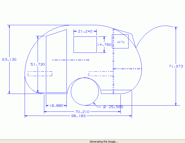

Postby mikeschn » Fri Dec 31, 2010 3:17 pm

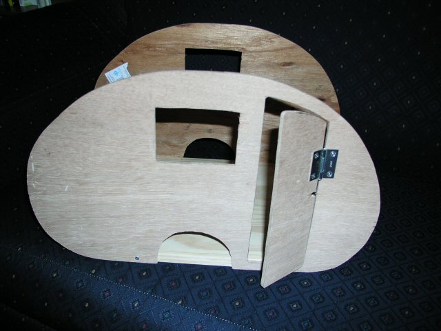

And here's what I can find that I did years ago...

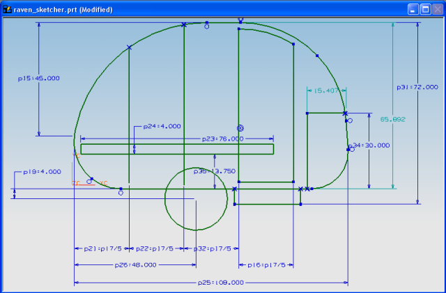

Postby mikeschn » Sat Jan 01, 2011 8:49 am
I had forgotten how small the Raven Argonette was... The average person can not stand in it...

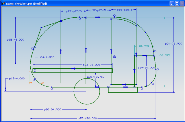

Postby mikeschn » Sat Jan 01, 2011 9:24 am
Stretching it out to 10 ft helps a lot...
Postby Steve_Cox » Sat Jan 01, 2011 3:55 pm
People were pretty short back then. 8)
The photo with the woman sitting by the trailer really gives perspective to how small that trailer was :o

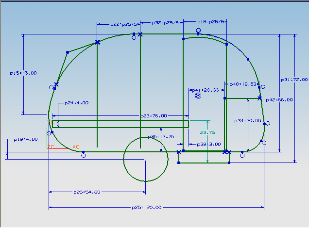

Postby mikeschn » Sat Jan 01, 2011 4:56 pm
Steve_Cox wrote:People were pretty short back then. 8)
Yep on the short... :duh:
The tab has a 69" headroom. So I guess a Raven Argonette with 69" headroom would be fairly Americanized!!!
Postby Steve_Cox » Sat Jan 01, 2011 5:21 pm
With Model A 19" wheels, torsion 1/2 axles with 10 degree start angle and a dropped floor leaving 8" of road clearance there could be lottsa (I wonder how much?) head room, and still fit under a standard 7' garage door.
