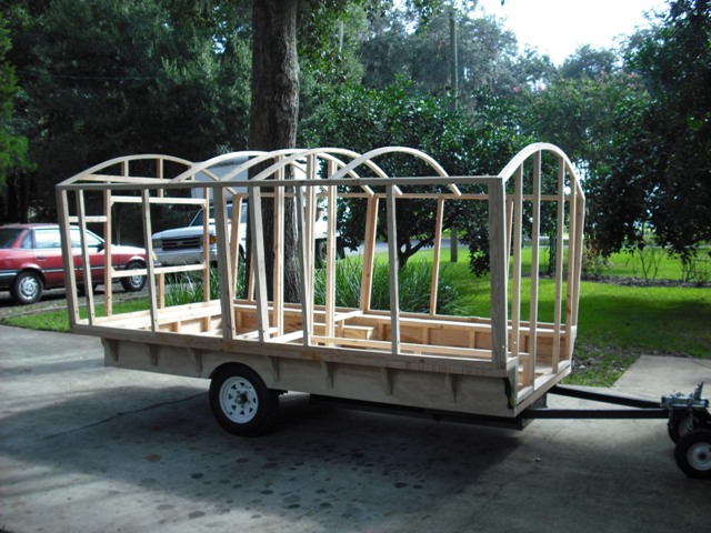

I like your plan. I built my gypsy trailer on a Harbor Freight trailer. Stretched it to 4 X 10. The gypsy was 64" wide over the frame, and could have been a wider. Here's a couple of photos to see how the wheels looked under it. Gypsy trailer weight is 1425# on 12" tires.
HF frame stretched to 10 feet using kit cross members
wheel view with 64" deck over the wheels.
