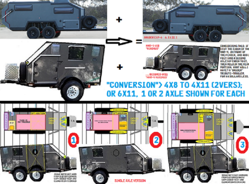

  • Coincidently, I've already planned a 2'x3' expansion of my 4'x8' squareback TTT, if I can find a 6'x12' cheap enough for me to utilize.
    blueprint for HHR-V MAXIMUS v3 3l x 2w (extra space on 6x12 frame).jpg (183.53 KiB) Viewed 7374 times
    planned for, but not likely to get to build expansion

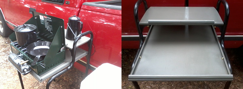

  • I would transfer everything I have now on my 4'x8', and make it a 6'x 11' (the extra 12" would be at the rear, to have a built-in workspace for my cooking). At this time, after arriving at camp, I must assemble a cooking area away from the galley -used as storage only, now, for lack of space-; the extra 12" would give me room enough for a cookstand there (I already have built one).
    knock-down cooking stand.png (431.33 KiB) Viewed 7374 times
    currently used beside trailer, anchored thru eyebolts on frame

  • I like my trailer's appearance basically as-is, and I think its' elongation, and widening would add to it, looking longer-lower (apparently only, at 85% of the "golden ratio")-wider. It could be single axle, using my current trailers 3500 lb Dexter axle, or tandem axle, maybe with two 2000 lb braked axles, my braked Dexter and a non braked 3500 lb idler axle, or with both 3500 lb axles having brakes. I've done other variations on this theme:
    Bruder-inspired variations of the HHR-v.png (696.45 KiB) Viewed 7374 times
    different variants with different looks
  • Since my trailer cabin is bolted and screwed to the frame, I would have to grind off the fasteners from below the floor, cut the trailer cabin just behind the front door, lift and transfer the front portion directly onto the new frame (should be do-able by for four people). The disconnected rear portion would be slid off the 4x8 trailer rearward, onto hydraulic jackstands (with 2"x 2" angle iron resting on top of the saddles). After the 2'x3' extension is already added to the forward piece, then the new trailer will be backed up, to accept the rear original structure. Any discrepancies in matching up the walls, roof and floor will be addressed at that time, but shouldn't be impossible to do. Tonguebox will be moved separately, and spare wheel can remain where it is now (but also removed, and reattached later).

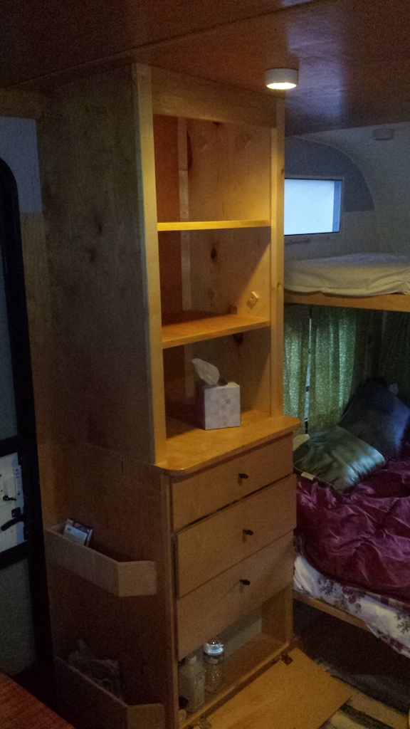

I have a 14' camper, hitch to bumper, maybe narrower than yours, but I had just enough space to build a wardrobe between the bed and the entry door. It is more like 24"w x 18"d. It has 3 open shelves in the upper part and 3 drawers and one narrow hatch door at the wheel well at the bottom.
The shelves are where me (or all 3 wife and son) put our clothes bags and odds and ends. Floor space is at a premium and it's good to keep that free. Plenty of stuff lands on the bed and bunk of course and then there are pegs to hang things on anywhere it works.
The drawers are used for things like batteries/flashlights/misc, the bigger ones for blankets, towels, first-aid and such.
Here's a picture, the little hatch at the bottom is open. Since the wheel well is there it is only a 4" deep or so, so that's where I put extra drinks until they go into the cooler, it holds a little fire extinguisher and glow-sticks.
camper wardrobe.jpg (251.91 KiB) Viewed 6660 times
