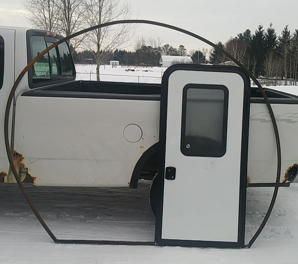

Hi, I'm building a canned ham from scratch. I bought an RV door with screen door from a surplus supplier and it is 72 inches tall, which is about 10-12 inches taller than what would be ideal for my side profile that I have already built. I am planning to remove the excess height from the bottom of the door.
Has anyone here shortened one of these?
Where my problem lies is that I bought a wider axle to have my tires outboard of the frame for the sake of stability, but my floor is 65 inches long & I would like to have some balance to the looks of it as well as having acceptable tongue weight. As it stands with the current height door, I will have to have the axle placed at the extreme rear of the frame rails and clearing the fender with the door is going to be an issue.
I am also planning to skin over the fiberglass door with polished aluminum diamond plate as well, but if anyone has prior experience in shortening a door I am very interested to hear what you have to say about it.

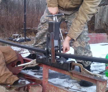

Hi, yes, well I am shooting for as lightweight of standy as I can. My build journal is "Central Michigan Canned Ham". My tow vehicle is a Kia Soul with the 1.6 liter and 6-speed manual trans. My egg shape I ended up with for a side profile was strongly influenced by my crude homemade tubing roller actually breaking in the process of rolling the arc. I had built it from steel I had taken from the scrap metal dumpster at the shop where I work. I figured why dump money into buying a tubing roller and the correct dies when, quite likely, I would never use it again. I had never used a tubing roller before and all I knew of them was what I had read online. My original idea was an 8 foot diameter circular segment 6.5 feet tall with a chord length of 6.25 feet, so my floor ended up being 10 inches shorter than originally planned, but I'm ok with the end result. Basically I achieved what I was trying to do, but it wound up more egg-shaped than my original plan.

Here is my homemade tubing roller built from scrap metal. I didn't use any bearings so there was a lot of metal-to-metal friction, especially in the drive roller, which is what ultimately broke. If I ever feel the need to use it again I'll make another drive roller.

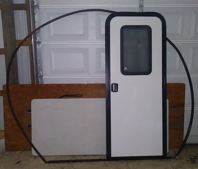

Here's a pic of door once it was cut down to 60 inches high. It will allow for getting the axle placement as best I can to get my tongue weight in the 15-20% range.

Postby Woodbutcher » Sat Feb 23, 2019 9:36 am
Well done! You are on the way to a nice trailer. :applause:
