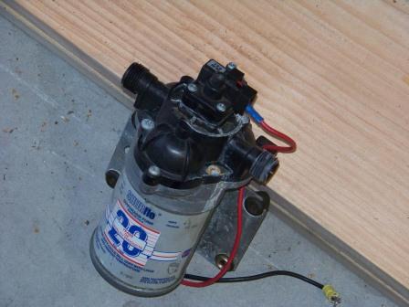

Hi,
My water pump is leaking at the discolored area at the top of the picture. Is it possible to rebuild these or is it possible to repair?

There are a couple on EBay:
http://www.ebay.com/sch/i.html?_nkw=shu ... repair+kit
Here is another site:
http://jfoakes.com/shurflo_replacement_ ... d_kits.htm
I'm sure there are more. Just Google Shurflo repair kits or call the factory. I've fixed several of em and they're pretty easy to fix.
