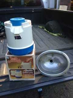

I picked up this little stainless bathroom sink for my trailer for $5.00. It's small, but I just plan on putting a blue water jug above it and use it for washing hands/brushing teeth. It will just drain into a bucket. For washing dishes I use a couple of pink hospital tubs.
