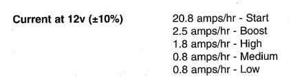

I know you've already picked a heater but just a clarification for the next guy; my Espar diesel heater draws 20 amps for 30 seconds while starting or 0.16 amp-hrs. After that, the current draw is probably less than the Suburban as mine throttles back to low at night. And I guarantee its a lot quieter than the Suburban.
It does have a diesel stink, but I have a diesel truck so it doesn't bother me. I don't ever smell it inside, there's something wrong if you do.

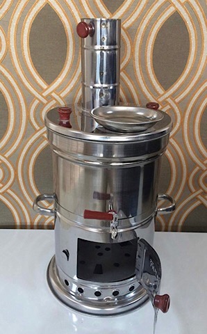

bobhenry wrote:Back to basics......
Bob,
First, I want to thank you for all the great input you have had and have now on this forum. I just finished reading the Caboose thread, an epic. You are a tough dude for sure. Thank you again.
So, with your pic in mind, this would work. The Samovar... they are thin stainless steel, available from Amazon among other places for 50 to 100 bucks. They generally heat a gallon of water. So, a small wood fired stove, WITH water heater (which I am sure will moderate the affects of the fire on the whole contraption. I’m tempted to buy one for my little trailer I am building. They are about 10” in diameter, so they could be easily installed in a box like you showed, or in my case, sit on top of a shelf that is in the plan for my one-man rig.

Postby bobhenry » Sat Nov 30, 2019 5:14 am
I am sure you noticed the entire unit is simply clamped in place. This was done for quick ejection if needed. The clamp on neich was lined with galvanized roofing material to separate combustable surfaces from the direct radiant heat and to help diffuse it as well. I would strongly suggest this as a mounting as it avoided cutting a chimney exit into the roof of the teardrop. I was amazed that this little 14" stove heated the unit in minutes with an outside temp in the teen's and a rather biting wind. I used salesman sample double sash aluminum storm windows in this build. This allowed the sashes to be quickly and easily removed and stored away after arrival. This feature allowed the neich to be temporarily added to the trailer.
