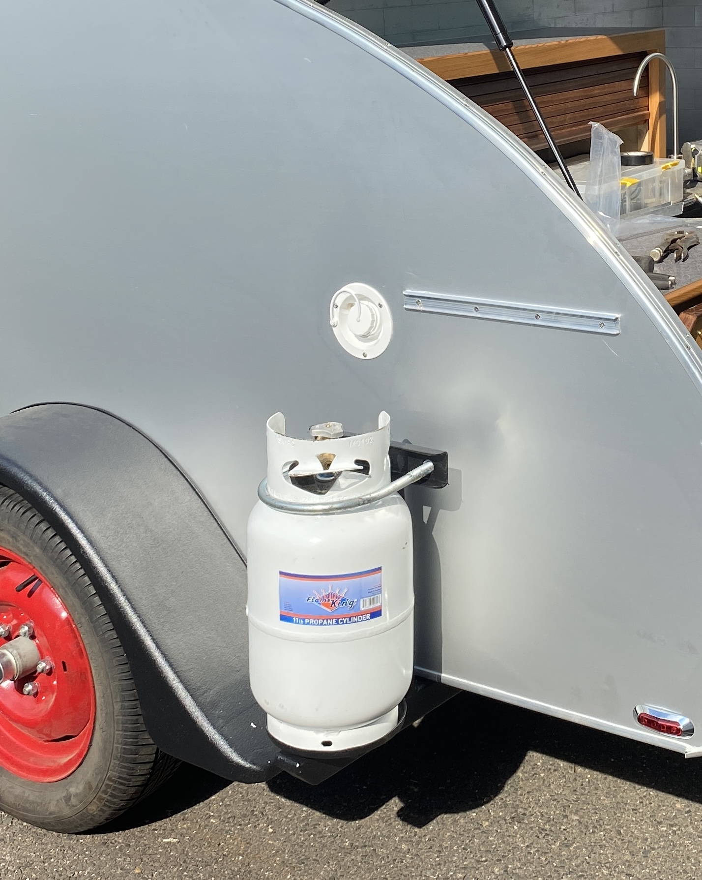

Postby wysedav » Sun Feb 27, 2022 8:25 am
This is mine, I had the unbolt laying around. I used an opt lawnmower tire rim cut in had for the base and som scrap 2x2 fro the structure. Got about 20k miles on it now, with no issues.

Postby wysedav » Sun Feb 27, 2022 8:42 am
Sorry not sure why the picture was cut off. It didn’t take long, was exactly what I needed, was basically free, and building a teardrop isn’t a race.

Postby tony.latham » Sun Feb 27, 2022 10:35 am
What do you guys think?
I like it. Did you add some padding or something between the bracket and the tank?

Postby TearDropDrippin » Sun Feb 27, 2022 12:08 pm
Yes I plan on like a heavy duty bike tire to help the vibration from marring the tank. As well as some blocks or something to help brace the bottom of the tank and a steel wire/chain as a fail safe back up.
