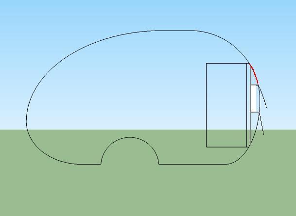

Hey Thomas! We must think alike because I was looking in to the same idea when I found your thread here. I had this idea after looking around at different water heaters. I found a similar unit to what you are looking at here. After reading up on that little unit I found that it can not be mounted in enclosed spaces and is really only suitable for out doors. My idea is to mount it on the out side of my camper in a compartment with a hatch. When I am using the camper I can leave the hatch open to allow plenty of air flow. Then run a line in to the camper with a valve. Valve position 1 would allow water in to the sink and position 2 would divert the water back out to an outdoor handheld shower. I have an idea to use the same vent on the roof (that I still need to figure out) that the refer is going to use.
Here is a little sketch I did with my plan. The white box is the tankless water heater. The large box is the refer. The grey lines are sheet metal to keep fire safety. The tankless water heater would have a nice big hatch and below that a hatch with louvers to access the back of the refer and vent it. The big question is the roof vent (in red) I can't figure out a good vent system that will ride the curve and still keep the water out even more a worry when driving in the rain.

My whole concern was that I wanted an indoor shower and was worried that an outdoor tankless water heater meant outdoor shower, that wasn't true which allowed me to consider the outdoor mounted ones. The units themselves are meant to be mounted and stored outdoors so there is no need to cover or hide them except for aesthetics. I am just going to mount it outside and run the lines through the wall and be done with it. You can always paint the unit to match the camper too. If you are going to do an outdoor shower, why worry about mounting the water heater inside? Bolt it to the tongue and roll on!

Like you said aesthetics. I am going to have 4 T105's and a propane tank in some sort of box on the tongue. The heater will be essentially outside just recessed in a compartment that has a hatch to cover it and hide it. When in use the hatch will be open. The main reason I am aiming to place it here is due to the curve in my design the flat fridge eats up a chunk of space behind it. Due to the need for venting the fridge this space is left to exterior access only. It kinda just fits together in my design. Cheers :beer:
