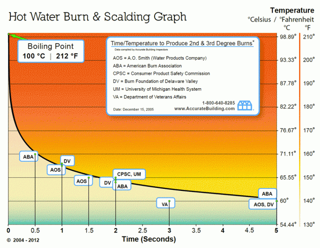

Postby bdosborn » Sat Jan 31, 2015 9:35 pm
I wouldn't go over 130F as you still want to be able to use the hot water without worrying about getting scalded:

Postby lrrowe » Sat Jan 31, 2015 10:29 pm
Point noted Bruce.
And adding an anti scalding valve for other water usage would just add to the complexity of the system.
