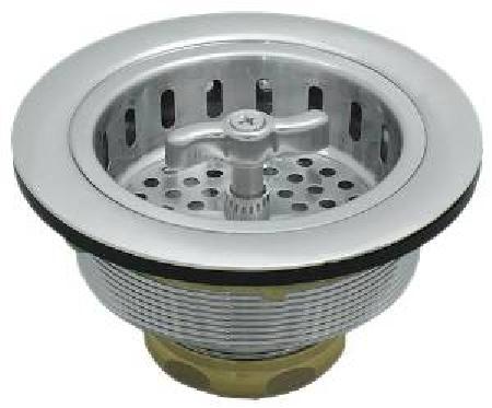

Postby fm-usa » Fri Feb 26, 2016 8:58 pm
flboy wrote:I asked the question here:
viewtopic.php?f=54&t=65497 .
Maybe I should have asked it on this thread. I did a search on the forum for "trapless" and didn't see anything.
Any comments on the question? Thanks.
IF it were me I'd be looking at initial cost, replacement ease, simple near unbreakable design, EZ cleaning, parts found anywhere. NO rubber parts to replace, all metal to metal seal.
Drain directly to holding tank using no trap.
IF i remember it's about 3 inches from lowest connection to finish surface. Problem there is tightening the 1-1/2" nut.
No problem if the drain pipe goes into the side of the tank.
ALWAYS trade-offs.
MAYBE this kitchen drain?

Re: a new one
Postby flboy » Fri Feb 26, 2016 9:02 pm
That is an idea! I'd have to open each time I took a shower, but that would stop anything from bubbling up when not in use.

Re: a new one
Postby fm-usa » Fri Feb 26, 2016 9:36 pm
flboy wrote:That is an idea! I'd have to open each time I took a shower, but that would stop anything from bubbling up when not in use.
I added some new info in the original post.
Problem with a P-TRAP is while traveling the water in the trap sloshes around and usually down thereby loosing that seal.
El-Stinko :?
