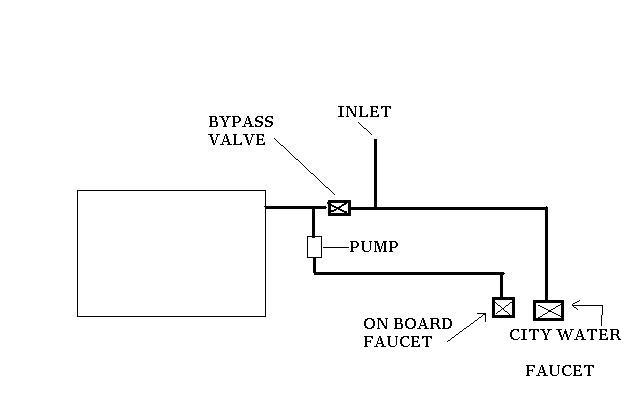

Postby Larwyn » Fri Apr 29, 2011 12:40 pm
dh wrote:
Larwyn wrote:RV water pumps usually have a built in check valve on the pressure side to prevent back flow into the fresh water tank. When you see a large puddle under an RV it is often due to failure of this check valve which allows city water to over flow the tank. There is also a check valve built in to the city water connection which prevents water escaping at that point when using the on board water system.
On my 5th wheel, I installed a ball valve to bypass the pump so I cold fill the fresh water tank from the city water connection. I just had to remember to close the valve once the tank was filled. This saved a lot of hassle since the city water connection was on the back of the trailer and the fresh water fill was located on the front. :thumbsup:
Larwyn, could you post a diagram, I like the idea of filling from the city water connection.
It's really simple. Just tap the water line on the pressure side of the pump/check valve with a pipe T, repeat on the low pressure/tank side with another pipe T, then install a valve between the two T's, with a bit of pipe. It simply bypasses the pump and thus the internal check valve. If you use an external check valve then you will need to be sure that you include it when you bypass the pump. If you open the valve when connected to the city water supply the tank will fill through what is normally the tank's outlet to the pump. This valve should only be open when you wish to fill the tank.

Postby bobhenry » Fri Apr 29, 2011 1:14 pm
If I am understanding correctly.......

Postby Larwyn » Fri Apr 29, 2011 7:36 pm
bobhenry wrote:If I am understanding correctly.......
That's purty much it only the two faucets are combined to one supply to all cold water faucets and the input side of the water heater in the version that I did on the 5'er.........
