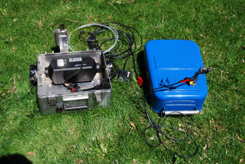

I did not know quite where to put this and it is getting past the need to use, but here is the finished, almost project of setting up an Espar heater to use with our teardrop. It does use diesel but prefers kerosene (burns cleaner).
The package
The fuel tank has the fuel pump attached, it will go inside the case.
What is inside
The wiring harness is over long but I will not be trimming it till I can fit it and try in out with CR (Compass Rose).

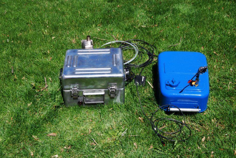

With ducts attached

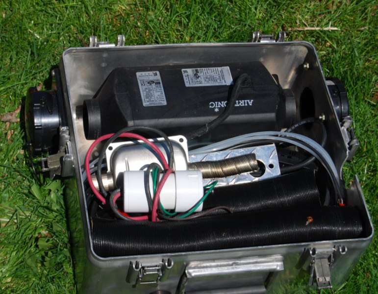

It all fits inside, mostly except for the ducts. The white thing is a pump primer made with a blinker relay and switch. The Espar pump is metering pump and since I have a long fuel line that is removed the heater wants to time out if it does not see fuel with in a specified time. This lets me know that I am getting fuel to the furnace (fuel line is translucent).

The case is an aluminum surplus night vision goggle container which came in olive drab and that I stripped and polished. The Espar heater is the current D2 version and is available.
The reason I wanted it portable is that I can leave it home, and it helps to heat the garage. I do not have room in the tear. One other reason is this will be much more quiet, the reason for the muffler is that these things sound vaguely like a jet engine when starting up and having everything external and self contained reduces noise.
I have 4" deck plates in the side of the teardrop and these accommodate the AC unit and with reducer the heater. Note that the connector is a 3" sewer hose connection but the orange duct is high temp. The output from the heater is about 300 degrees F on high.
