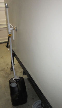

Postby S. Heisley » Sun Feb 10, 2013 10:50 pm
If you can add a vent out the side when you are building, it would be a good idea. There are some drains that have a built-in vent but the new ones don't work all that great. You could use a PVC elbow and PVC pipe and it wouldn't have to stick out very far. I would suggest threading water tubing inside a single piece of PVC pipe in your wall and only put your connections at the top and bottom of your wall, to direct the remainder of the vent to where it is needed. By doing that, the pipe protects the hose and, if you have a leak or water backs up in the hose vent, the PVC pipe will protect your wall. Extend the hose slightly out the side and make any needed connections there. I would, however, recommend some sort of screen or vent cover over the top of the hole, to keep things out of your tank while still allowing it to breathe. Gray water is not so bad but for black water, I would definitely put the vent as high as you can!
My original $13 gray water drain had a built-in vent at the elbow/P-trap and worked fairly well but the new one that I had to buy doesn't work well at all. I didn't want any new holes in the side of my already-built trailer; so, I built a removable vent. It's less than a foot long and works perfectly so far. It uses 1/2" PVC pipe, a few pieces of a hose, a couple hose fittings, and dishwasher hose debris catch. The hose is glued into the PVC parts with PVC glue and the hose fittings are clamped on. It just screws in place. Since the pipe is only 1/2" wide, even if it rains, I won't get much rain inside the PVC tube. I chose to use a simple black oil canister for a gray water tank, which I plan to dump before bed each night. That keeps everything simple and will help keep critters out of it, while keeping the possibility of leakage to a minimum. I had a nice set-up with a folding clear tank; however, the color of the camp water shows through that. At the last IRG, someone saw the clear tank and asked me if that was "potty water". (IRG's water was a muddy brown color.) :lol:
This is probably more than you want to know, and your build will probably be much more sophisticated; but, it gives you some additional ideas to work with while looking for the right solution for your trailer.
Sorry that I don't have a better picture; but, this gives you the basic idea of what I've done:
