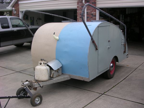

I've got a thread under wanted/for sale because I'm looking to buy an old horizontal tank for my 1949 teardrop. I'm looking for a tank like the one on the attachment. I've gotten a lot of good comments from that thread which sparked this QUESTION :thinking: Is there anyone out there actively using and filling their horizontal tanks? Can they still be used? Does it require a special valve to use it???????
