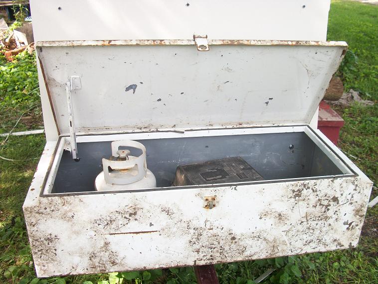

I have the next size up a 7 or 8 pounder and chose to mount it in the tongue box. It is hard plumbed with iron pipe and only a very short connecting hose. There is a vent grate in the floor of the box and a puck that fits the bottom chime so it can not walk when the lid is shut.
Here is the tongue box before it was cleaned and painted
Here is a pic with the tank just tossed it in to try for size

Postby vaddisonme » Wed Jan 23, 2013 9:53 am
And the lid doesn't hit the top part when you close it?
The Marshmallow pulling our Sweet Potato.
vaddisonme
Posts: 97
Joined: Sat Jul 21, 2012 11:34 am
Re: Transport propane
Postby bobhenry » Wed Jan 23, 2013 1:26 pm
I just got dumb lucky they just touch !

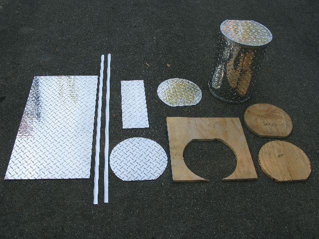

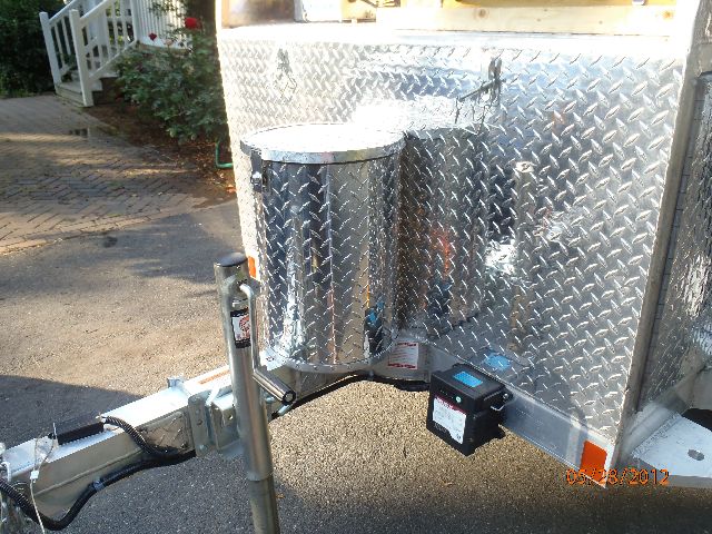

I made propane lockers for both of our 10 lb tanks,they are lockable to keep the tanks from "walking off". There is one on the rear running board for the stove, and the other on the tongue to use with the shower unit.
Components used to make the lockers.All from local big box store.
These could be scaled down easily and made with less expensive materials if desired.
Anyway, just one of many options,
