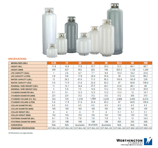

Steel tanks usually have a tare weigh of about 18 pounds (typical 5 gallon tank).... The tare weight is usually stamped on tank safety collar.... Look for Tare XX.X or t xx.x or something like that...
According to PDF file found at Worthington Cylinder a 11 pound tank holds about 2.6 gallons of LPG and has a "nominal" tare weight of 13.1 lbs... And the propane should weigh about 10.6 pounds...
http://www.worthingtoncylinders.com/tec ... table.aspx
Once you know tare weight, you can subtract that from total weight of tank and it tell you pretty close what you have in gallons of fuel....
