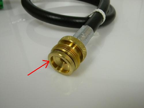

So I spent some time with my dial caliper depth gauge and decided that the center post of the appliances are just about 0.05" too short to open the valve in the hose (the part that emulates a 1 lb can). I realized that I could fix the problem by removing a corresponding amount from the mounting flange on the hose connector. I ground it down with an angle grinder and finished up with a stone in the Dremel tool and it all works fine now.
I still don't know why the problem exists. The appliances (stove and lantern) are both about 10 years old, so perhaps the spec changed, or they were worn, or...? But I figured that I had nothing to lose since I lost the receipt for the hose :( and couldn't return it.
The problem seems fairly common, I med a guy at the DAM Gathering who was having the same problem. He solved his by tightening down the appliance end connector really tight. And last year at Lopez Lake the guy next to me had the same problem.

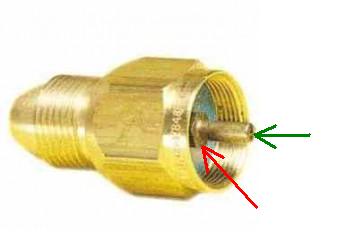

You are talking about removing material on rim of 1/20 inch male end of #1 canister adapter are you not?...
One has to be fairly accurate doing this fix, because it is a sealing surface for seal/gasket of fitting that fits one #1 canister... Screw up on angle or not getting it smooth will cause propane leak at this joint....
It also could be the center post (on #1 pound fitting) that pushes on the schrade valve is too short (green arrow) and a very thin washer under center post (red arrow) could do same fix....
Dale

Dale, that's exactly the surface I ground down. And yes, I checked it carefully for leaks (with soapy water). I could not get the center pin loose - that was my first idea for a fix.
I will continue to check the fitting for leaks whenever I connect just for safety, but I'm pretty confident that I got it right enough.
