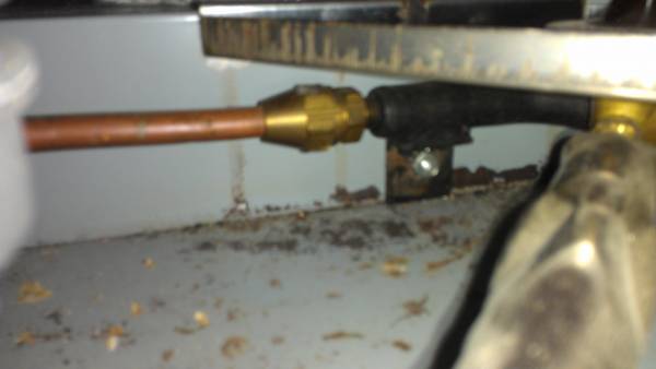

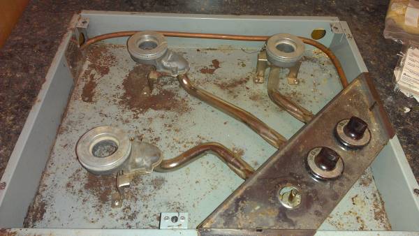

Now that we're pretty much done with most of the heavy lifting on the build I figured I would get the propane bottle filled up and test out the sweet stove I saved from the original '72 Starcraft. When I hooked it all up, much to my dismay, no propane came out. I have some pics below if that helps. When I tighten the regulator all the way and turn on the tank, I hear no sound and smell no propane. Then when I walk back to the stove and turn on all 3 burners, I also hear no sound nor smell any propane. The next step is to turn off the burners and walk back to the front of the camper. Then I slowly unscrew the regulator, with the tank on, and as the regulator gets about a quarter to half way unscrewed I hear a whoosh of propane and smell a little bit of propane, but that's it - very fleeting and it stops suddenly.
For the next test I unhooked the flex line from the stove, so now the propane bottle is hooked up to the regulator, which is hooked up to the 1 inch black pipe running under the camper, and no stove attached. Now, when I turn on the propane in these circumstances I also hear nothing and don't smell any propane (at the bottle and back at the open black pipe).
I believe we might have a faulty regulator, but if anyone has any suggestions or wisdom to offer I would be all ears.

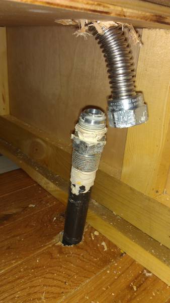

I'm also assuming that eventually I'll need to clean off the dried pipe dope from where I disconnected the flex line from the black pipe (see 2nd pic in OP), and reapply new pipe dope when I reconnect it.
Any suggestions on what to use to do that? Or do I just slap new pipe dope over it and reconnect it?

DudKC wrote:I'm also assuming that eventually I'll need to clean off the dried pipe dope from where I disconnected the flex line from the black pipe (see 2nd pic in OP), and reapply new pipe dope when I reconnect it.
You don't put ANY dope on the those threads. That is a parallel thread and a flare connection. The seal comes from the flare seat, not the threads as it does with the NPT threads.
Noted. Should I clean it off? Or just reconnect it?
Yes clean it off, and don't damage (scratch) the flare seats (male and female)
