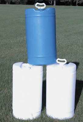

I picked up some 15 gallon carboys from a car wash that their soap came in.
I installed two of them on my 8 x 20 flatbed trailer under the floor for cleaning and bathing water.
There are two advantages, you have a built in reserve tank in case of a disasterious malfunction and you can balance the load. You have also reduced your weight to 225 pounds fully loaded. Are you really sure you need 55 gallons?
