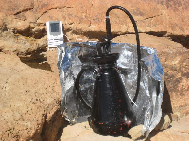

I painted a new/unused Garden Sprayer with some Black Paint I had around. You can see a few scuffs of the original Orange on the Sprayer.
With some 'Astrofoil' behind it acting as a Reflector, it heated up passively to make for a nice Shower after Lunch. Due to the fine Mist Spray coming out, the Water cooled in Air. So, I had to let it heat up higher than expected [~110 F Degrees]. As seen on the Radio Shack Indoor/Outdoor Thermometer in back, the Water was already ~70 F Degrees in the morning on a ~40 F Degree day. I got 2 'generous' Showers out of 1 fill.
The Garden Sprayer Plastic is a good ~1/4" thick, and withstood 'lots' of Hand-pumped pressure. Cost = free.
