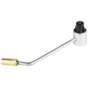

IF regulator that came with stove looks something like this.... Its a"high pressure" regulator...
I have heard tell
but can not confirm (have not time to do research as I write this) that output pressure is about 15 psi... Where the ubiquitous "pancake" style regulator normally on propane tanks and as Mt don has posted picture of outputs only about 1/3 PSI or about 13 IW (inches water) IW is measurements of pressure usually less then 1 psi...
Since light screws directly on canister I don have any idea what pressures it require or is internally regulated to but would venture to guess same regulator technology as camp stove..
Please don't shoot me if I am wrong...
