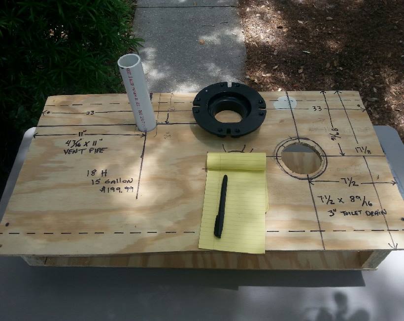

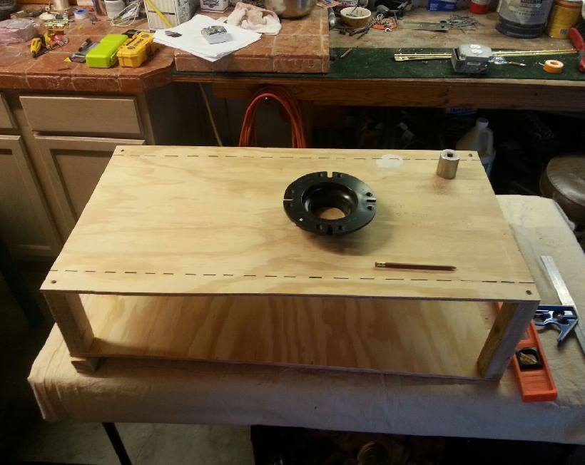

Postby Tommy B » Tue May 24, 2016 2:00 pm
Retched, I am in a similar situation. If you check out my thread there are pictures of what you are describing. I used a 3 inch valtera floor flange which required a 4 in hole I BELEIVE. Much has passed sense I cut that hole But I could confirm if need be. My tank will be here this Friday and I plan on mounting it sat if all goes well. The flange fits tight and flush and passes through that 3/4 inch plywood with much thread to spare to screw into your tank fitting. It is a male 3 inch valtera floor flange. I have no idea how I will mount the tank and there is no easy button.
Cargo conversion thread. 6x12 hallmark thread will have better pic. I don't have time right now good luck.

Re: RV tank and Toilet
Postby Tommy B » Tue May 24, 2016 2:01 pm
I have the dometic 310
Tommy B
Posts: 891
Joined: Sun May 08, 2016 4:37 am
Postby Tommy B » Tue May 24, 2016 3:04 pm
There you go retched.
